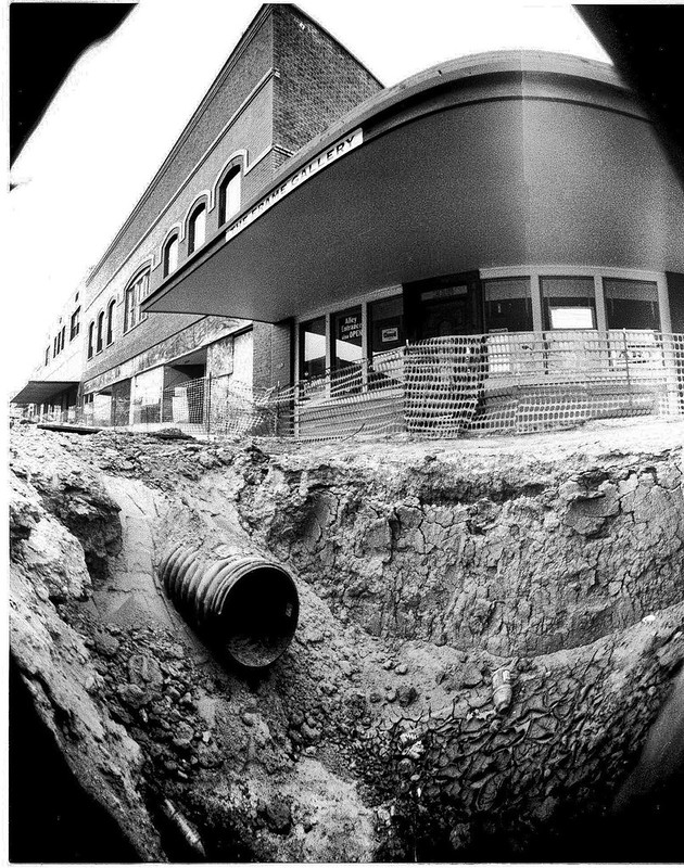

Film is my preferred pinhole medium. I have never tried paper.
Plus, since I no longer do wet printing, I have no access to photo paper. However, since I still shoot large format, I routinely keep a supply of 4x5 sheet film.
Pinhole Gallery by Narsuitus, on Flickr
