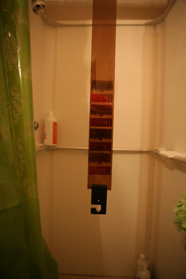

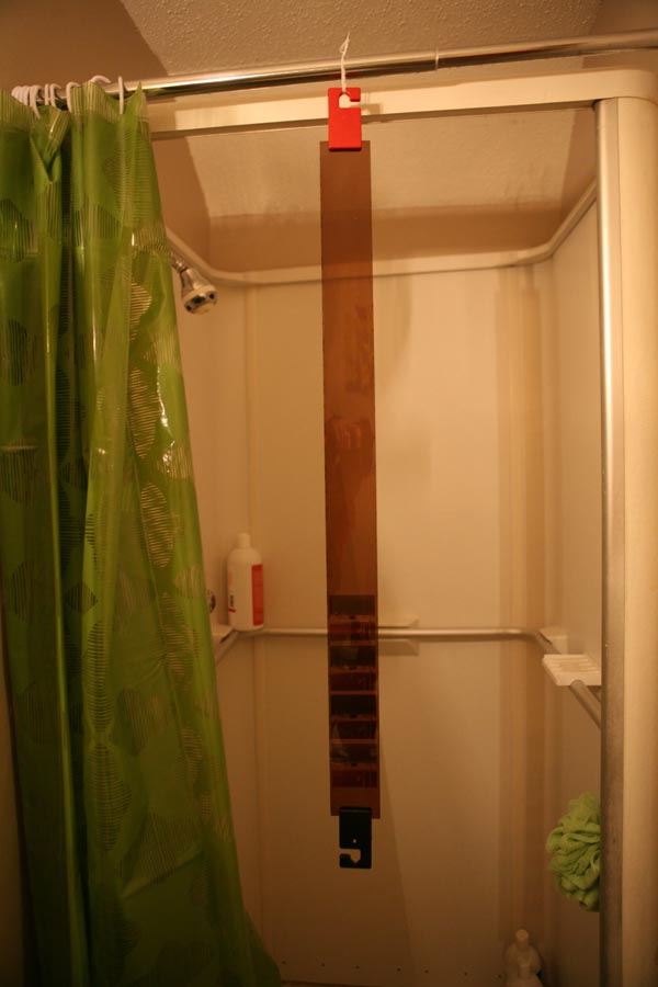

I purchased the Rollei Compard Digibase C41 chemistry to test out in my Jobo CPE-2 with a 1520 Unitank (takes one 120 reel). I would normally use a 1540 tank and knock out two reels, but the set of chemistry I bought was the smallest batch and made only 250 ml of chemicals per step. Thus, I was relegated to the smaller 1520 tank.
After developing at the proper times at 37.5 deg C I had two rolls of film turn out with only 4 images developed, and the other 8 on the roll completely blank. I'm not talking just faded, uneven development or striping, I mean seemingly untouched by developer. The 4 shots that did develop properly came out great, no irregularities.
Both times I ran the developer, the 4 shots that did come out were on the outermost track of the reel (AKA the section of the film you can see when you first remove the reel from the tank after developing). The rest of the film that cannot be seen in the inner tracks was totally undeveloped both times. Check the pictures I attached for one of 120 rolls, the other roll looks identical.
I am confident the issue is mechanical/physical with the tank, not an issue with the developer. I filled the tank to the correct capacity (it is listed for 240 ml and I used 250 ml on each step), so I don't believe it is a lack of chemicals. Also, the reel was only loaded with one 120 strip each time, so the film should have been easily submerged being as it was on the outermost portion of the reel.

OK, pardon me for asking an obvious question, but are the frame numbers on the film rebate edge showing properly throughout the length of the film? I cannot see them adequately in the pictures.
Aug 29, 2011
7
Yes they are. The successfully developed images are shots 1-4, the blank images are for 5-12.
Which, now that I consider it, means the film must have developed, and I have an issue further up the line, perhaps with my camera (yeesh_.
Thank you for considering that very important detail.
