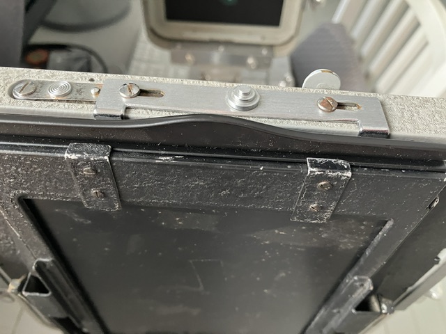

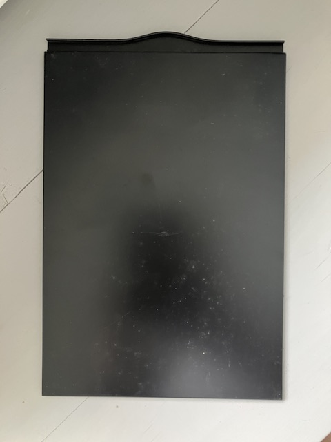

I am searching for a film holder for the Plaubel Peco Universal II 13x18cm camera.
The dimensions in the camera back is 10x145x200.
Are there any commercial available film holders that may fit this camera?

Thank you. I dont think the back is modified. The dimensions are measurements taken of the film holder ”slot” in the camera back. So, if the 13x18cm/5x7 film holder is bigger than that it will not fit in the camera back.
I can not find any external dimensions of film holders available on the market. Do you have 5x7 film holder for measurements?

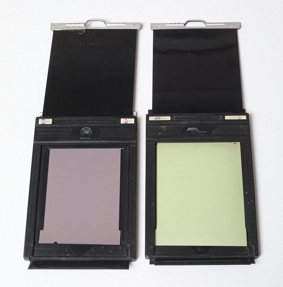

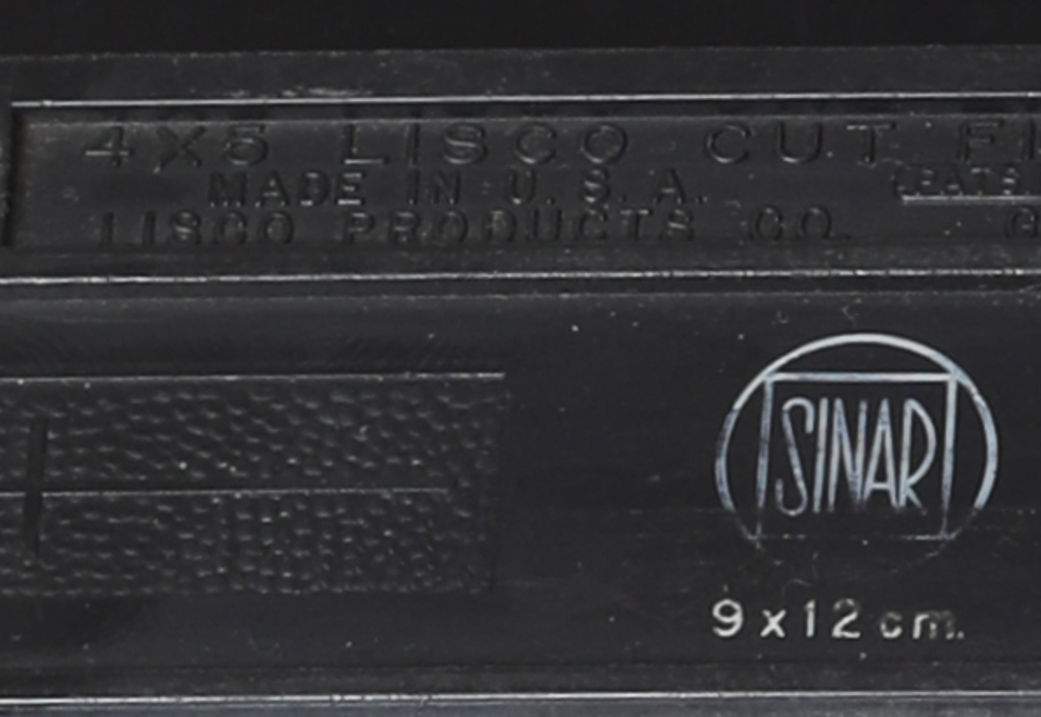

Modern International back fit 13x18cm, 7"x5", and half plate, holders are150mm in width. 210mm in length. Thickness can vary slightly.
Many plastic holders for 13x18 and half plate are labelled 5"x7" in the moulding, then painted with the internal film size, so you need to be careful as the paint can wear off.
These are 9x12cm and 5"x4" holders alongside each other.
Check those measurements,
Ian

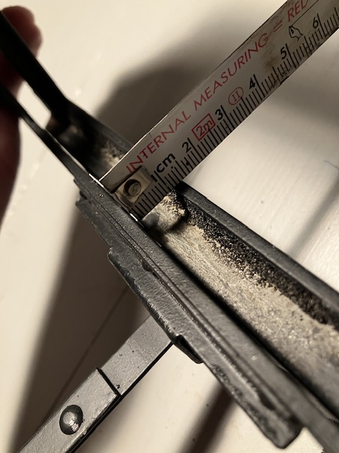

The thickness of film holder can not be greater than 10mm. I measure the depth of camera back ”slot”. It is 11mm including light seal(now deteriorated though).

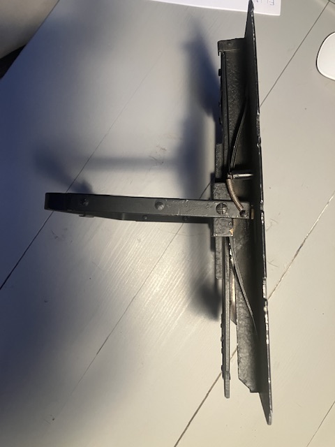

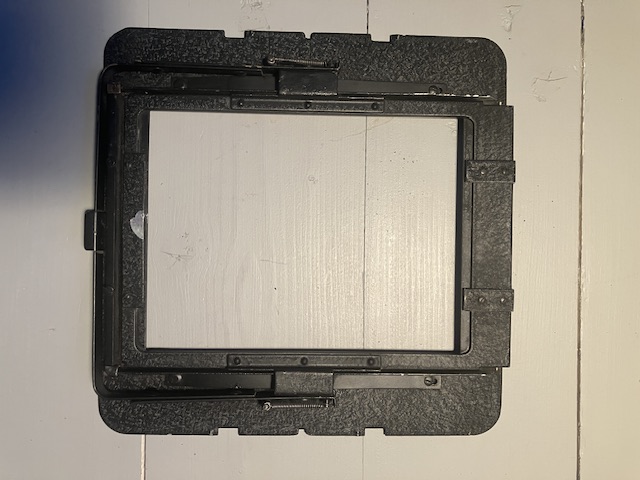

I got some Rada ”Millionfalz” film holders.
