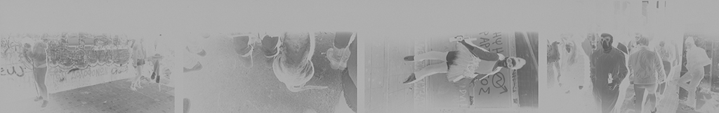

Hello,
For the first time, I used flashgun handheld while photographing in the streets like Bruce Gilden. When I developed a couple of b&w films (Kentmere 400), I noticed that the upper side of several frames was quite dark or not flashed. Pls, check the attached file. The phenomenon isn’t only obvious in frames in a row, but also in single ones.
Gear used: Zeiss Ikon ZM, Voigtlander 28mm lens, Metz 44 AF-3N Mecablitz connected to the camera by a remote flash cord. I had set the flashgun to manual mode and 85mm zoom due to the general short distance. Despite the fact that the Ikon ZM’s sync speed is 1/125, I used several times 1/250. Though I don’t remember if I used 1/250 in any of these spoiled frames. However, the flashgun flashed as usual.
Do you think that this happened due to bad synchronization of the flash with the camera’s curtain? namely should I stick to the camera’s sync speed?
Any other idea for this malfunction?
Thanx in advance!

You really need to stick to the synch speed, or slower. I'd bet that the bad frames were from when you shot at 1/250 sec.
Yes, it appears your camera is not synchronizing with your flashgun. Stick to 1/125th of a second for flashes.

If the camera has a focal plane shutter and it seems to from your description then the shutter speed max is the sync speed. Any speed above this will result in what I think you are describing as one of the curtains is closing but there is no light left from the gun i.e. above a certain shutter speed the two curtains move across the frame in the form of a slit. When it is daylight this is fine as there is always light present but at night or even in dusk conditions there isn't any light or not enough for the scene to properly register through the moving slit

You got a shutter with a horizontal slit, running upwards. When the 1st section reached the top and released the flashlight meanwhile the 2nd section had started and already covered 1/3 of the frame height.
The exposure time you chose was too short.

It appears you have two problems. When the camera manual says that the strobe sync is a certain shutter speed or lower, they are not just flapping their lips, so to speak. You need to pay attention to this. Also, you have set your strobe to cover what an 85mm lens would cover but you are shooting with a 28mm lens. As we used to say, you are cruising for a bruising. Your logic is flawed when you say you set the strobe at 85mm due to the short distances. This has nothing to do with distance, it has to do with how wide an area the flash will cover.

But as the example above shows, a too short exposure time could be used deliberately. To avoid blur from remaining continous lighting on the price of cropping, so to say.
