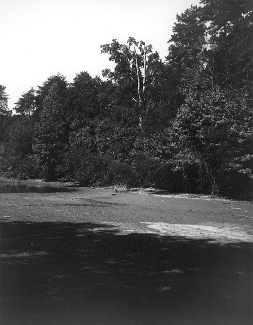

I don't have any of the 35 mm Tri-X that was intentionally shot at this EI scanned -- it was all constellation images, 20 second exposures hoping to get more sky depth than would be the case at EI 400 -- but I do have a scan of the original, first TXT negative I did with this super soup. This was accidentally loaded backward in the film sheath, so exposed through the antihalation layer on the base side, which gives a working EI of about 16-25, but still metered at EI 320; after the above process, it prints with normal to slightly hard filtering (that is, the negative has about normal contrast).
The attached is scanned from the print, but the negative scan is very similar.
