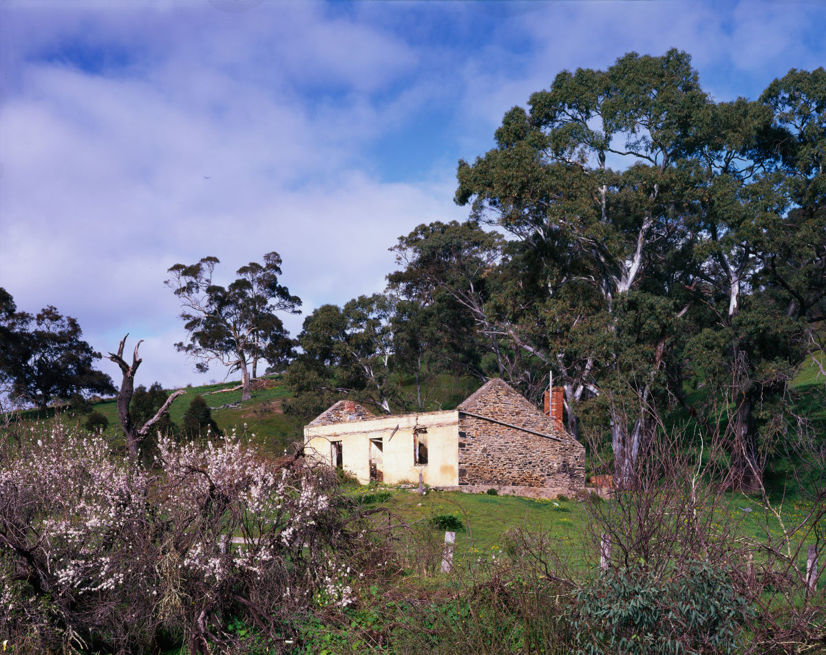

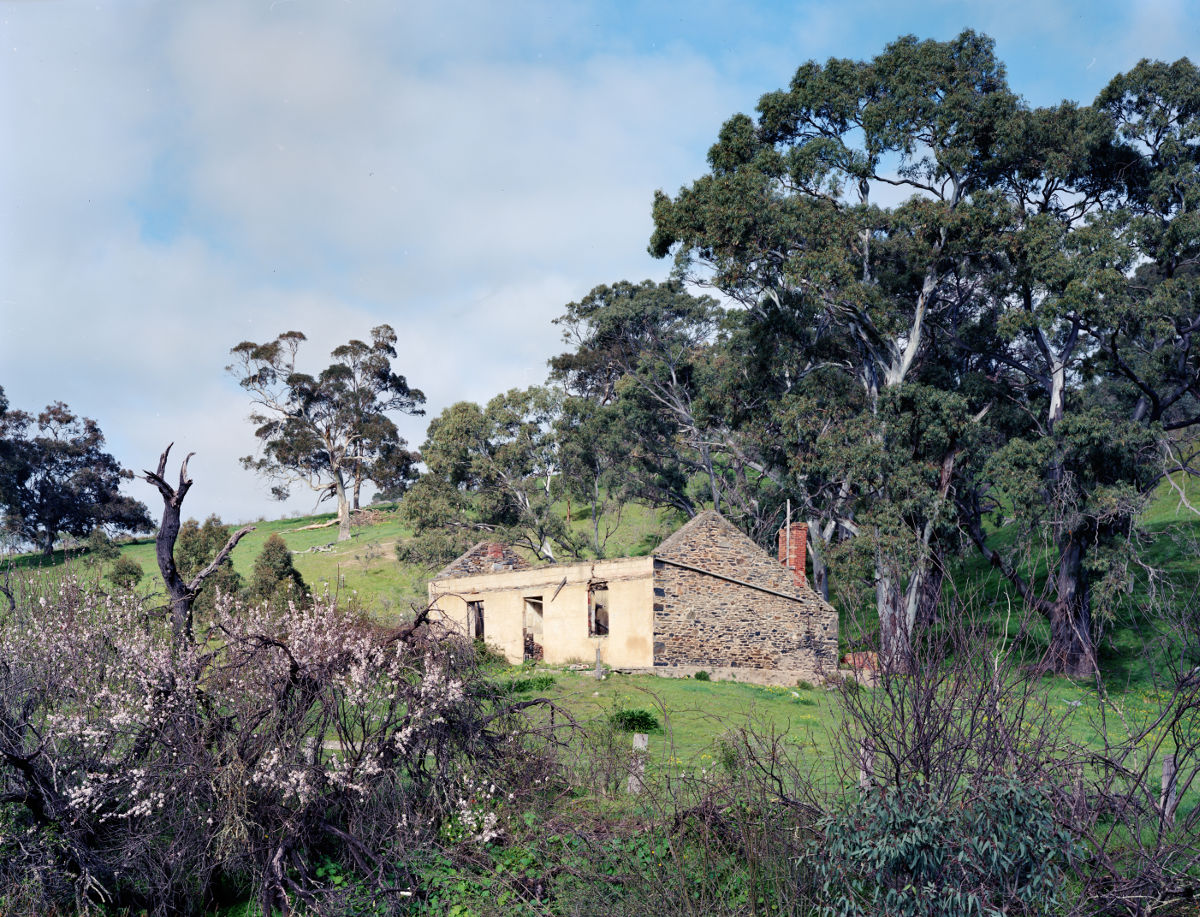

Dr Croubie
Mar 21, 2013
1,986
rAdelaide
Horses for courses, of course of course.
Here's a shot that I took with both Ektar and Velvia 50, you can easily tell them apart.
attachment.php
attachment.php
Both 4x5", Fujinon SWD 90mm, less than a minute apart, just change the shutter speed one stop and shoot again. Probably had an 81A because it's almost glued to that lens, and pretty sure no polariser.
The Ektar is slightly cropped because I got it done in a Dip'n'dunk lab and that puts holes in the corners of the film.
The Velvia is slightly magenta in the clouds, but that's because it expired in 2003. I could correct it after scanning but I kinda like it the way it is (it looks fine on its own, but really shows up side-by-side).
The thing about Ektar is that it just doesn't get that deep blue sky that you get with Velvia, they're always more cyan, polarisers can help bring out a deeper sky but it'll never be as blue as Velvia.
The greens are also different, Velvia is a lot darker and deeper. Reality was probably halway in between these two renderings.

cyron123
May 10, 2014
19
Ahhh. The blue I'd totally different. Looks like polarizer and not... I like the colors of the velvia. What scanner have you used?
