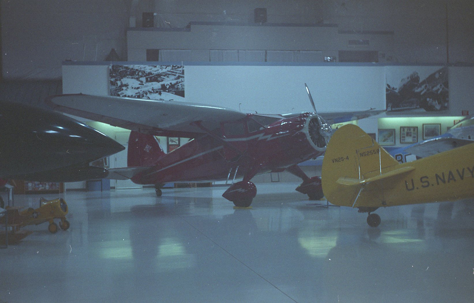

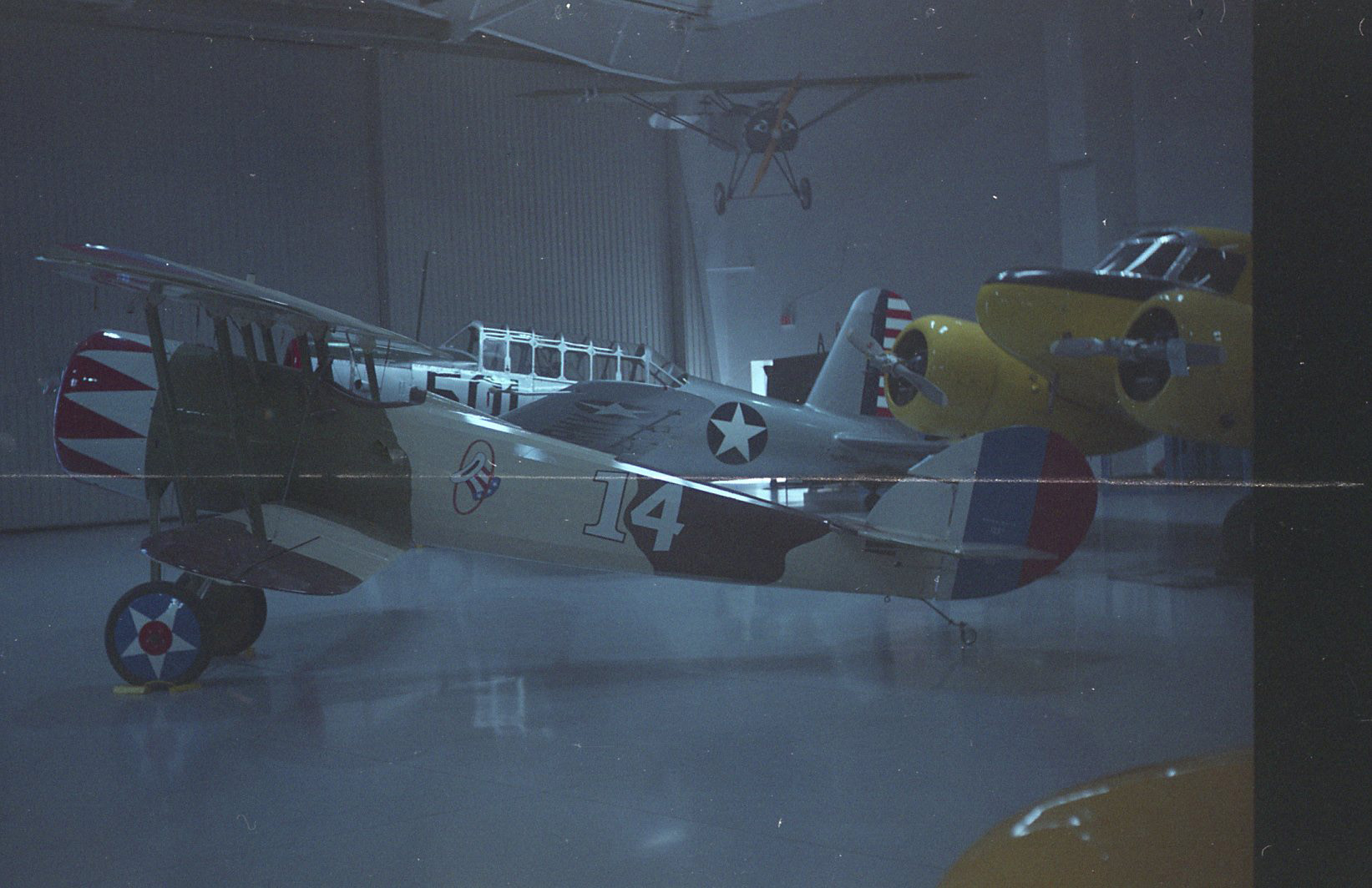

Original poster here. I'll supply several photos. Perhaps it was the processor. The areas that are outside of the frame of the photo are cloudy, indicating that all of the film was exposed to some sort of light. I do not see anything that would show a sinusoidal application of light. I do see what looks like a scratch in the middle of some of the photos, as well as bending of the film, like it was forced into a small space & it folded up. What say you? Thanks for the ideas & suggestions.
winger
Jan 13, 2005
3,975
southwest PA
How old was the film? I don't remember seeing that in your post. Speed? If the dust is still on the frames that's showing in the scans, then I wouldn't use that lab again. But mishandling it and bending it won't cause fog. Age, high temps, especially if high speed all will.
Nuff
Feb 16, 2013
581
Tokyo, Japan
Hmmm... I would also get the camera checked as well, it could be a light leak. Since the scratch is only one one frame and not all of them, I suspect it was mishandling by the lab that you took it to.
StoneNYC
Aug 5, 2012
8,345
Antarctica
8x10 Format
Looks like under exposure or contaminated chemistry or both to me... Were all the frames like that? Compare the negatives to a properly exposed negative, is the image STRONG or is it very thin and faint?
trythis
Sep 26, 2013
1,208
St Louis
Was all the film processed the same day as the other rolls not in the camera when you went through security?
That looks like old cheap film, bad scans and/or bad developing.
[emoji22]
I watched Walgreens film technician stropping my film between her fingers like they were having fun with a ribbon. I asked her to stop and she looked at me like I was crazy .
The second time I went to a Walgreens I watched the technician drag my film across the floor from the developer to the scanner.
