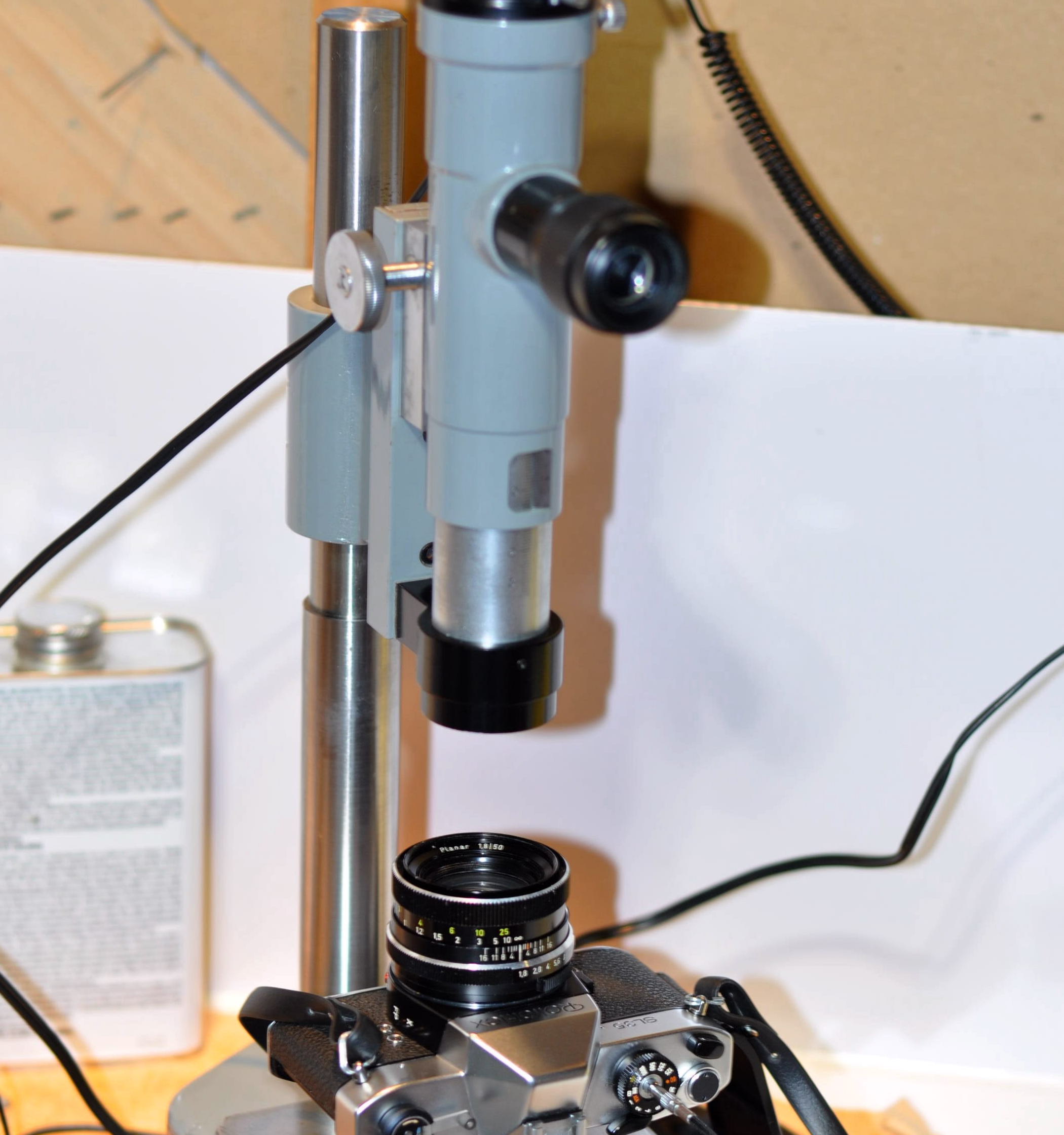

I just got a camera with 1/2 roll of expired film. I removed the film from the camera and put it in a Rolleiflex SL35 to test frame-by-frame flim flatness.
This Rolleiflex SL35 was set to focus 0.15mm in front of the pressure plate.
With in mind, I used an Autocollimator to measure the front surface of the film on each frame from 1 to 24 and recorded the deviation from 0.15mm.

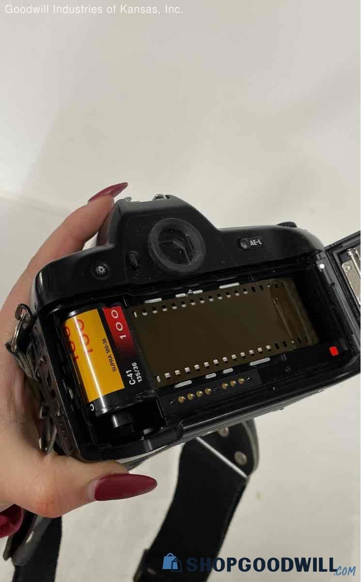

The Nikon N90S I just acquired was shown in the ad with the back open and half a roll of film exposed. Since the camera had been sitting some time with the film that way, I thought that roll would be good for this test. So, I did remove the film from the N90S and re-loaded it into the SL35 test camera. The film did have an obvious curl to it. It was sitting at about the 10th exposure in the N90S.
After loading into my SL35 test camera with 50mm test lens, all the measurements were done from the center of the film, though the NatCam c6400 Autocollimator can observe all 4 corners of the film.

The 'old' film in post #4 was transferred to a Rollei SL35 for the test. Rather than wait a week between each frame, I used the 'old' film that had been sitting in a camera for a few years.
