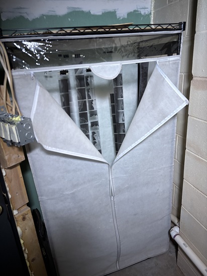

A cap full of photo flo to 1 gallon distilled water. Also, I never reuse mixed photo flo. Soak and agitate for a minute or two, hang to dry in portable fully enclosed clothing storage unit. I never wipe the film. I have not had dust problems or watermarks for many years. Using only distilled water for final soak and rinse gave same result, started using photo flo again with weak dilution because it’s cheap.
