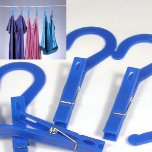

eli griggs
Nov 15, 2005
3,799
NC
Interesting cloths line clips, but they look a bit on the long side for an average sized drying cabinet.
Cheers.
MattKing
Apr 24, 2005
51,963
Delta, BC Canada
They are about 4 inches/10 cm long. Mine came from the Dollar store.
I use them directly, and I use them in conjunction with other, darkroom designed clips that have hooks that are too small to fit over a second shower curtain rod that I have added to the centre of my bathroom tub surround.
