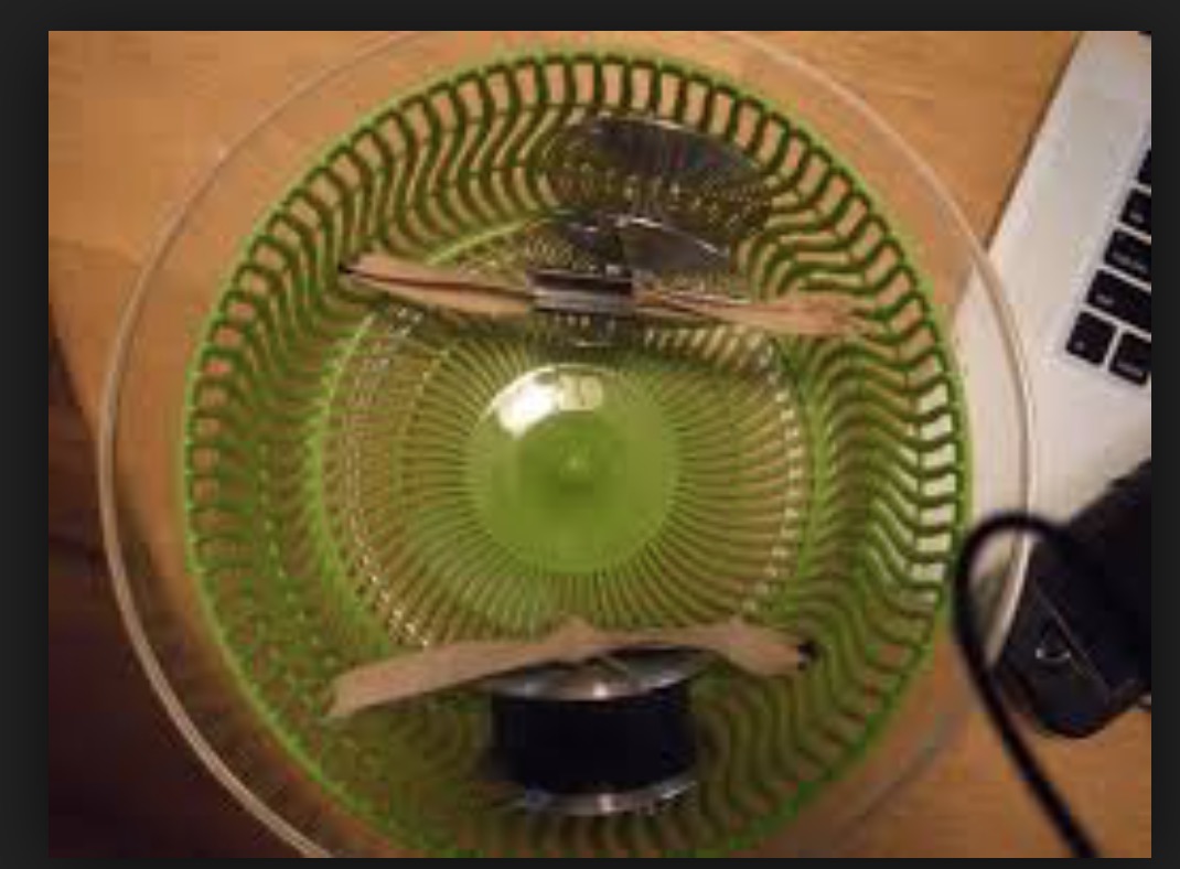

After doing this searching I found the solution that works great.
Buy a salad spinner. (for getting 90% of the water off before you start drying)
Get a 1 foot long piece of 4" diameter PVC pipe.
Get a "duct fan" of the same 4" diameter.
Buy a package of filters that go over furnace grates to keep the dust down.
Mount the fan in one end of the tube, tape a filter to the end of the fan.
Put the reel of film in the salad spinner and spin for 20 or 30 seconds.
Take the reel from the salad spinner and put in the end of the tube opposite the fan.
Plug it in and in 50 minutes to 1 hour you will have perfectly dry film.
