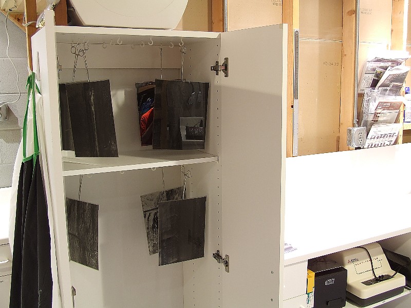

I don't want anything blowing on my film as it dries. It does take over-night to dry, however. There is a HEPA filter sitting on top of this cabinet, but it does not blow into the cabinet. I run the filter whenever I'm loading or unloading the cabinet. Also, when loading negative carriers.
