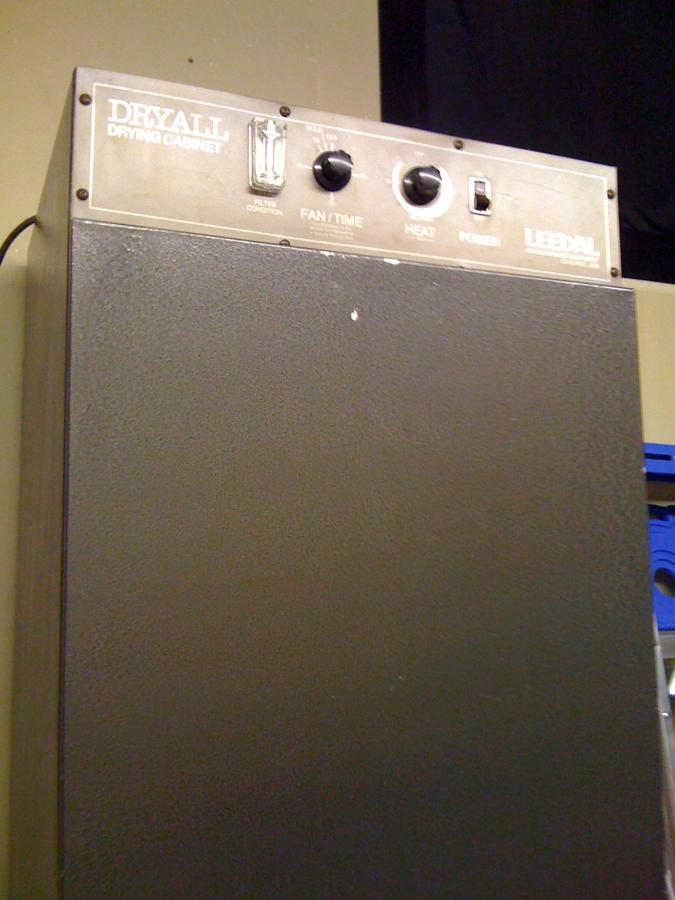

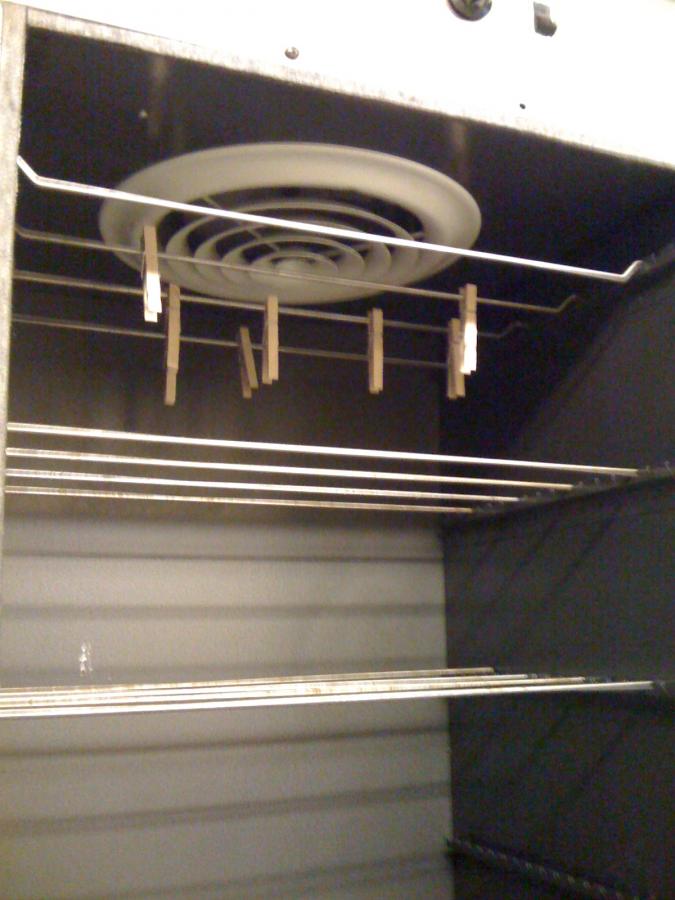

I've always considered the garment bags to be a great value. My BB&B canvas garment bag is quite decent, fairly well constructed, and inexpensive. The material breathes well and it keeps dust out effectively. However, what irks me about it is it's off-by-a-few-significant-inches height which always makes hanging 135-36 film more of a chore than it needs to be. It's also just a bit too wide in the space department.
Recently though, due to a recent CL deal that could not be passed up, I've moved on to something else.
So with that being said, out with the "new":
attachment.php
And in with the "old":
attachment.php
attachment.php
Guess how much it cost me?
100$!!
It's almost criminal.
