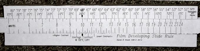

Here is one way of getting the developing time works great
A simple slide ruler for developing
All you need is the time and temperature an 68F/20C of the film and developer slide the ruler to that location. Then just take the temperature of your developer and find on the slide ruler and there is the time you need for your film.

Interesting. Would this work with any developer....I'm wondering whether the activity of all developing agents varies in the same way with temperature ?
An interesting gadget and in a way more analogue than a table :D I note that it indicates that a higher temp = higher contrast. Is this the case. I always assumed that more agitation or longer dev time at a constant temp gave higher contrast but temp by itself didn't

Where'd you get this slide rule?
This is excellent, was considering attempting something similar, but my efforts would not have held a candle to this.
Your file has been printed, cut and glued to bits of card - my new slide rule may just replace the tedious tables, graphs, electronic calculator and could take some load off the Massive Dev app. Have marked off the +15% points for the two partial exhaustion tiers of Xtol (can't resist 'hacking' it).
I am impressed.
