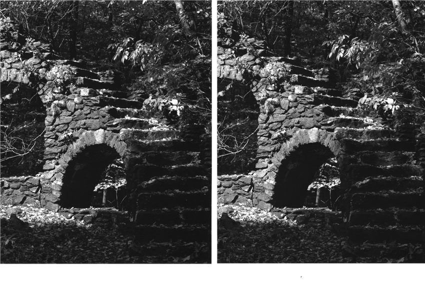

You will likely find that the differences between most developers are pretty subtle, with the possible exception of grain rendition, especially with 35. It's not a bad thing to explore, but it's easy to waste a lot of time doing it. It's best to have one or two very specific goals in mind for what you want to accomplish with a new process.
These are on 4x5 film, one was processed in Xtol the other with Pyrocat HD;

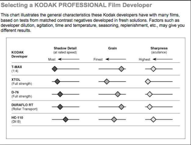

If you look at Kodak's catalogue you will see that they compare HC-110 and D-76 and not the other developers like DK-50. The Covington Innovations HC-110 website also quotes the publication and may be a bit easier to find.
the 2001 Kodak Professional Photographic Catalog contains a comparison chart.
Compared to D-76, this chart indicates that HC-110 (dilution B) produces:
  • Slightly less shadow detail or true film speed;
  • Slightly finer grain;
  • Slightly lower acutance.
Apparently, HC-110 has somewhat more solvent action than D-76, but less than Xtol.
Which is why I always think of the two developers together.
If you go by Kodak's reference chart posted earlier then Xtol is their best developer giving finest grain and sharpness and good film speed. That's been my experience as well over the years, I never liked HC110.
Which is which?
This is one of those "comparisons" that brings the subtle differences into light and makes a point obvious... although the differences are subtle and on its own each print is fine... Setting the prints side by side, I prefer the one on the right.
Which is which?
Left is Xtol, right is Pyrocat, the labeled version is in the gallery.

The difference on my screen is subtle indeed, and I'm not expecting anything more than a +/-5% difference in 'quality' anyways. But I'm picky, and equally curious, so I have to explore a bit before 'settling'. Thanks for the examples! It seems the XTOL is off the bat more striking because of the more apparent contrast, but it just seems to me that the pyro HD has better curves, giving the effect of less contrast even if it may not be the case. I guess these two frames were exposed the exact same way?
