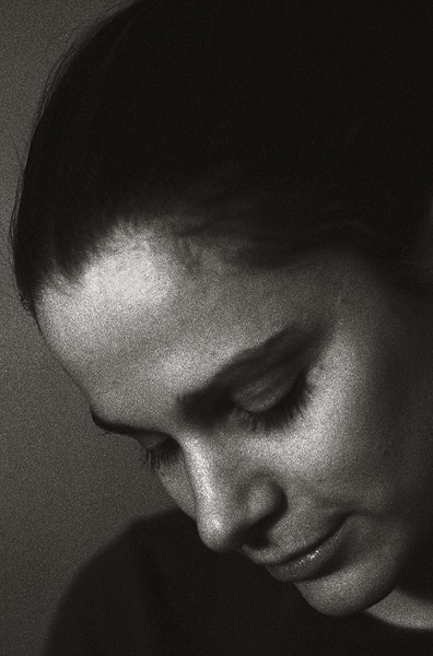

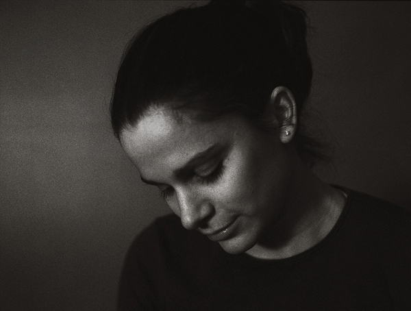

Delta 3200 & DD-X
Shot this last Tuesday. Medium format, though.
Delta 3200 & EI 3200, developed according to Ilford recommendation at 6400.
Mamiya 645 & 150mm lens at f/5.6
- Thomas

Thomas - Medium format is going to look very different to 35mm. A bit grainy to you will be a grainy pile of junk to me.

Very sorry about that. Here is a 24x36mm crop of the medium format neg, this time scanned, just for comparison.
- Thomas
