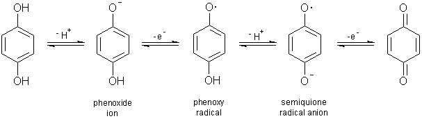

Here is a link that may be relevant.
http://www.chemgapedia.de/vsengine/...toff/oxidation_phenole/mechanismus.vscml.html
It presents a generic mechanism for the oxidation of hydroquinone.
This scheme is basically the mechanism I proposed. First the molecule loses a proton from a phenol group. Then the ionized molecule loses an electron. Whether this is what happens when hydroquinone reduces silver in a silver halide is a question, but it seems that at least my proposed mechanism seems plausible in the light of the basic organic chemistry for the oxidation of these compounds.
This is a correct scenario for HQ in water with an oxidant, but in a developer it is quite different. For example, the Q reacts with Sulfite ion to form HQMS anion and this is a developer. In addition, the Q can be regenerated by electron transfer with another reducing agent. This cycling of reactants can increase the life or the activity (or both) of any developer. Also, alkali produces more phenoxide ion and thus the entire sequence is dependent on pH.
Just a few comments.
PE
