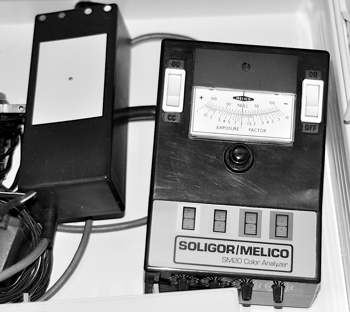

Has anyone considered using a color analyzer such as Beseler PM series as a densitometer?
The scale is the same, any of them would do it.
I was gifted some color analyzers many years ago. I use the "White" channel as my enlarger "Exposure Meter." The ones I have are "NULL METERS" so not as good for use as densitometers. Maybe the ones that are not NULL METERS will convert better. The measuring probe could make a nice negative holder.
