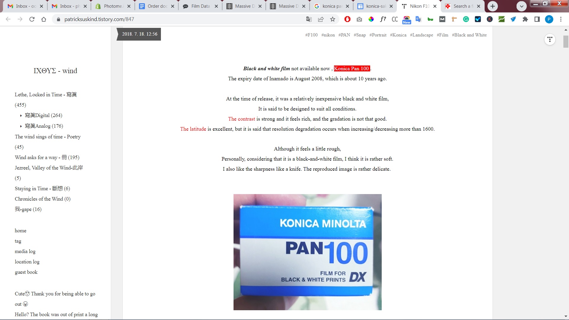

I did a quick search on Google and this screenshot is the best I could come up with. (it's English translation)

Okay, "relatively inexpensive" lets out relabeled Acros. The rest of the description at that translated (from Greek?) page suggests it might have been relabeled Kentmere -- though I understand that Konica actually had their own coating facility at one point (1980s to 1990s?).

Konica film was called Sakura prior to the name change in the 80's or 90's. Searching for Sakura B&W film may expand your results.
The film box shown is labelled Konica-Minolta and got an expiry date of 2008. This limits the period in time
