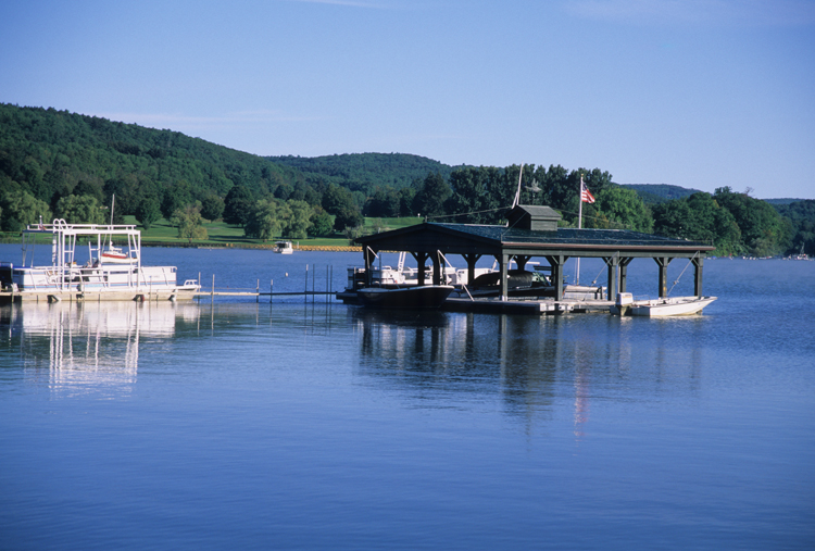

BTW: I shot this with the old Velvia 50 in late August 2006 around 8AM in Cooperstown, NY. Already I was "losing" the light you need for ISO 50 at my latitude.
