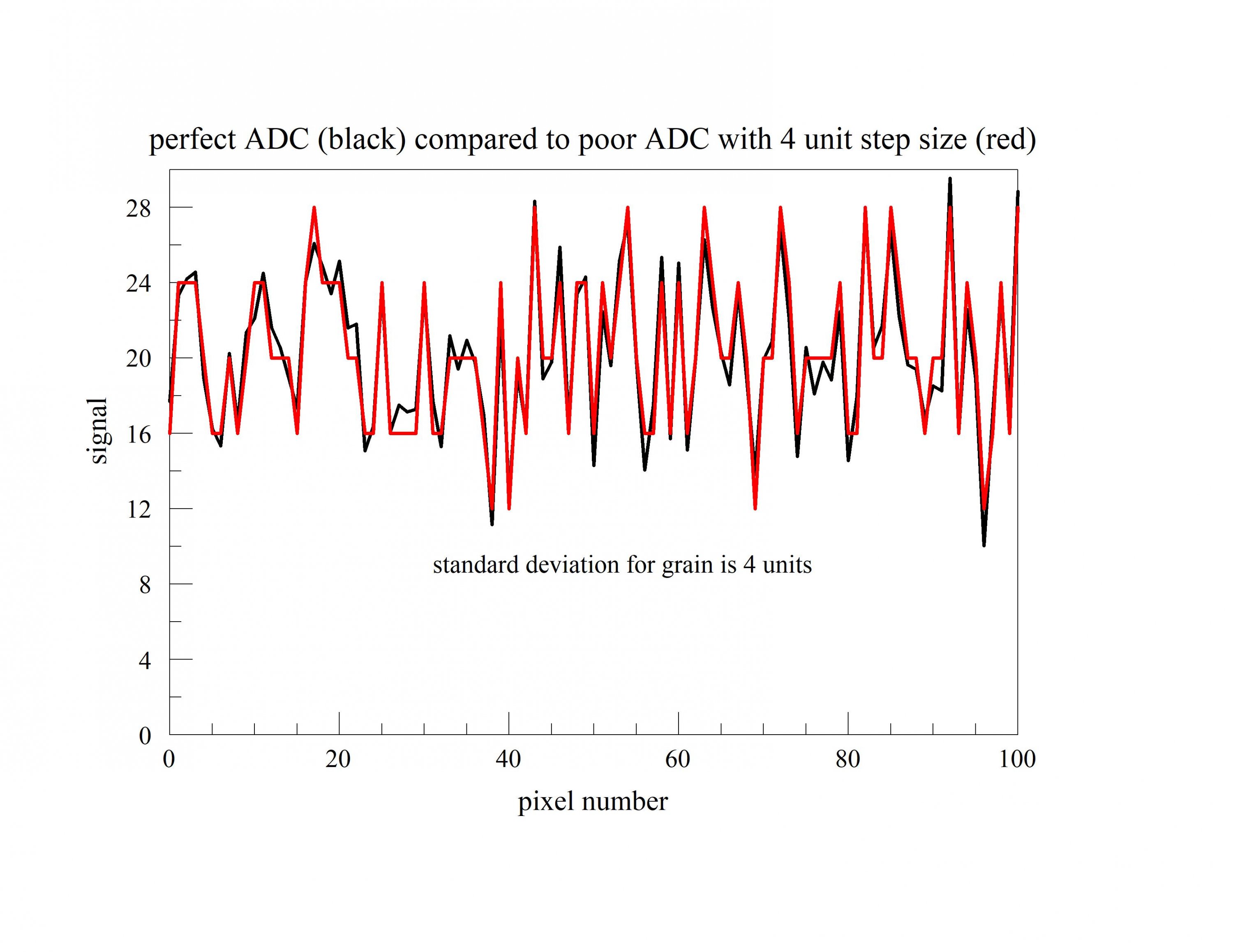

One thing that is overlooked in a lot of these discussions is the effect of film grain. If film grain (as measured by the standard deviation of the image in a pixel-size picture element) is comparable to the digitization step size in the imaging acquisition system, then having a finer step size has a negligible effect on image quality, including the rendering of intermediate tones and the smoothness of the rendering of tones in regions of the image having gradients.

I would be happy to explain further. It may take discussion back and forth to fully explore the point. In the meantime, give me a little time while I prepare something that might help.
In the meantime (yes, that's "in the meantime" twice) This link might help a little.

More discussion:
The first thing to consider is that film grain is a form of noise, which in this context means that if I photograph a perfectly featureless blank wall with film, then the exact density from two points on the film cannot be perfectly predicted by knowing the exact density at any other point on the film. That uncertainty is perceived by the viewer as film grain, and it arises from the fact that an image on film is actually composed of silver grains in the emulsion. We don't actually see individual grains when we look at a “grainy” piece of film, but we perceive the image as grainy because of the uneven variation in density at different points on the film.
I used the term “points on the film” rather loosely, just to get the conceptual train of thought started. We don't actually see points on the film, but rather (roughly speaking) our visual field is divided into a series of small very regions (ultimately governed by the size of the rods and cones in our eye) that are put together by the brain to compose the picture.
The same goes for a scanner. The scanner sees the image in terms of pixels, each pixel covering a very small area of the film. A single pixel is what I am referring to as a point on the film, not in the sense of a mathematical point (which covers an infinitesimally small area) but simply as a very small area.
If we take two pixels in the scanned image the values of the pixels will vary in a statistical sense, even if the photographed scene was a perfectly blank featureless wall. A large component of this variability comes from film grain, and because the silver particles are placed in a more or less random pattern in the emulsion it is relatively unpredictable and can therefore be characterized as “noise”. I say “relatively unpredictable” because we might know the average density in a region of film, but in any two pixels there is a degree of unpredictability. That degree of unpredictability can be characterized as a standard deviation. (I am assuming that you know what “standard deviation” means. If not it will require some discussion to capture that concept.)
Now, if the standard deviation is, let us say, four units, and if the step size of the analog to digital converter is, let us say, two units, then that is sufficient to capture virtually all of the information present in the image, i.e. using a detection system with a smaller step size(e.g. one unit of step size) doesn't improve things by any noticeable degree. This is true even if gradients are present in the image.
By the way, I wrote this in terms of density, which strictly speaking is not the best way to discuss the problem because density is a logarithmic function and signal acquisition in a scanner is a linear function, but I think it is good enough to capture the basic idea.
I can go into a more extensive discussion if that would be helpful.

runswithsizzers,
Here is some more information. I did a statistical simulation. I set the average signal at 20 units and I set the standard deviation for the grain at 4 units. I simulated two acquisition systems (referred to as perfect ADC with and ADC with a step size of four units). I simulated what you could get reading across part of a row. As the figure shows, there is practically no difference between the two. I doubt if anyone would notice a difference in an actual image.
Comparable figures with an ADC step size of two units or one unit show even less difference between the perfect ADC (which has an infinitely small step size) and an ADC with a finite step size.

It depends somewhat on what is meant by "dynamic range". The sensor has some noise. (All sensors in the physical world have some noise.) If the sensor noise is substantially less than one bit of the analog to digital converter (ADC) then the dynamic range is set by the minimum and maximum numbers that the ADC can register, which is apparently 13.3 bits in the example you cited. The fractional number for the bits is a bit confusing, but let's not get into that discussion and just round the number down to 13 bits. Since computers use binary numbers that are based on powers of two, 13 bits is equivalent to 13 f/stops.
If the sensor noise is comparable to or larger than the ADC bit size then the discussion becomes much more complex, and there can be several ways to look at the problem. In fact, if the dynamic range is considered as an average over a large area (a patch of featureless sky for example) can actually exceed 13 bits. This is equivalent to so-called "dithering" that is a known technique for extending the effective dynamic range of a signal acquired by an ADC of limited word length. One can even go to a 1 bit ADC format and still get dynamic range equivalent to a 16 bit ADC by oversampling the signal and applying dithering (i.e. noise) to the input of the ADC. This concept has been known for decades in the signal processing world. There are other tricks that can also be applied (some that include feedback, which I believe applies more to time-resolved signals than spatially-resolved signals.), but there is no need to go into all of those.
Please note that film grain and sensor noise have function equivalent to dithering, and from what I have been able to gather/calculate almost any negative film at almost any practical density can be adequately digitized with even an 8 bit digitizer due to the presence of grain in the negative, provided that the true spatial resolution of the scanner is fairly high. (This analysis tends to fall apart if the density of the negative becomes extremely high, in which case wider word lengths can become beneficial.)
There's a lot more that could be discussed, such as non-linear encoding/storage of a signal and other topics, but let me not go into it further at the moment. If there are any signal processing gurus reading this thread please feel free to comment and elaborate upon or correct any of this.
