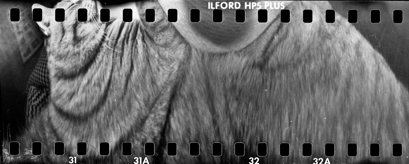

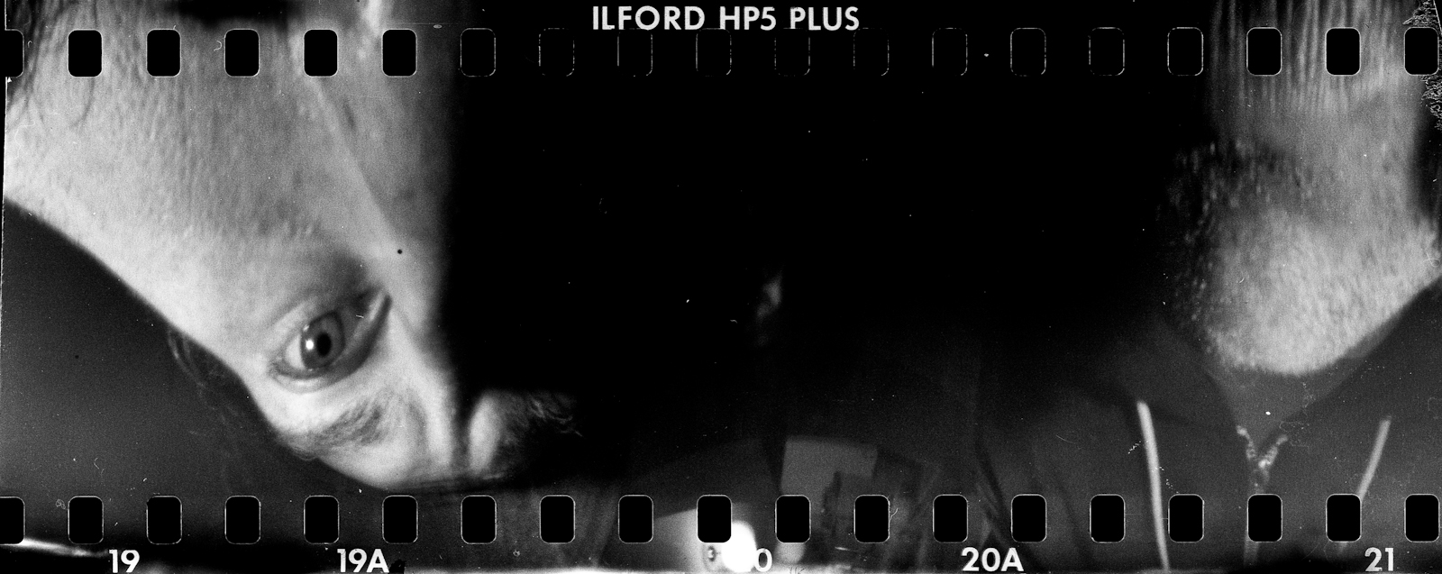

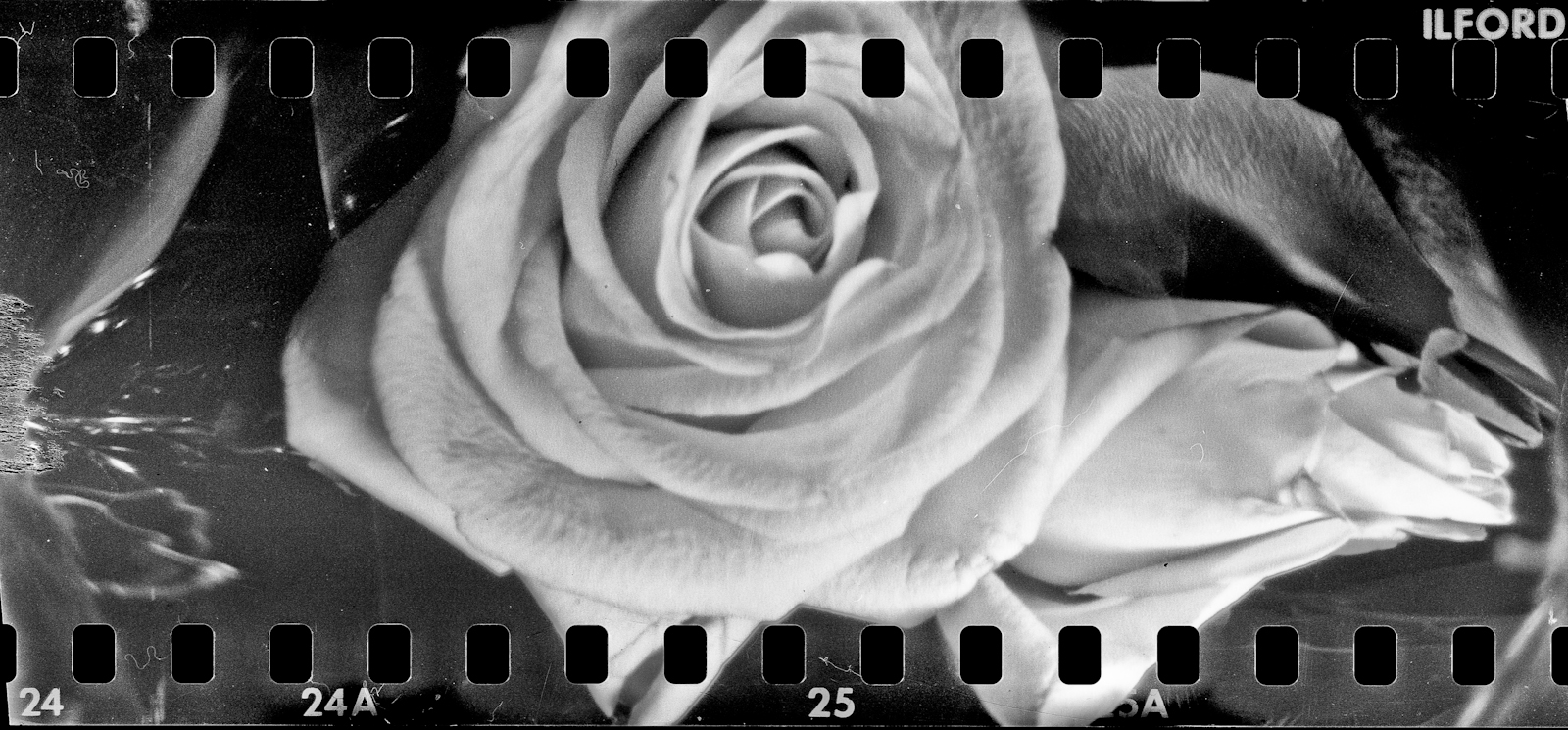

I made some film cannister pinholes a while back. Some with holes on the side of the can, some with holes on the cap so it wildly distorts the image.. Cat and Saxophone. HP5, shot with flash. Figured I'd make a post here since I just joined..

I love the cat nap. Nice distortion on the sax too.
Welcome to Apug. I'm glad to meet another pinholer! :smile:

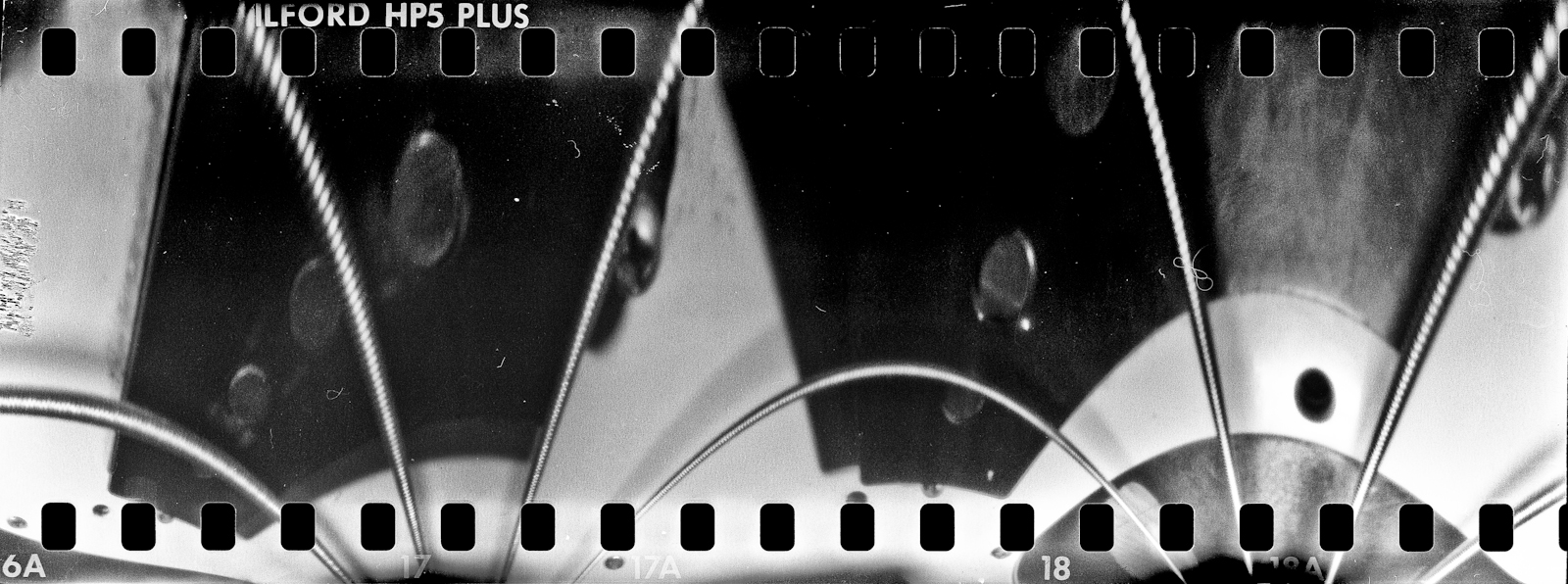

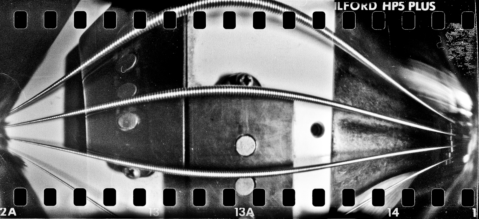

yeah, I've been obsessed with all things film for a long time but also got hugely into pinholes and making my own cameras..
I wanted a tiny pinhole cam for pinhole camera day so I could shoot while I was out running and the Film Cannister seemed small enough.
each cannister has a small (2" or so) strip of HP5 curled inside, making sure not to cover the pinhole itself in the case of the side hole cannisters. Putting the pinhole in the lid gives you a wild radial distortion as the light is coming in parallel to the film plane.
These two pics are from the same spot, held over the pickups of my P-Bass. First one is the lid pinhole, second is the side hole.. (same thing with the sax photos above, both taken from the same spot)

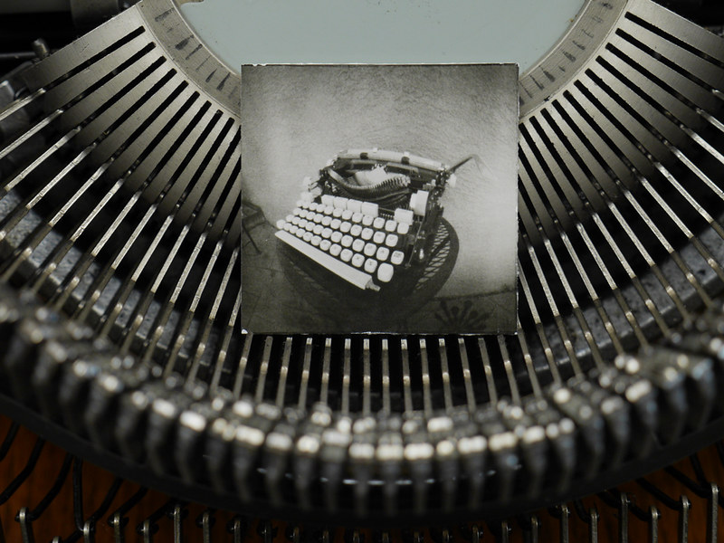

Here's my contribution to the film canister pinhole camera idea. Some weeks ago I'd built a kit of nine canister cameras, along with a cardboard carrying box. I use magnets mounted on the cap of the cameras to attach them to a metal tripod mounting plate. Today's image is of my Hermes 3000 "Nekkid-Riter" manual typewriter (the machine is the bare chassis, removed from its plastic body shell, mounted to a piece of oak). Harman Direct Positive paper, exposure 1 minute in bright shade, format size 1.75" square.
