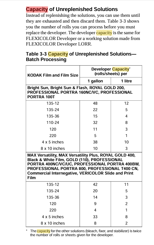

Sorry to be resurrecting the old thread, but I believe it contains incorrect advice. According to Z-131 one 4x5 sheet equals 0.4 rolls of 35m. That's quite far from 0.25 rolls as you stated. You have to rely on chemical capacity tables in datasheets because a geometric comparison is not straightforward due to varying % of film area getting exposure. Smaller formats are less efficient due to borders occupying larger % of their area.
The equivalencies were, of course, quoted from Kodak's black and white datasheets.
For colour, Z-131 gives you much finer detail than "one 4x5 sheet equals 0.4 rolls of 35mm":
It even tells you how much to adjust for sprocket holes!
As I read it, a 135 - 36 with tongue removed is 0.05145 sq. meters after accounting for the sprocket holes.
A 4x5 sheet is 0.01290 sq meters.
According to Z-131, the area of a 4x5 sheet is 25.1% of the area of a 135-36 with tongue removed.
Z-131 has a bunch of other relevant information affecting replenishment and other realities of commercial processing like carryover in roller transport processors. I expect it is those influences that change the comparative factor from 25% to 40%.

The key table is "Chemical capacity" which states that one 4x5 sheet requires as much C41 developer as 0.4 rolls of 35m. What matters is chemistry volumes, not square inches. Anyway, now I feel we've covered this and the thread can go back to hibernation for another 7 years :smile:
As that table 3.3 gives different numbers for different films, it is even more clear that there are other factors besides area to be taken into account:

Actually my point was that geometric area is unreliable indicator for the required chemistry volume. @Vaughn see above. The difference in area to chemistry volume ratios is exactly why area efficiency matters. Unexposed borders and leaders add up! 4x5 is far more efficient with its area than 35mm roll film.
TLDR: don't bother with geometric area, look at datasheets for chemistry volume requirements.
