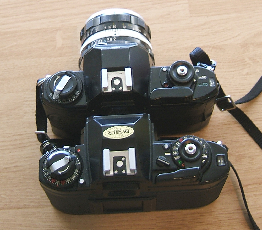

They're definitely different. I don't think they will interchange. The EM lever (the camera on the top w/ the non a.i. 50 lens) actually looks more robust than the FG lever to me.
