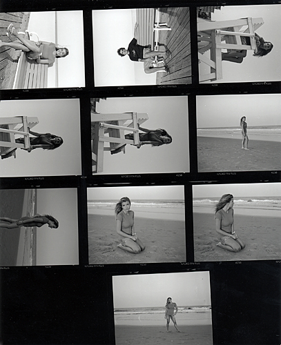

Here's one method I've tried before for 6x7. You lose a little bit of the frames on the edges, but atleast you fit them all onto a sheet of 8x10. This may work ok for some images, such as these here, but other images (landscapes) you may want to see the entire frame.
But the one problem with this setup though is that the negatives are cut and are now not appropriate for certain file pages.
I'm thinking the best way to do it might be the printfile pages dedicated to 6x7 the cutting 2 strips of 3 and two strips of two and doing the contact just like below except the bottom two rows would be two sets of two. Seems logical, right?
