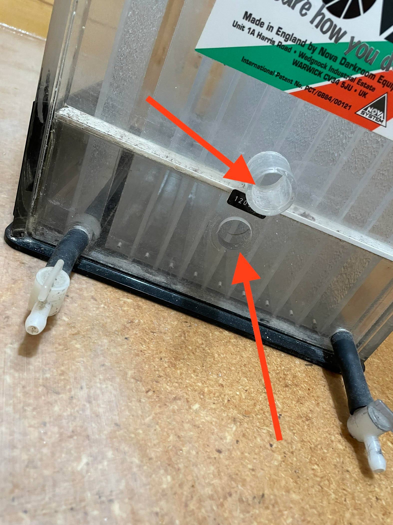

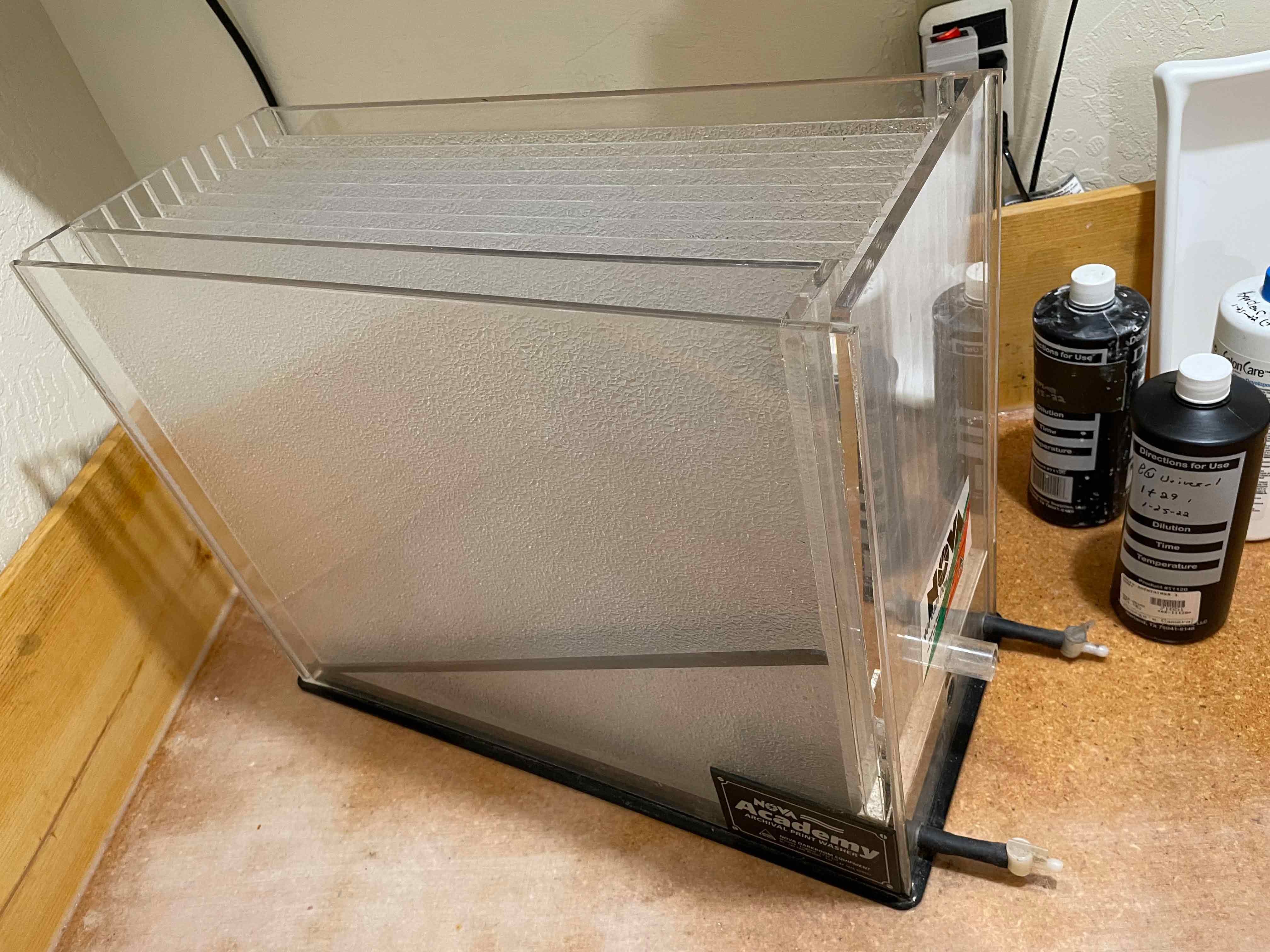

Does anyone have this model of Nova Academy print washer? It came with some equipment I just got and I’m trying to identify what I need to hook it up. I know it’s missing a connection in the lower center hole on the front and I can’t remember what the extended hole is above that (second pic below).

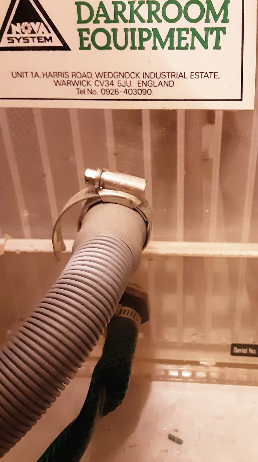

Hi,
Yes it's the same FB washer which I use for exhibition printwashing.
You require a 32mm rubber connector with a 22mm bore for the central hole as shown for the central port (water outlet).
For the inlet, it is a standard 19mm rubber pipe.Use the hose connectors (metal) to stop the water pipes becoming forced off due to the water pressure.

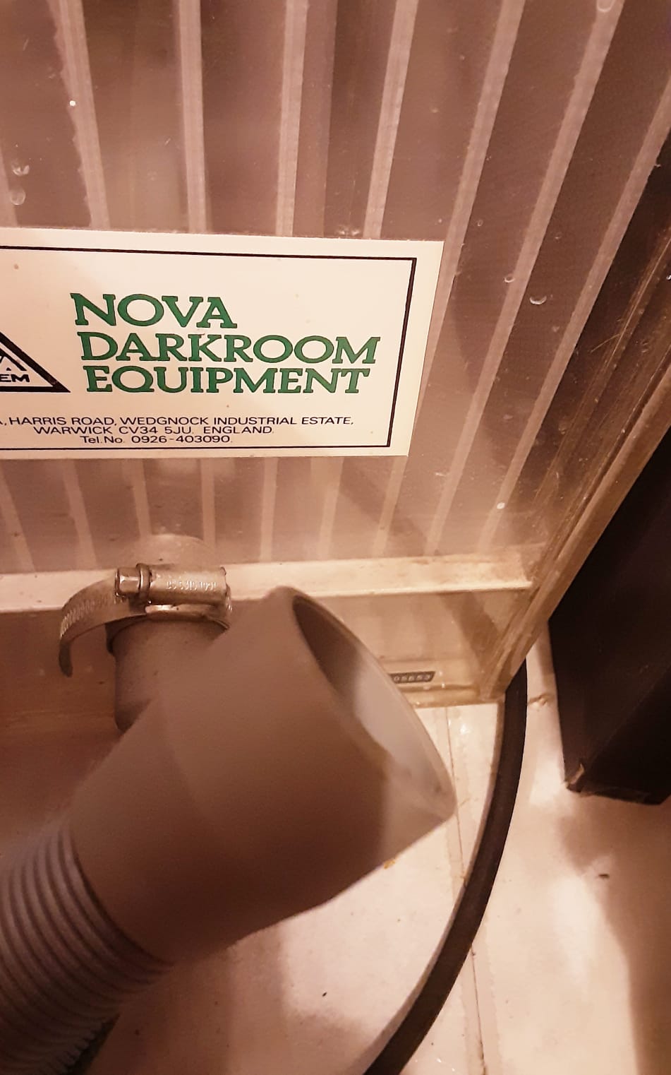

Here's the connector end

Thanks for this. So the lower of the two central holes requires a 19mm rubber tapered attachment, correct? They kind with the tapered barbed surface that you push a hose onto?
