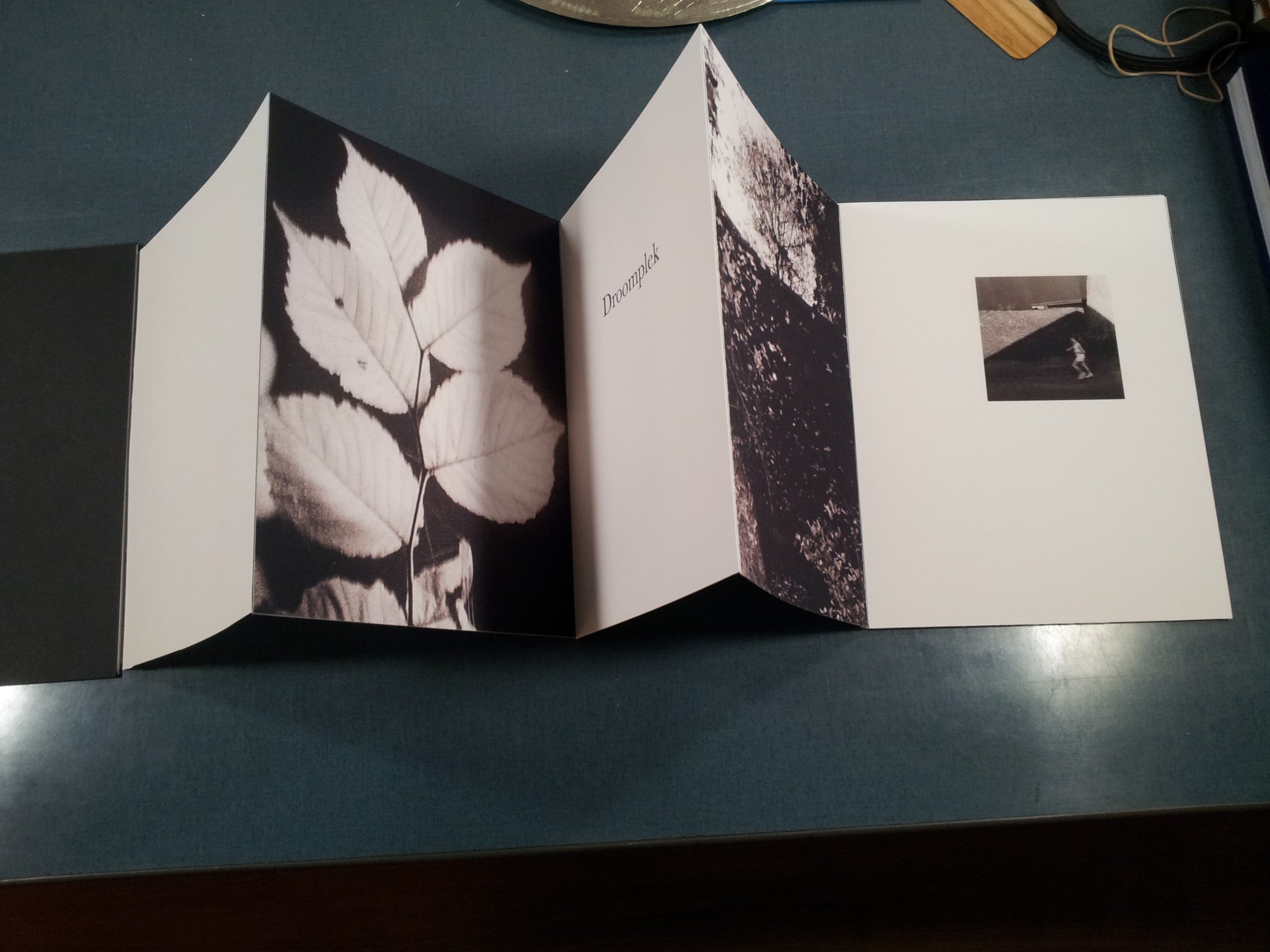

The accordion books (aka Leporello) I'm familiar with have all the pages connecting side-by-side to each other, so you can see them as a long sequence or fold them and go trough the book page by page. Like the photo below. All pages are connected with tape on the back, no glueing. The advantage I see in tape (the very thin Scotch tape) is that you can easily cut it and re-tape it if you want to change a sequence or combination.

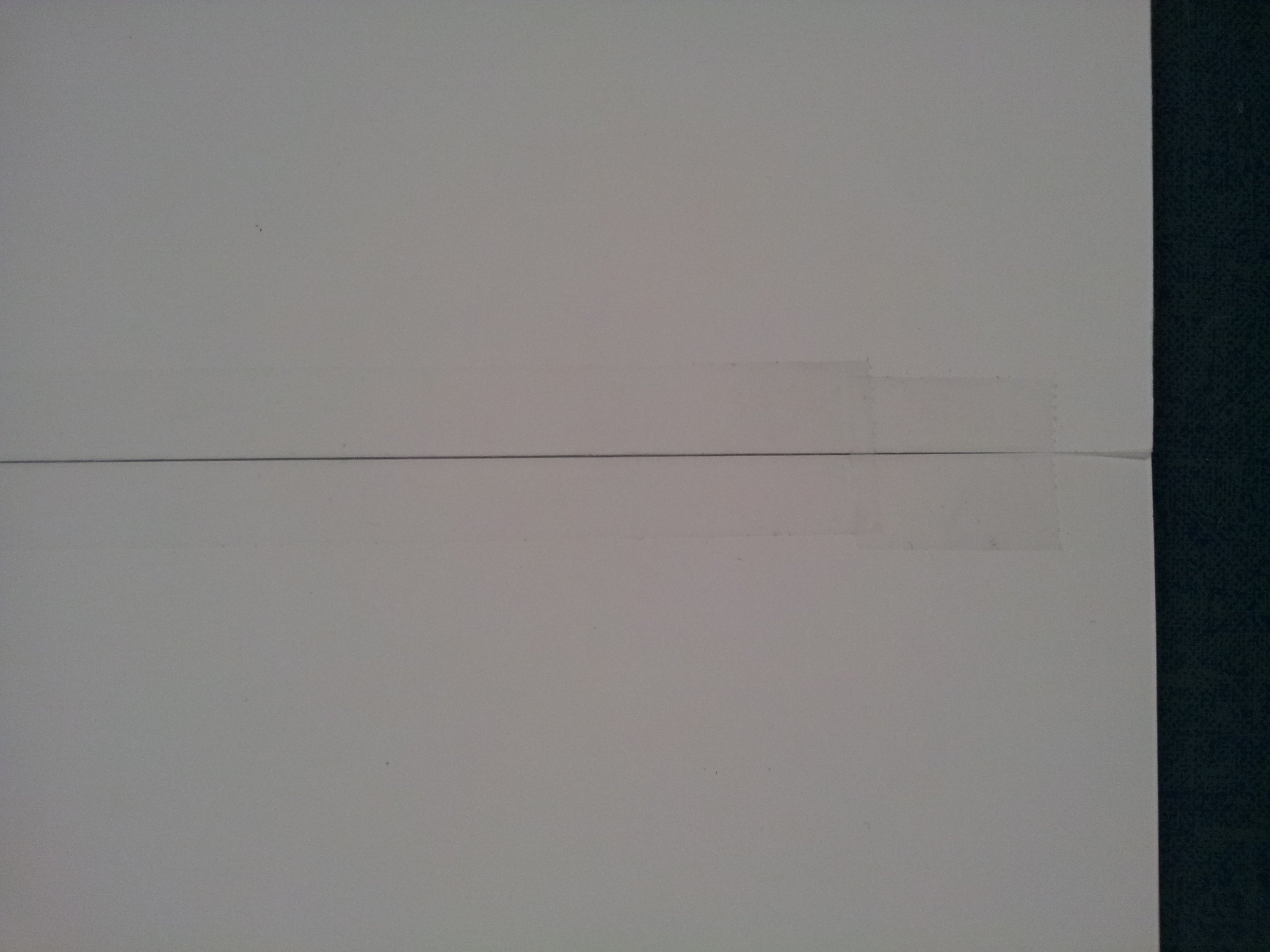

These are 2 pages that will fold back-to-back. You put the 2 pages side by side and then put tape over the fold, easy:

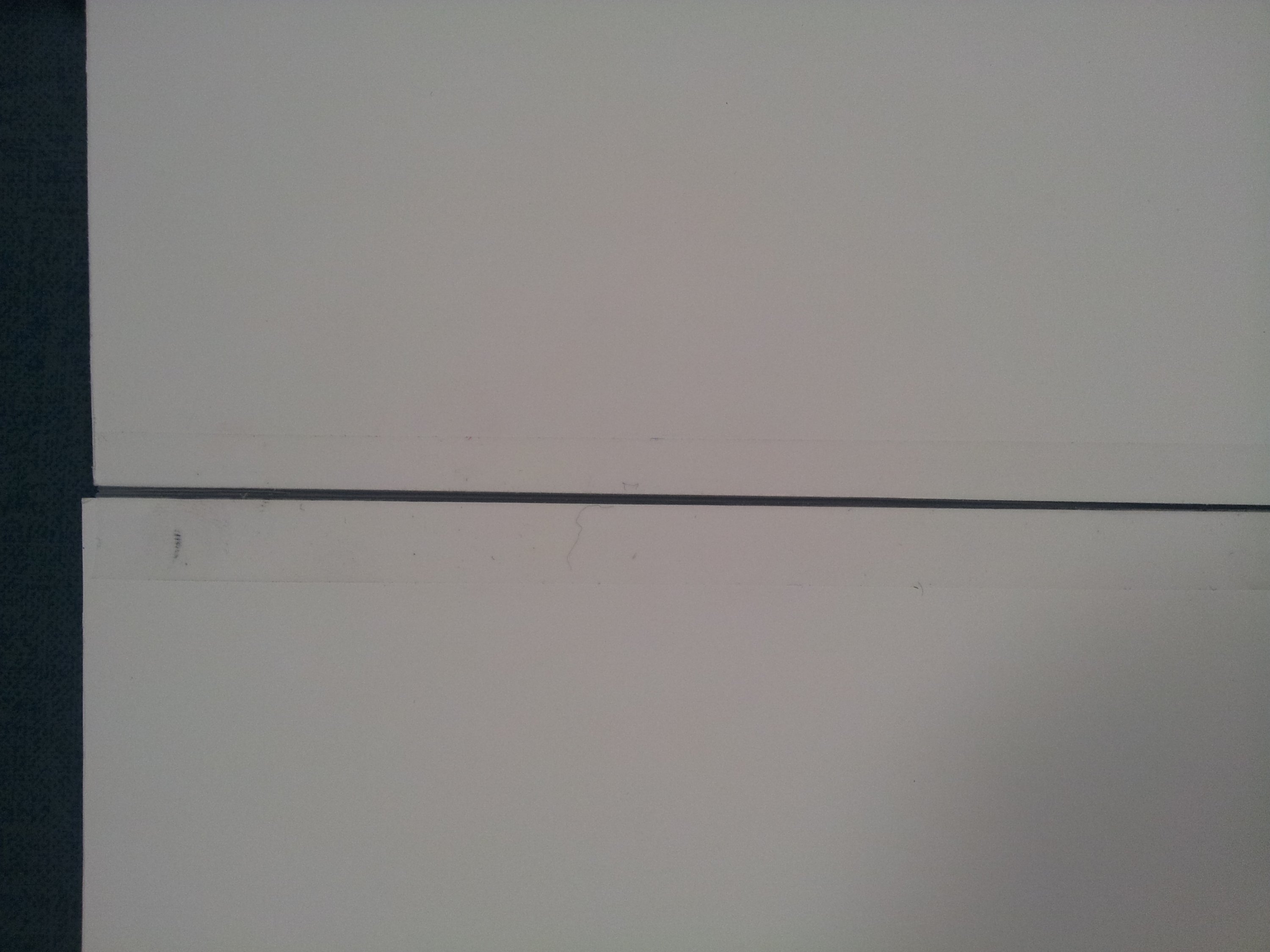

These are 2 pages that will fold front-to-front. The tape needs to go around the edges so you need some space between the pages. I take one page and stick the tape to the back, half-way to the width of the tape. Then turn the page around, put the second page on top of it (face-to-face) and fold the tape around the edge and stick it to the back of the top page.

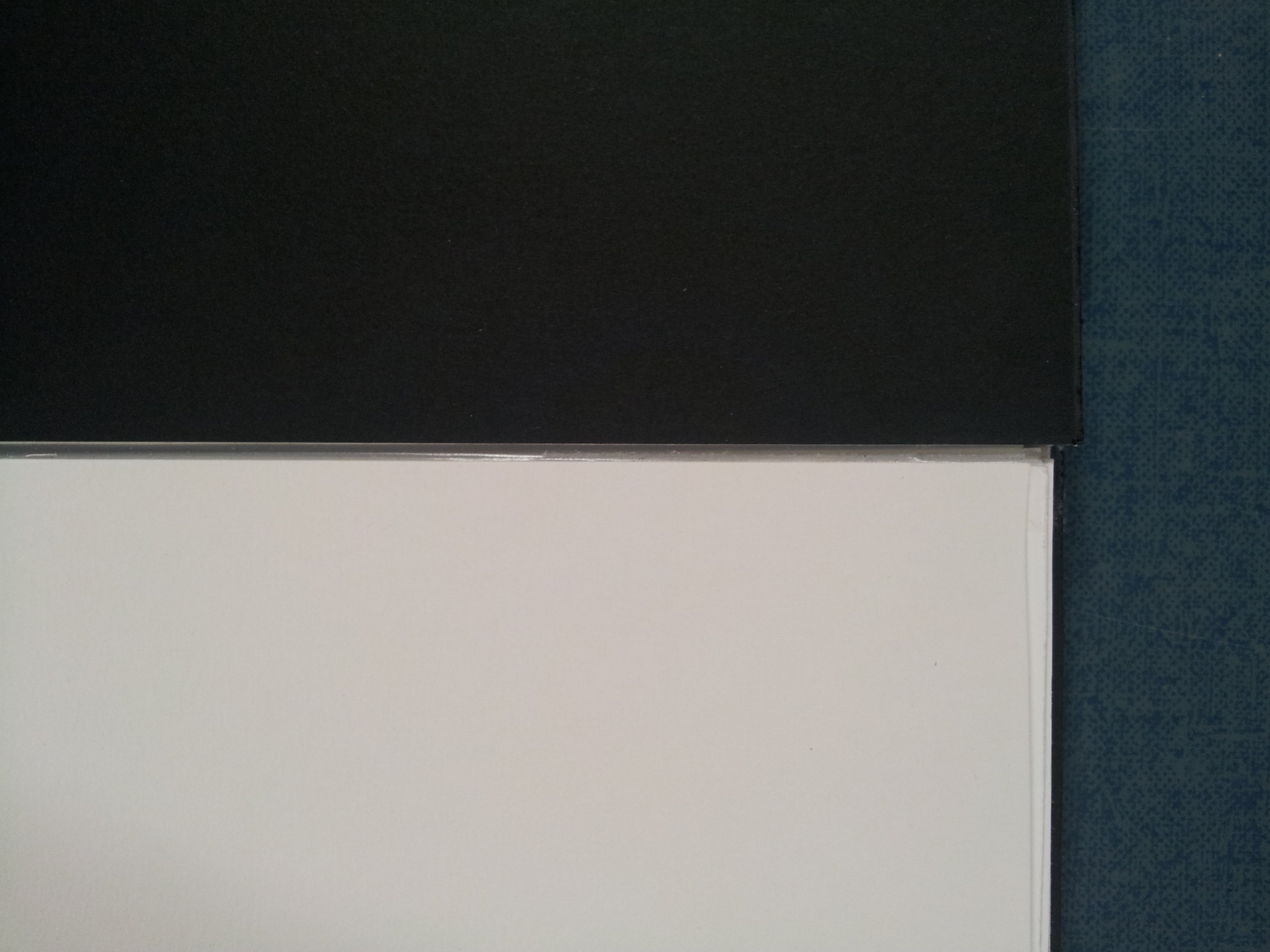

This is the connection between the cover and the first page; more or less the same method as above:
