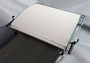

I'm almost set up in my new darkroom, but I'm still learning the tricks for drying fiber prints (and then mount them, in a flat way).

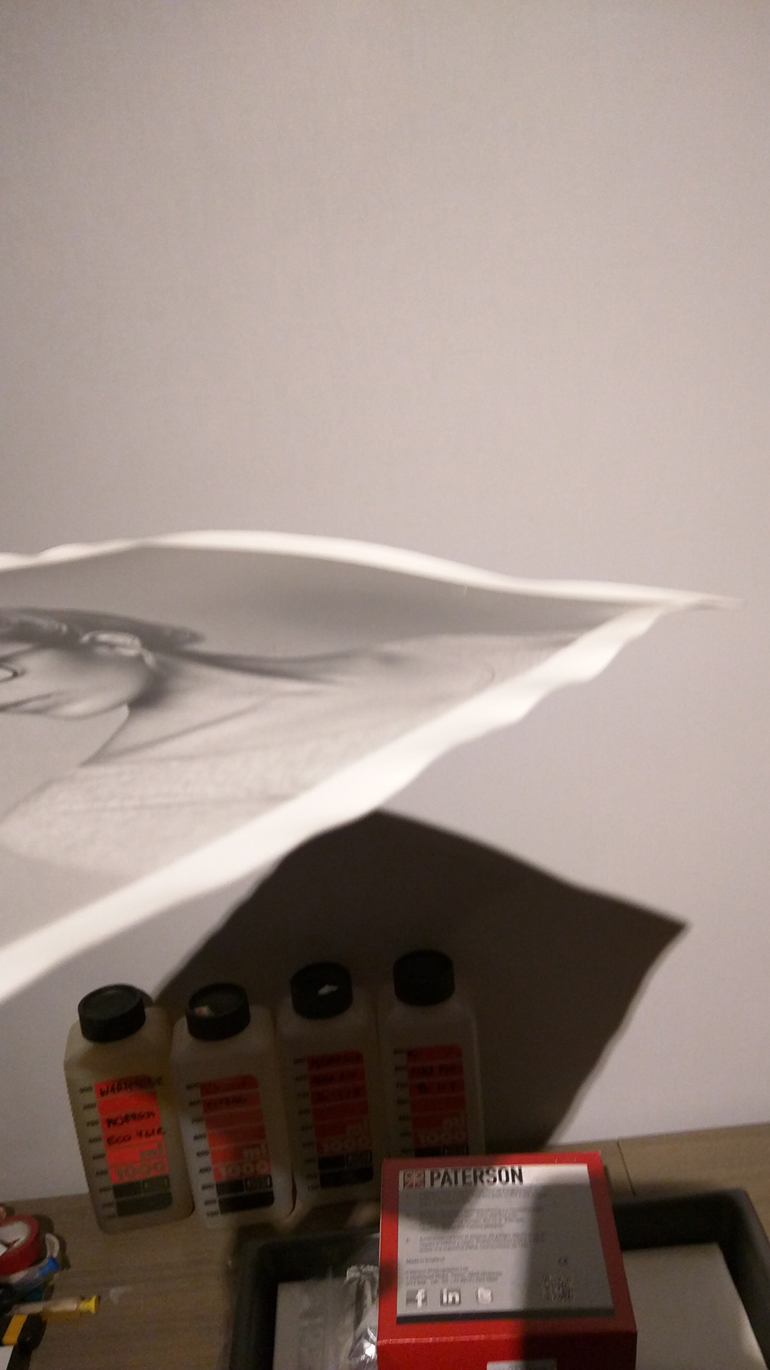

I aquired a dryer press like the photo below, to dry my prints flat. Works, but the edges / borders of the picture start to wrinkle/ripple. Like a wave. Any idea how to solve this? I cannot choose temperature. I tried drying them wet, tried flattening them while they were dry already. All start to ripple, but only on the long side.

Dear Jessestr,
You are now at the stage where experimenting with your dryer is appropriate. None of these dryers have nice proper controls so you will have to adjust as you go. My guess is that you need to raise the temperature a little at a time until you get where you need to go. In the meantime, you can improve the flatness of the print by putting it back in the dryer on a low setting for a while.

I set mine to medium, let it warm up, place photos in, then turn it off and leave it alone for a few days. Fiber prints still tend to wrinkle around the edges a bit, but flatten out once I have them mounted.

As for your problem with wavy edges, if your dryer doesn't have heat settings, try warming it without the prints, then unplugging it when you put the prints on and let them dry cold. Pressing the prints after they are dry under a stack of books or other weights will help with the final flattening.

I used to dry my prints for exhibition and get really crispy flat prints by sitting the wet print on to a flat piece of glass, tape around the edges with brown gum tape, when the print dries it's extremely flat, if you're in a rush you can put a fan drier in front of the print or if you have a drying cupboard even better.

Trimming off about three millimeters from each side can relax the paper and help the sheet lie flat. Alternatively, look carefully at the power-rating required and find an adjustable supply of some sort (Variac, or a modern power-transistor based system) to lower the voltage used by the machine, if you feel it is too hot.

wavy sides is common for single weight papers. besides, once you are ready to dry mount, youll flatten them when you pre heat them in the press.
also see if you can adjust the tension of the material? perhaps when it gets damp it slackens.
my drum dryer was doing that, its old. i adjusted the tension by moving the metal rod slightly back n all is fine.
just one more point... drain the prints really well before putting them in.

Get a sheet of watercolor paper from the art store near you (the heavier the better) and put that between the canvas and the print. It will slow down and even out the drying, as well as keep your canvas clean. When you have all your prints dry, put them in a stack facing up into a hot dryer then turn off the heat. A couple hours later (or when they have cooled) your prints will be flat. If that doesn't do it, a couple days under a really heavy weight will.
I store prints in overstuffed boxes in stacks. The prints are always under pressure that way and stay flat. Just a tip.
Hope that helps you.
thats a great idea to increase. the cloths tension plus give more even drying.
watercolor paper is rag and comes in acid free.
just be carefull the emulsion doesnt stick to the paper
Hi there, at the moment I can't remember where I found out about this but a "hot pressed" watercolour paper is the ideal type - presumably because it is resistant to changes caused by additional heat (?). I use this in my dryer, partly as it protects the print from fluff on the apron and the print doesn't stick to the paper. No guarantees for other users though! :smile:

I use one of those as well,,,What works for me is,set to medium and let it warm up.squeegee the print front and back,put in dryer until the emulation sets up (not soft)about 97% dry. Then press between 2 form core boards with wait on top for a few days or so(depending on humidity) then dry mount onto your backing board,I use a seal dry mount press. Just experiment and have fun,you will get it.

I bought 200 meters (650 ft) of brown gummed tape, works like a dream. My prints are even flatter then my RC prints. Really great and cheap solution
