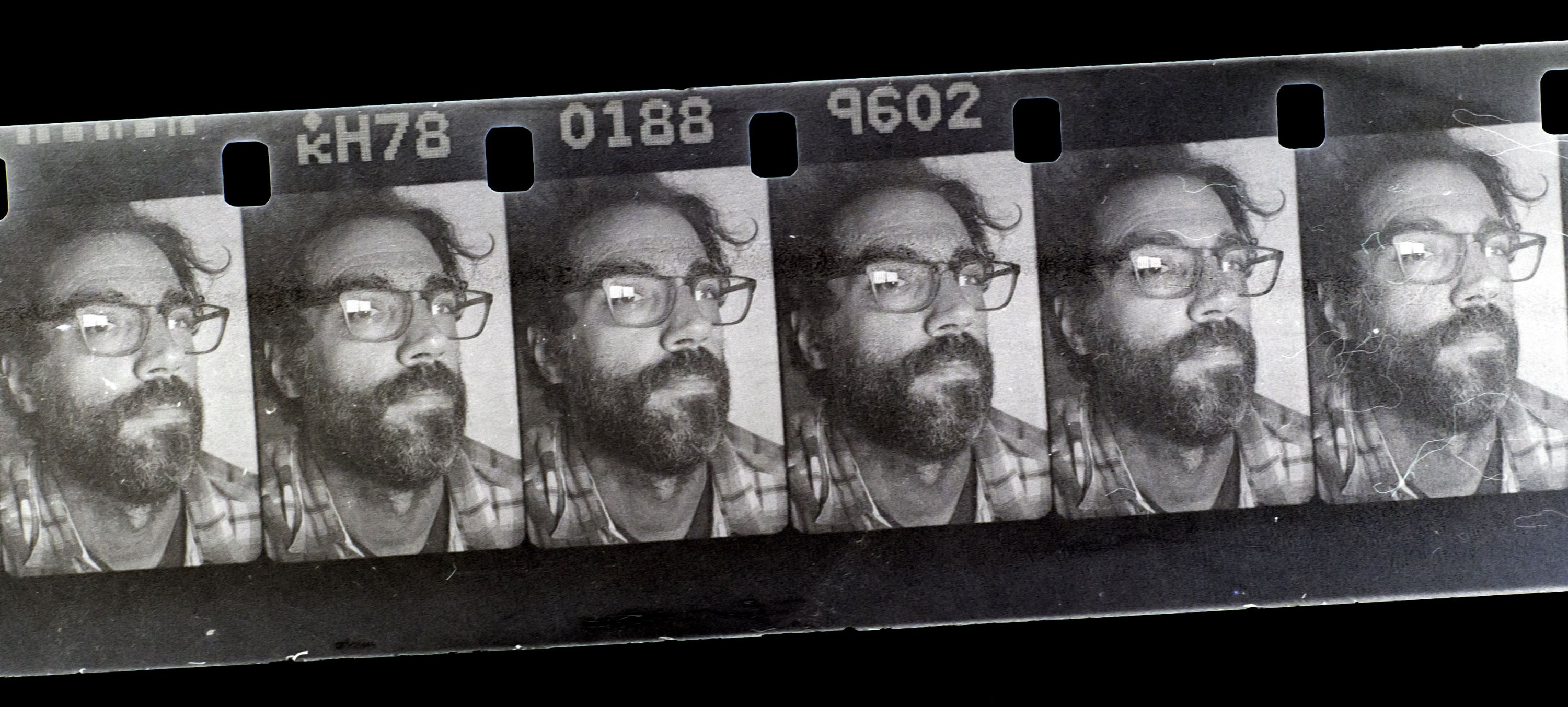

Hi!
Ferric developers work quite well on modern films. I'm researching it and doing some tests. Here is one, Plus x 16mmin ferric citrate developer for 24min at room temp [around 19-20ºC]
Donald Qualls
Jan 19, 2005
12,104
North Carolina
Nice! What film speed did you get?
