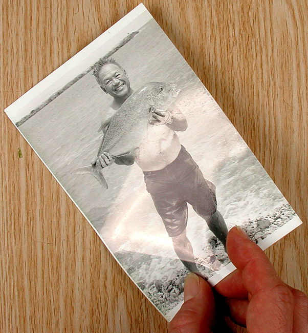

So I soaked a B&W inkjet print made on Harman Gloss AI in a tray of water. The top layer started to crinkle a bit, and I damaged it by touching it, but that's easy enough to avoid. Then I rolled it out face down on the plexiglass with a heavy rubber brayer used for dye transfer, let it dry overnight, and it pretty much worked, which likely means that the Harman Gloss is not only coated with baryta, but also with gelatin. I don't think the inkjet paper has as much gelatin as the silver gelatin paper, because the gloss doesn't look as deep, but there is some. There are unglossed spots, which may be curable with Pakosol, if it still exists, and if it doesn't dissolve the ink. What was Pakosol anyway? The MSDS lists hexylene glycol, but presumably there could be other non-hazardous ingredients.
Why do this? More tonal range and less gloss differential without application of a spray or topcoat.
