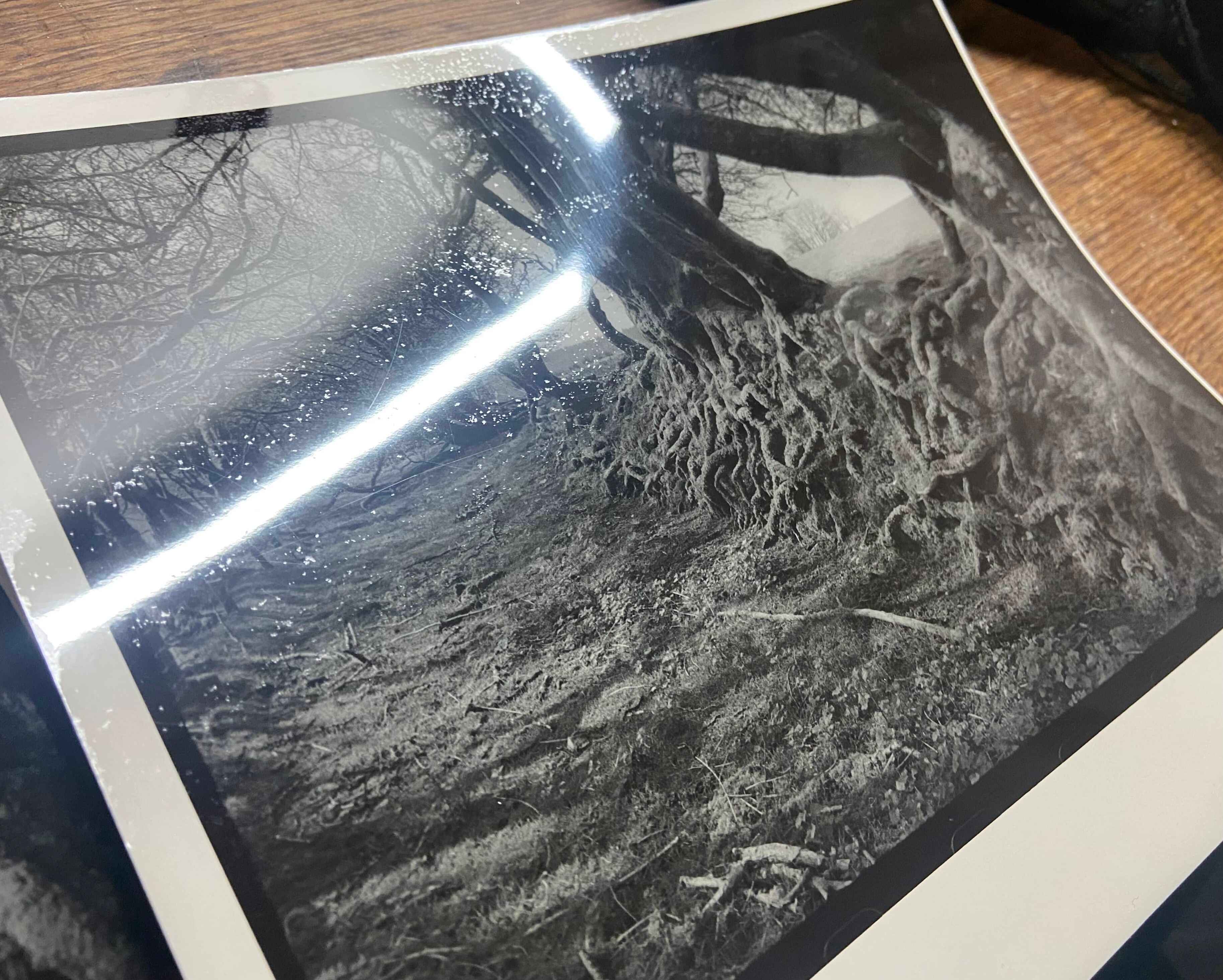

Hi does, or has anyone tried to ferrotype/glaze fibre paper with any success?
I’ve tried a few times now and seem to have similar issues. There is a ‘pitting’ on the glaze. I have polished the plate with a beeswax & turpentine polish and soaked the print in a photo flow solution and then squeegeed the print flat and let it dry naturally. I don’t get any ‘oystering’ just pitting. I think it’s air trapped between the print and the plate.
Any ideas on how to remedy?

I was sent a formula of a similar product (I think an Agfa formula) once upon a time, and I did some testing with it. It contained formalin, photoflo and glycol as I recall. It didn't help much at all. What did help was use plexiglass instead of regular glass. Gelatin sticks really well to real glass; it's a 'trick' that has been used by carbon printers for well over a century. With ferrotyping, it evidently gets in the way! Plexiglass (and polyprolylene, polyethylene etc.) generally bond much less effectively or even not at all with gelatin, making them easier to work with in this application.
I agree with @ic-racer that the result shown here is actually pretty good.

This is usually due to tiny air bubbles or some kind of dirt/fouling on the glass or plexiglass. Cleanliness is next to godliness, and all that.

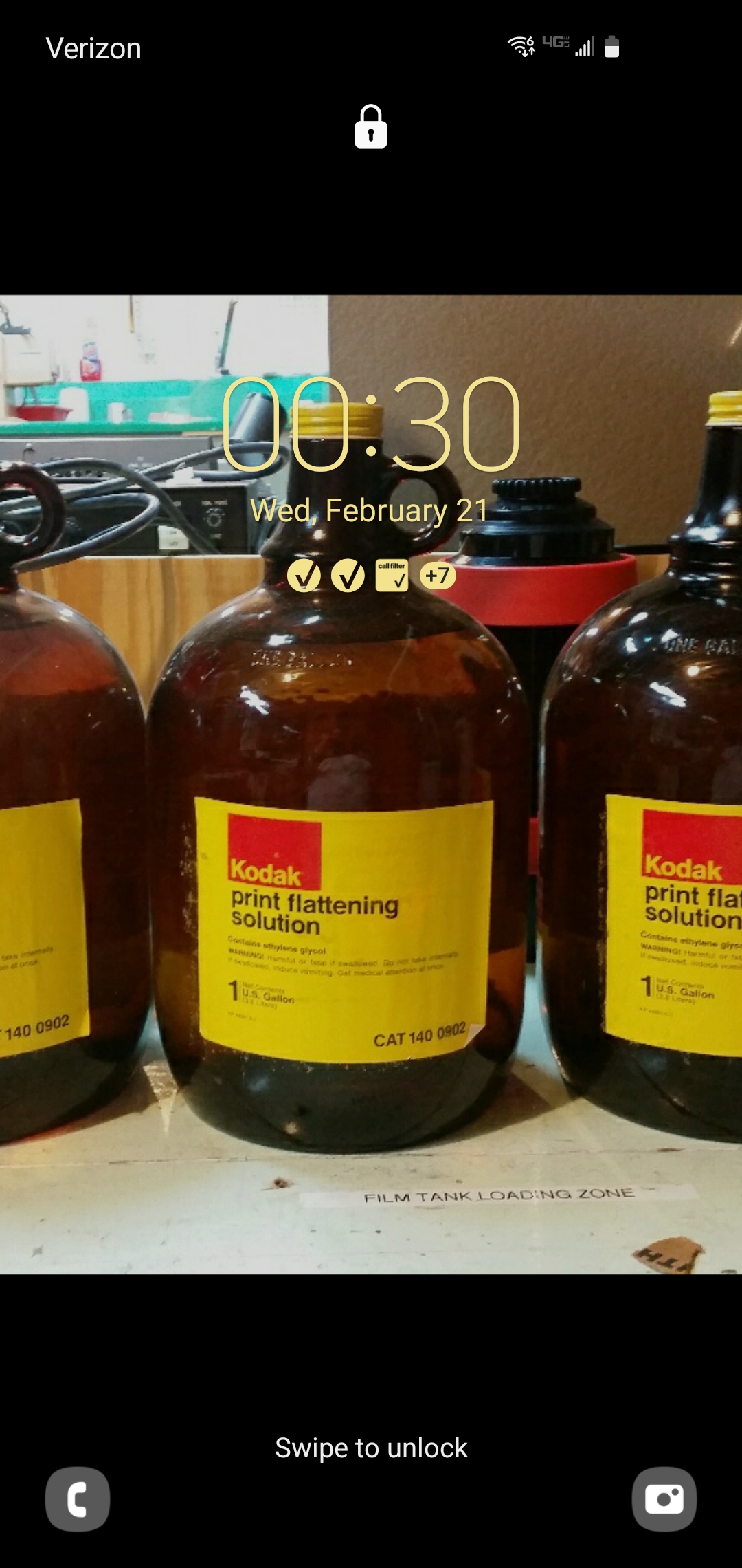

Note that Kodak Print Flattening Solution (it was an EK product until at least the 1980s) is very bad for print permanence. The RFF thread that ic-racer mentions above has good info.

While in the Air Force we had a couple of Pako, 90% of prints were glossy, maybe 10% semi matt, most semi matt were for the officer's personnel file, needed a current 5X7 semi matt as I recall the technical orders. Not sure when that practice was discontinued. At the time we used Kodak print flattening solution. Although Kodak wetting agent does not have the antibacterial or antifungal agents wonder if it could be as a print flatting agent?

Yes, I assumed it was small air bubbles. I think I’ll submerge the plate as well as the print in the tray next time to see if that helps.

Hi Koraks, thanks for saying it looks ok! I’m not that happy with it. I’m using a stainless steel plate made by Photax. I first cleaned it with silver polish and then gave it 2coats of polish made with beeswax and turpentine. The prints lift of great when left to dry naturally without heat. It’s the pitting I need to address. I as I mentioned in an earlier reply. I have a plan!
Yeah, that might help. I do a lot of 'mating' sheets together in carbon printing, which needs to be bubble-free as well. Submerging both halves does indeed work quite well as long as you have a tray that will hold everything. Give it a try.
The beeswax polish probably helps a lot with the prints lifting off of the plate. I've tried chrome plated steel a couple of times, but only managed to transfer the chrome plating to the prints (the latter of course did not survive)...
