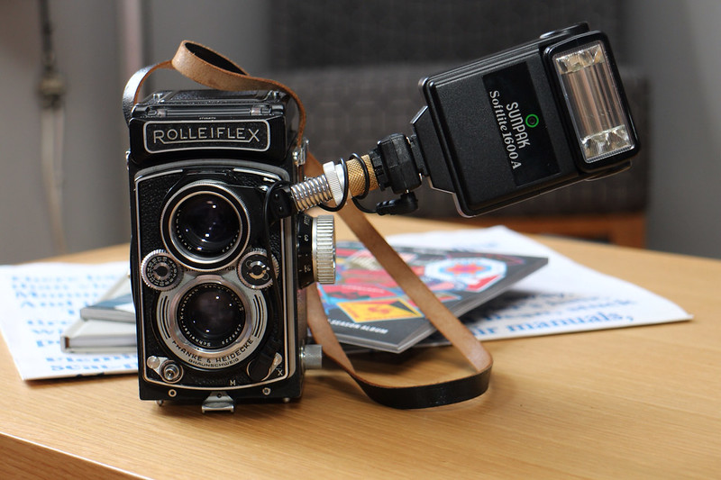

Yep. That looks rather easy to achieve. I may mount continuous LED light for focus assistance ;-)
May we have the break down images of that flash handle.
cloudroot
Mar 19, 2015
6
London
Hey sjauch, nice work with flash on a rolleiflex.
I have a rolleimagic (bayonet 2) and want to attach a flash to it.
I have a rolleiflash (bayonet 1) and a Canon 580EXii
Am at a loss of how to attach either.
Any ideas/advice would be great.
