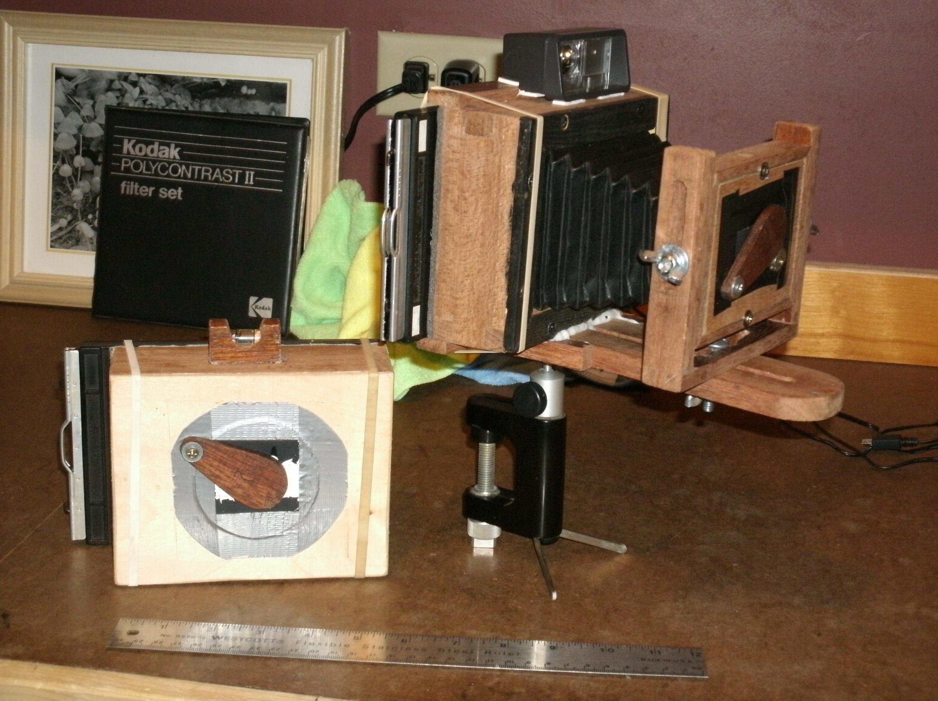

Heck yes. The bellows camera is 70-170mm the other is 55mm.
