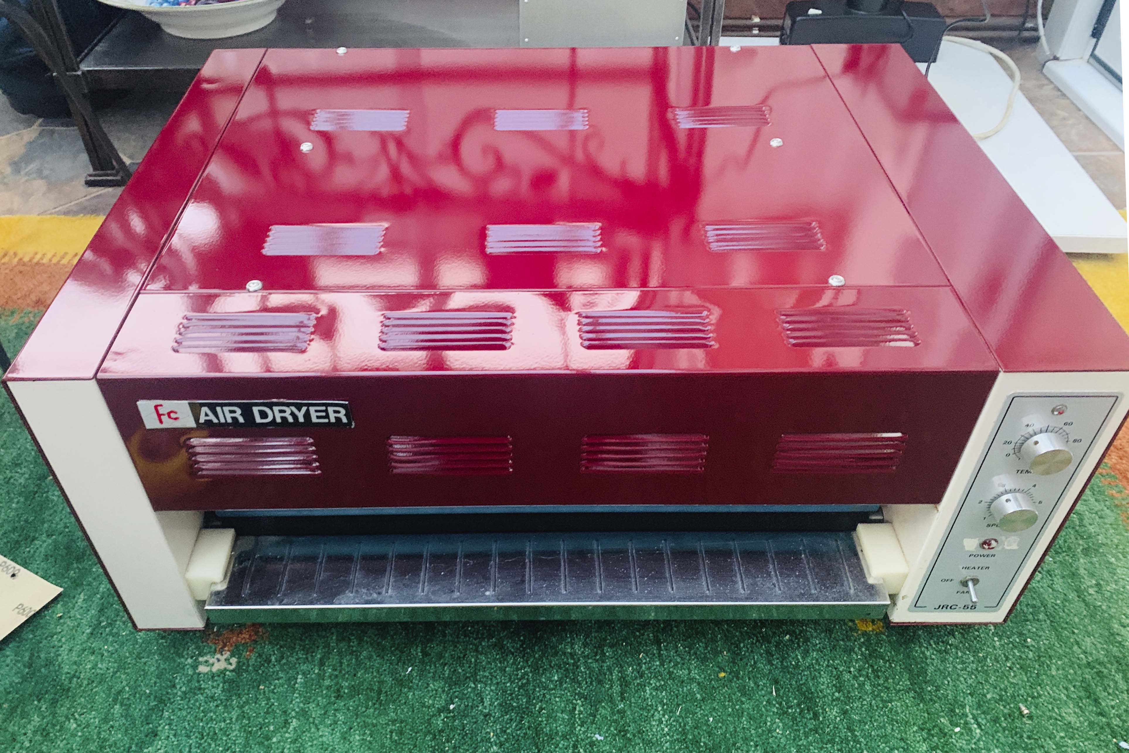

Hi
I have recently acquired a Paper Dryer as per title, it is not a brand that I am familiar with I am hoping that someone could furnish me with some details & maybe a service guide? The only thing I can say is boy is it huge, certainly bigger than the Ilford RC dryers & heavy too
It is probably too large for the space that I have, but I will use it until I can find a better solution.

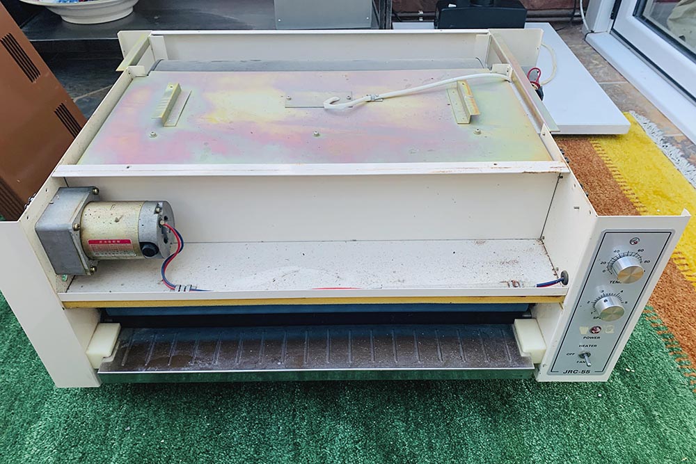

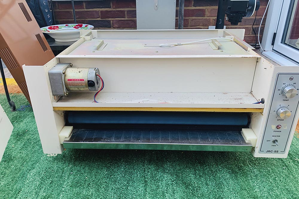

Well I have stripped it down and given it a good service, re-lubed the bearings, checked. the electrics, in the end I decided the colour scheme was too 1970s (even though it was made in 1980) so I had it stripped & powder coated & lacquered. I am quite pleased with the end result, replaced all of the steel fixings with stainless, but I still want an Ilford print dryer so this one will be sold.

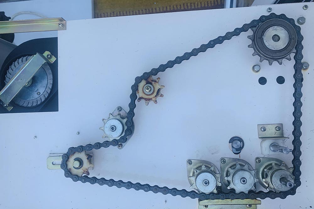

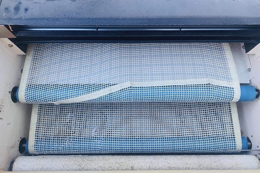

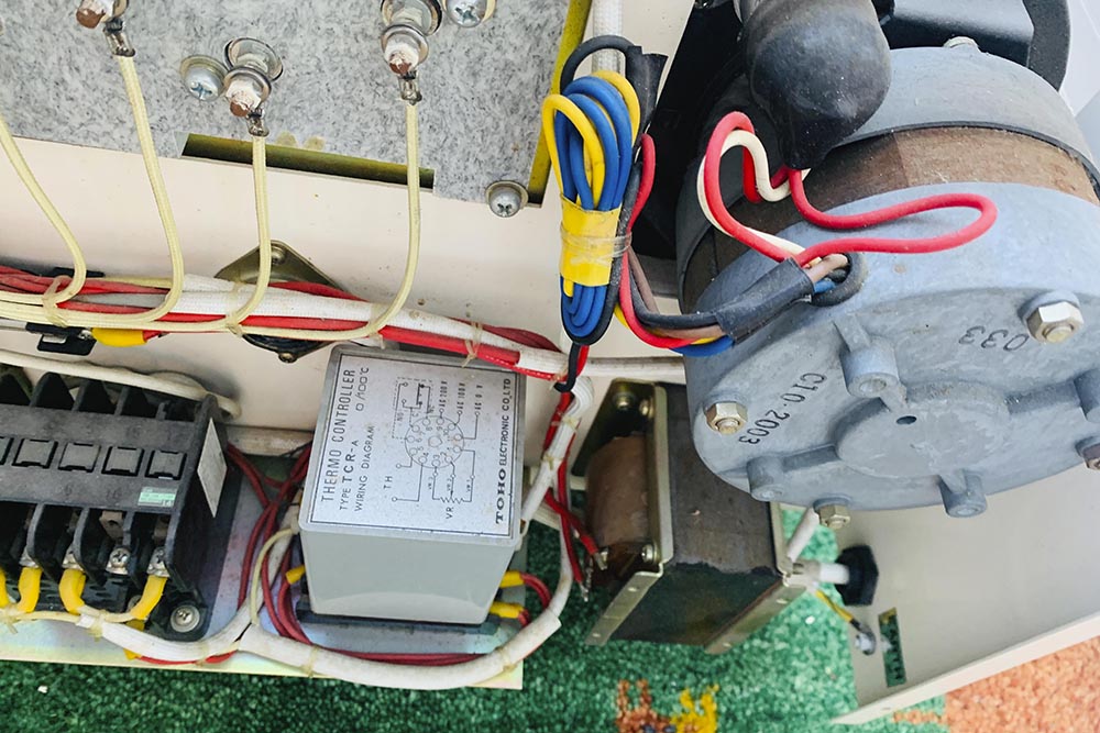

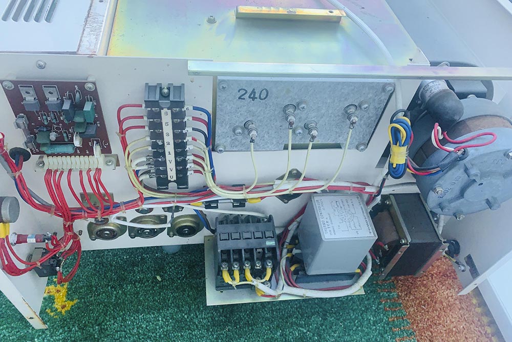

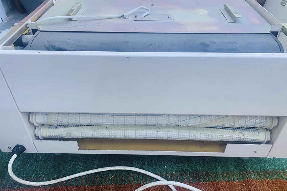

I work at a college and we have the same dryer. Our is broken and overheats and smokes whenever we use it. Do you have a service manual or any pointers on how to fix one of these?

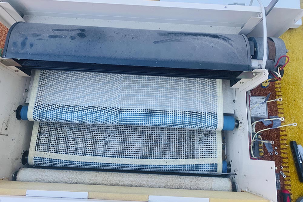

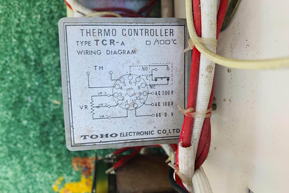

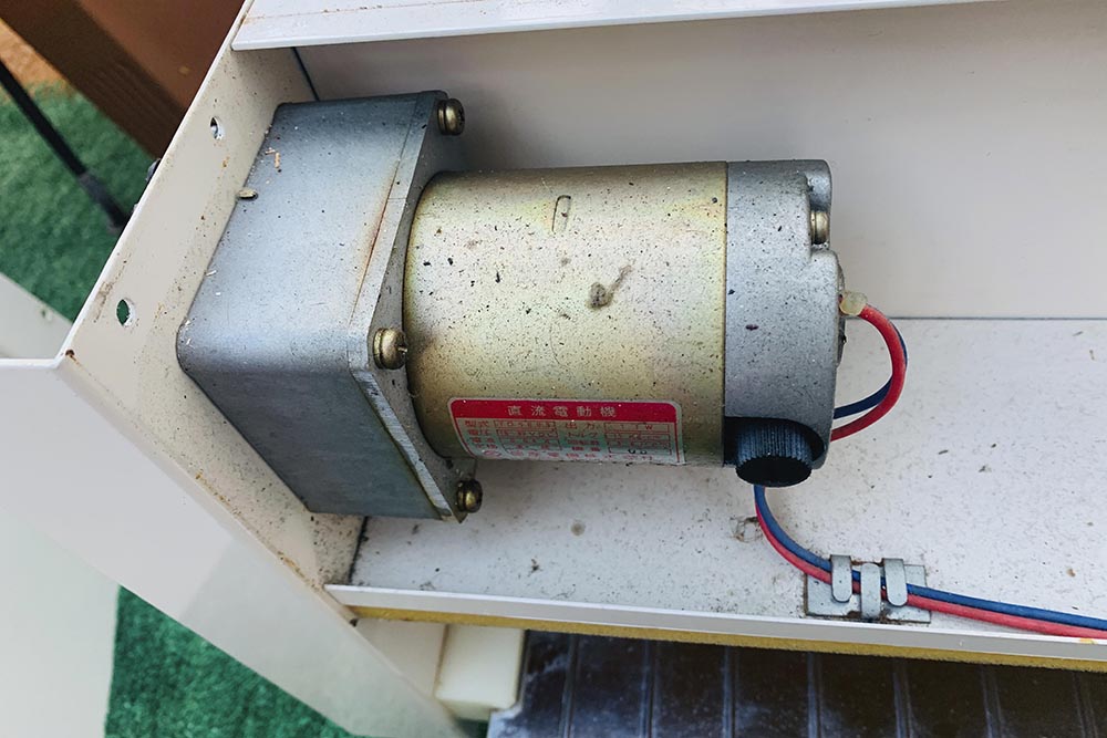

I was unable to find anything on line (or otherwise) however I would recommend giving it a strip down, (quite a simple job) and a clean out inside, there is likely an accumulation of dust & crud & dried out grease. Remove the outer panels, disconnect the heater, clean out the fan. decrease the interior & reassemble. Fire it up and see if it continues to smoke
IMG_4595 2.jpg IMG_4599.jpg IMG_4603.jpg IMG_4604.jpg IMG_4605.jpg IMG_4606.jpg IMG_4607.jpg IMG_4621.jpg IMG_4624.jpg IMG_4626.jpg
svenw
Sep 5, 2024
UK
View attachment 377819 View attachment 377820 View attachment 377821 View attachment 377822 View attachment 377823 View attachment 377824 View attachment 377825 View attachment 377826 View attachment 377827 View attachment 377828
That's really helpful, I appreciate your photos. Its a great reference for us. I noticed the bearings on two of the rollers have gunked up pretty bad and I dare say there is plenty of dust on the inside. I'll let you know if we can finally dry our prints or if I cause an evacuation 😂
