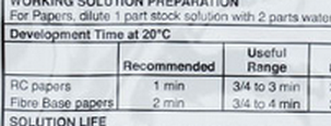

I've been under developing my fb prints, and was reading in some old posts here how development times of 4-7 minutes could result in deeper blacks (or, could fog the paper if it's overdone).
4-7 minutes ? :errm: Here's what it says on the Dektol package:
Instead of relying on old posts found somewhere on the interweb, you can easily find out for yourself with a one-time experiment. Do a stepped exposure (empty neg carrier, smallest aperture f/16 or 22) increasing exposure times in half-stop increments (5s, 7s, 10s, 14s, 20s, 28s...) Cut it in 4-5 strips perpendicular to the exposure bands. Mark them on the back. Develop them (with agitation) for 1', 1'30", 2', 2'30", 3', 4' (say, or whatever you think appropriate). Fix, wash, dry (hair dryer). Lay side by side, evaluate. Mix them, try to sort them without looking at back. Up to what dev time can you reliably see a change?
Then you have a valid answer to your question, using your paper, your developer, at your lab's temperature. Not some "advice" that someone made up ten years ago off the top of their head in front of their keyboard.
