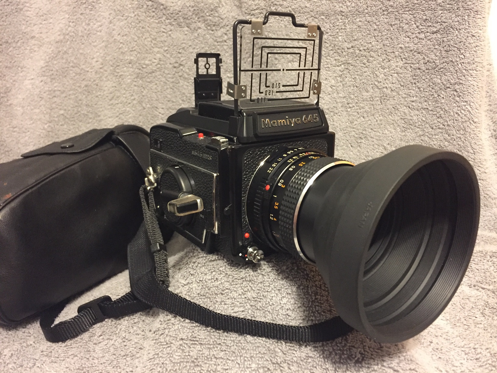

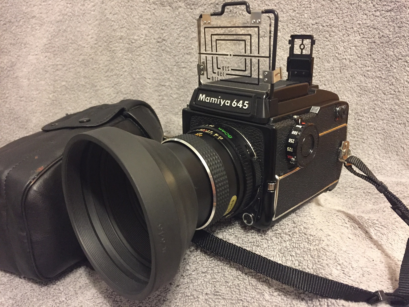

This camera was found in a local thrift shop in a large, plastic storage tub under a thick layer of newspaper that was, unfortunately, the nest and bathroom for several mice.
Disgusting, eh? :wink:
Luckily, the newspaper isolated the camera from the corrosion, but an Argus C3 Brick was not so lucky. It had literally dissolved in the mess the mice made. I estimate the camera was in the tub for about 20 years, as the other items in the tub suggest the prior owner brought it back from Japan while serving in the USAF.
It took a few days in the sun and a box of baking soda, but the smell has largely disappeared. I can now bring it up to my face without being nauseated! Always a plus...
Put a new battery in it today and it reacted favorably. Just awaiting a light seal and mirror foam kit from USCamera to bring it back online.
