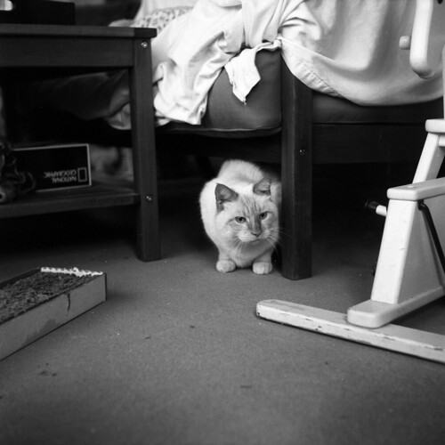

I'm kind of limited right now to what we have at school which is clayton f76 but I just did a roll of pxp in it and I'm very happy with the results.
Yes, I know they're all cats, but one of my cats was sick so I decided to shoot a roll of all my kitties just incase something happened to any of them. He's fine now thankfully.
