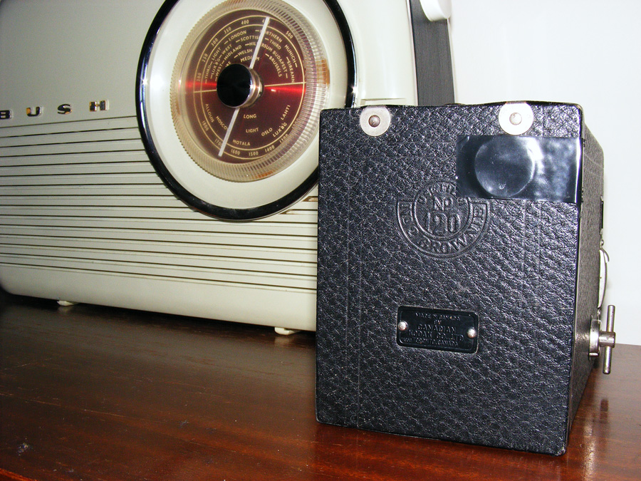

I currently have HP5+ in my Model No.2 Box Brownie. I put gaffer tape over the red window and only lift it when I wind on (see attachment).
