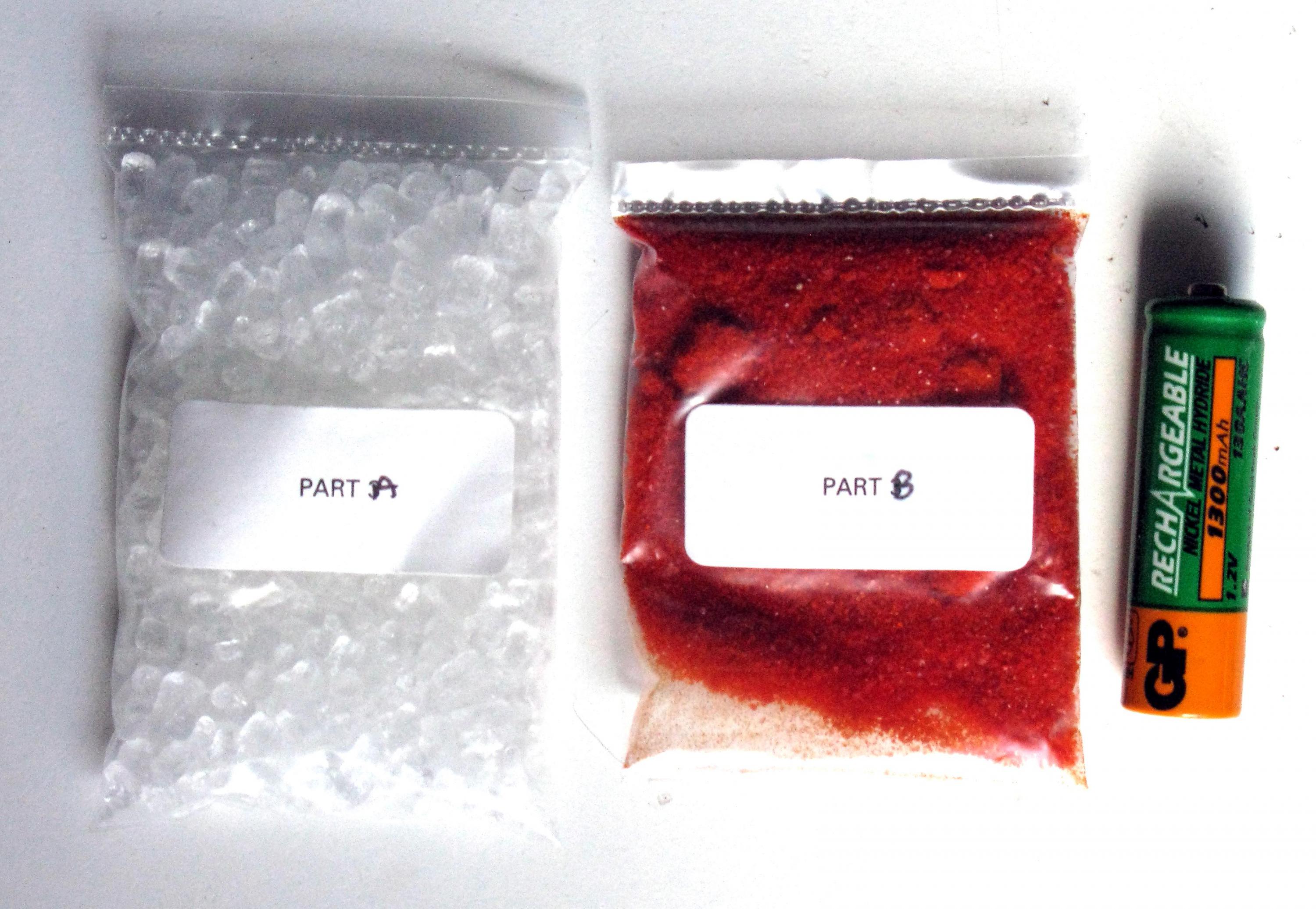

I have some negatives which are a bit too dense. I had just about written them off when I remembered that someone had given me a small packet of Farmer's Reducer which I might as well try.
Unfortunately, all that is in the box are a couple of packets- no instructions.
A web search found a couple of answers, unfortunately they differed. One said mix each packet with 145ml of water, the other said use 475ml.
I don't have any scales here to accurately weigh the packets but each powder is in a sealed plastic bag about 2" x 2.5" and the outer box is about 2.5" x 2.5" x 1.25".
Can anyone tell me what amount of water I need?

hi steve
i haven't made farmers reducer in a long long time.
when i had to reduce dichroic fog stained film paul krot at sprint systems of photography gave
a recipe for farmers reducer, from what i remember he said ...
get a 35mm film canister ( holds exactly the right amount )
fill it up with ( in your case ) packet B .. and 1L of water,
packet A ( yours ) is hypo/fix he said discard the fix packet and use your own fix
in my case it was sprint fix :smile: "film strength" and use that any fix will work as your second bath.
he also said to put the film in the solution B, don't agitate, and remove it every 10-15 seconds to see if
it reduced enough, you can always reduce more, but you can't do the opposite.
then fix, rewash &c ...

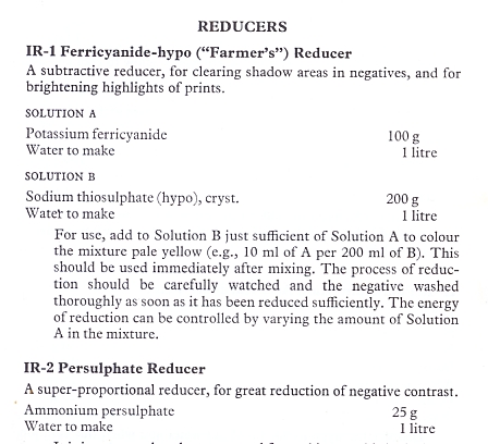

The standard Ilford mix is as follows - If you have kitchen scales they should show you roughly what you have - The red stuff is the ferricyanide and the white one is boring old hypo - Hang on a minute while I scan the right page
However, you should bear in mind that Farmer's will remove shadow detail more than highlights, so will effectively increase contrast - That is where proportional and super-proportional reducers come into play, but I have had very uneven results from these and often prefer to do battle with the neg as it is - Not that I admit to making less than perfect negatives

The formulas I have to hand (A. Adams, The Print) suggest 37.5g potassium ferricyanide in 500ml water (A) and 120g of sodium thiosulfate in another 500ml of water (B). Various dilutions are suggested, ranging from 3+3+100 to 3+12+1000 - From the few times I've used a Pot.Ferri. bleach, more dilute solutions are easier to work with. However, I favour a ferricyanide/bromide bleach as it gives the opportunity to redevelop if the bleaching goes too far. The neg can always be dunked in fixer at a later stage one the desired bleaching has been done.

Thanks.
Going by John's 35mm film canister to 1 litre of water method, I think I need to mix it with about half a litre.
I will give it a try.
Steve.

Mixed the red packet with 500ml of water and it appears to work very well.
I have only tried it on a scrap negative which I had in the solution for five minutes. It was probably a bit too long. My guess is that four would have been perfect.
Is it best to vary it with time or can a weaker dilution be used?
Steve.
