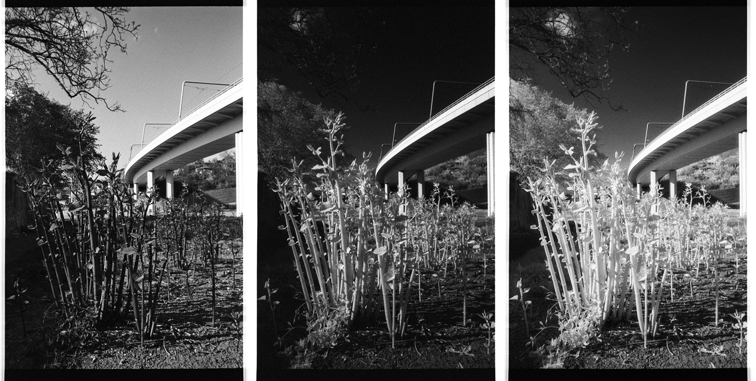

AFAIK the format doesn't matter as the same emulsion is just coated on different stock. Most films have near infrared sensitivity for what it's worth. What is important is how far the sensitivity extends. However you are not going yo see the Wood effect.
Gerald this is what I usually get when I expose Fomapan 400 through a Hoya R72. Isn't it the Wood effect? Left to right: no IR filter EI400, R72 EI6, R72 EI1.5.

Beautiful shot on the right. I'd like to do that! What is a R72? You exposed the film @Iso 1.5??
That's an infared filter from Hoya. I shot this at EI6 and gave two extra stops to get more shadow details. But that was for FP400 normal development, these days I shoot it at EI6 (with bracketing of course) and develop longer for more contrast.

The EIs referred to reflect compensation for the (very dark) R72 filter.
That filter cuts off most light below 720nm, which is right at the edge of the visible light-infra-red transition of the spectrum.
Filters like that are way easier to use with a RF or TLR than with an SLR :D
