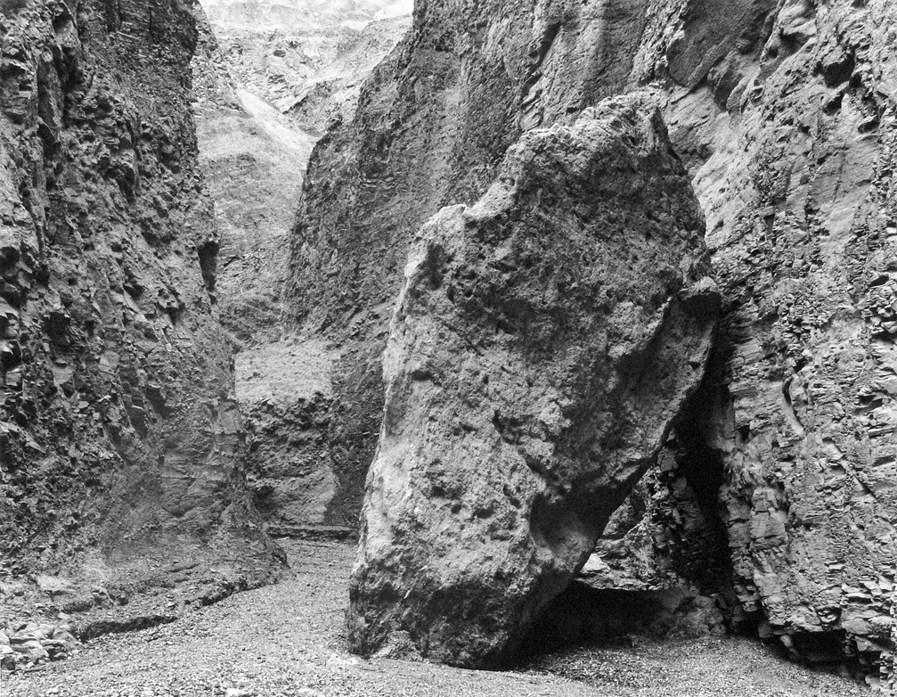

Or one goes thru some old negatives...25, 35 years old, and asks oneself, "Why have I never printed this? Don't remember taking it, but I reconize the place and the data is in my hand-writing on the negative sleeve. This is a great image! Did I lend my camera to someone?"
I was often disappointed with my negative after making the first work-print (16x20 from 4x5 negs). The scene would not sing to me. But one does not give up at that stage...I found that within a print or two, the image would start to come alive as I fine-tuned the exposure, contrast, and burning schedule (and maybe a little dodging, but rare)...reacquainting myself to what I remember seeing.
This is a 16x20 print -- a canyon in Death Valley. Those negatives back then (4x5, a lot of TMax100 and misc older films before that) did tend to be 'flat', and this one like most of them was printed on grade 3 Ilford Gallarie Glossy (or grade 3 Portriga Rapid III if I wanted a warm tone.) I liked aiming for this combination...since I was using graded paper, I could reduce the contrast some if I needed to by using Selectol-Soft.
