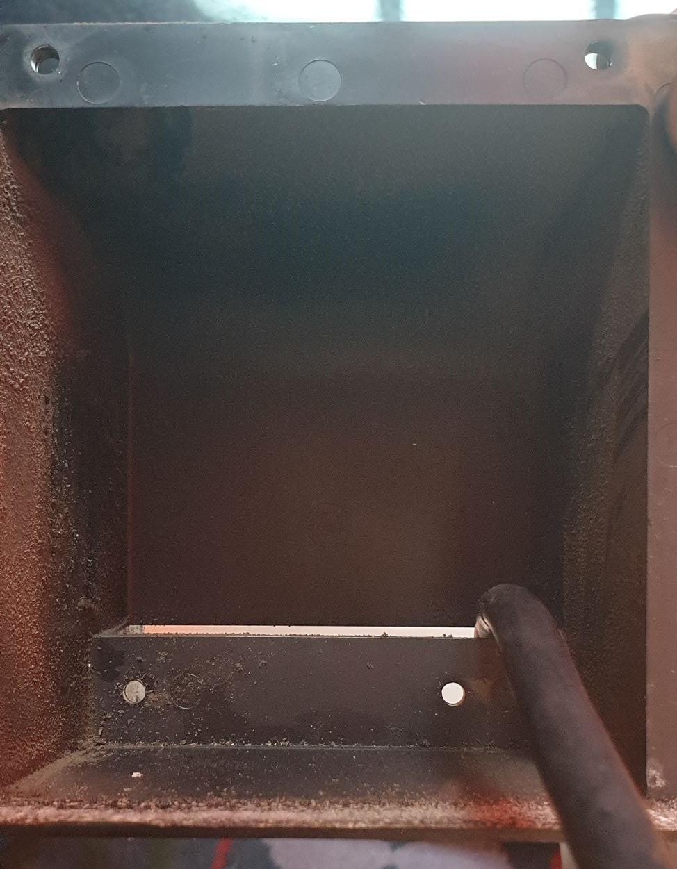

In fact there are 4 screws. 2 are a bit hiden when looking from the outside.
When looking inside the, already removed, box one can more clearly see the 4 screws. The hiden ones are at the bottom of the pic.

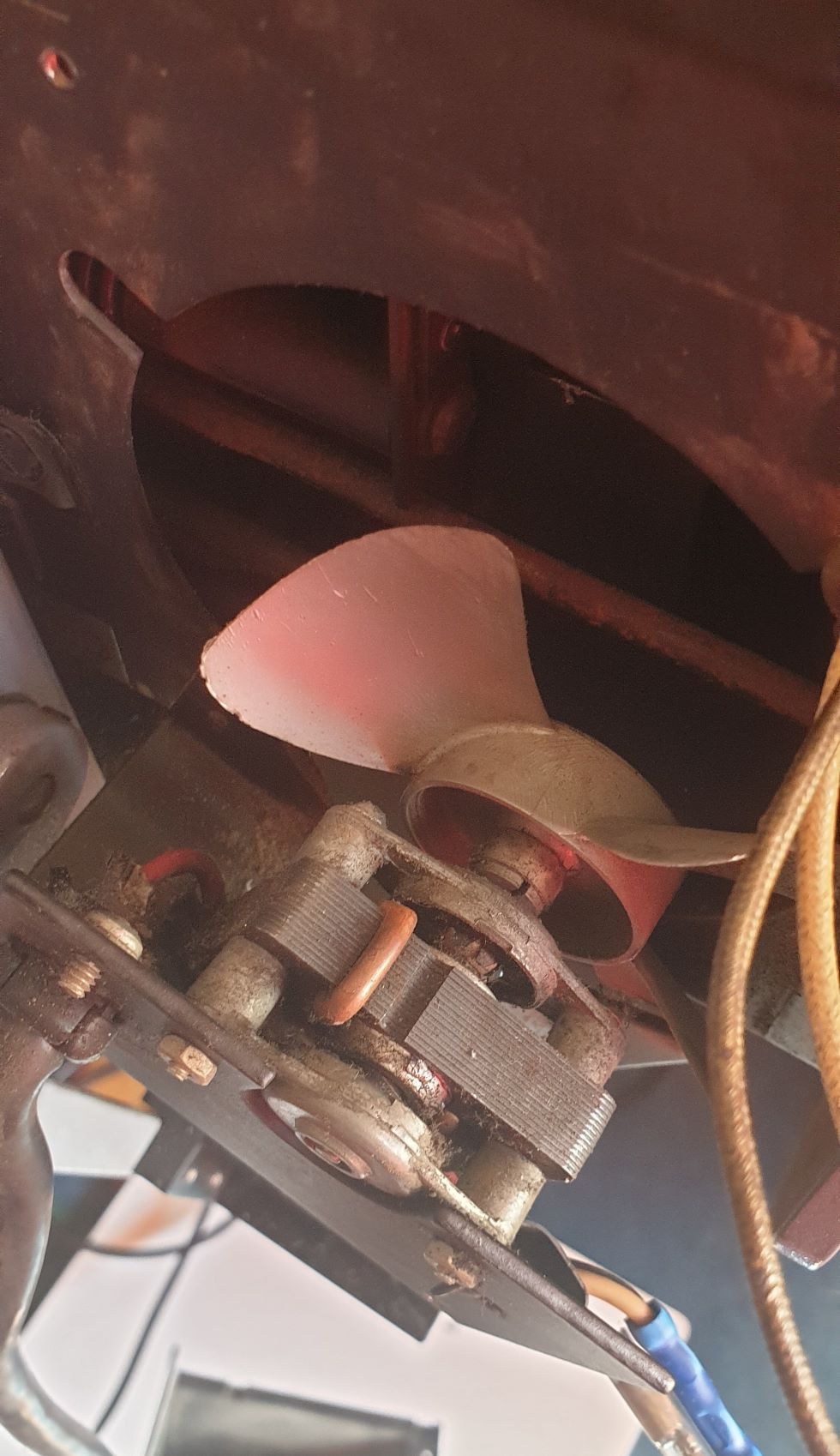

Now the funny part. I thought this was a fan like the ones in any laptop, but is seems to be an industrial thing.
Any idea would be much appreciated. Meanwhile during the operation the lamp stop working. No energy on the cables that link to the pin terminal.
Regards.
