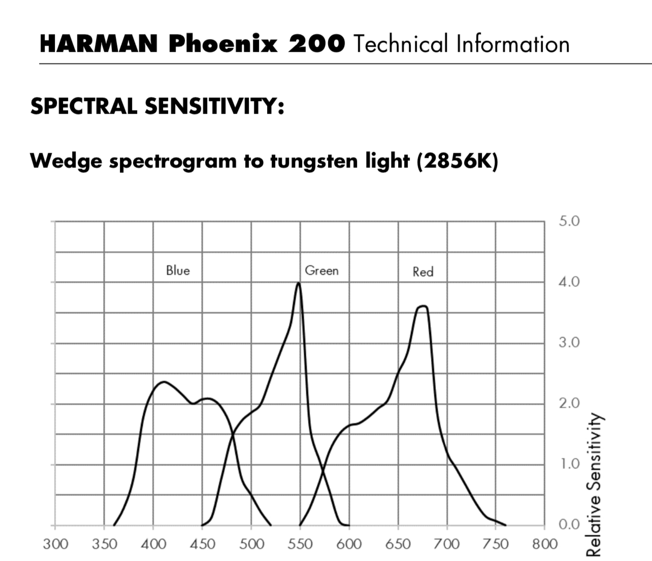

I noticed Harman Phoenix 200 has extended red sensitivity past 700nm and a relatively high peak at around the 665-685 range.
Theoretically, with about a 680nm filter or something like a ZWB3 filter, would it be possible to take false color infrared photos with this film stock? Maybe even 720nm and long exposure times?
The scans would definitely need to be white balanced afterwords.
I know the graphs is for tungsten, not sure how much this affects the values for daylight or if it’s negligible.
What do you think, is it worth a shot to try?
No. What you could do is use a 680nm filter and obtain a totally red image, but it won't be anything resembling a false color 'IR' photograph. The red exposure will only create cyan dye, so there will only be one color in the final image. It will not be much different than any other color film (negative or positive) shot through a deep red filter.
For false color IR you need wavelength shifting; so longer wavelength captured light needs to be converted into a color that corresponds to a different wavelength in the spectrum. That's what e.g. Kodak HIE did. Basically, it would capture IR and show it as red, capture red and show it as green etc. That's a bit of a simplistic way to put it, but it's the basic principle of how the stuff worked. It relies on the fact that the sensitizing dye (which determines the layer's spectral sensitivity) and the dye coupler (which controls the color of the dye generated during processing) are distinct aspects of the emulsion and can be chosen in separation from each other. Harman Phoenix is no different from any other regular color negative film in this regard.
