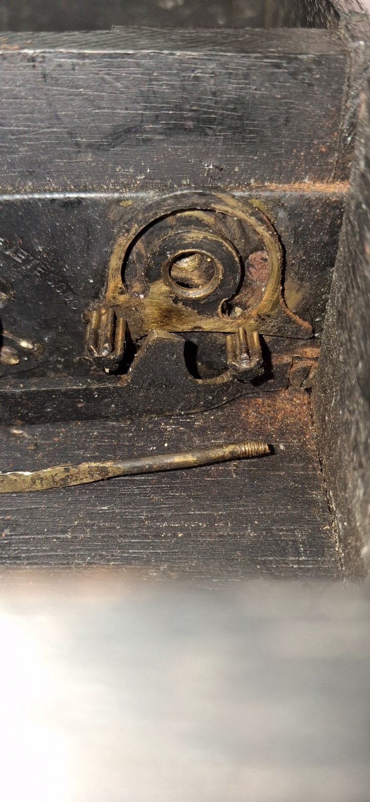

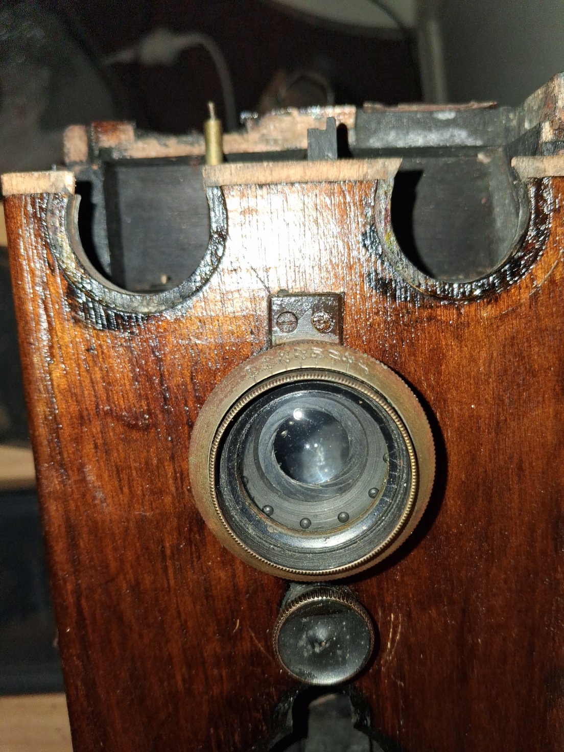

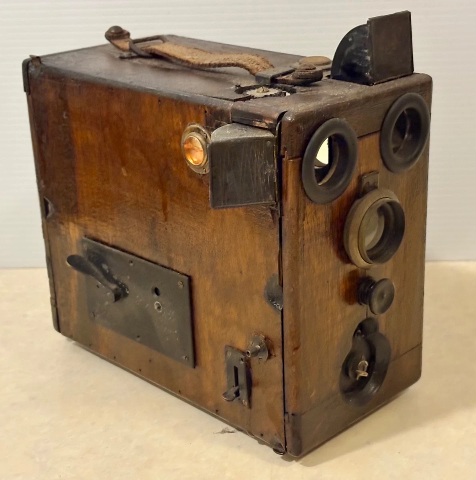

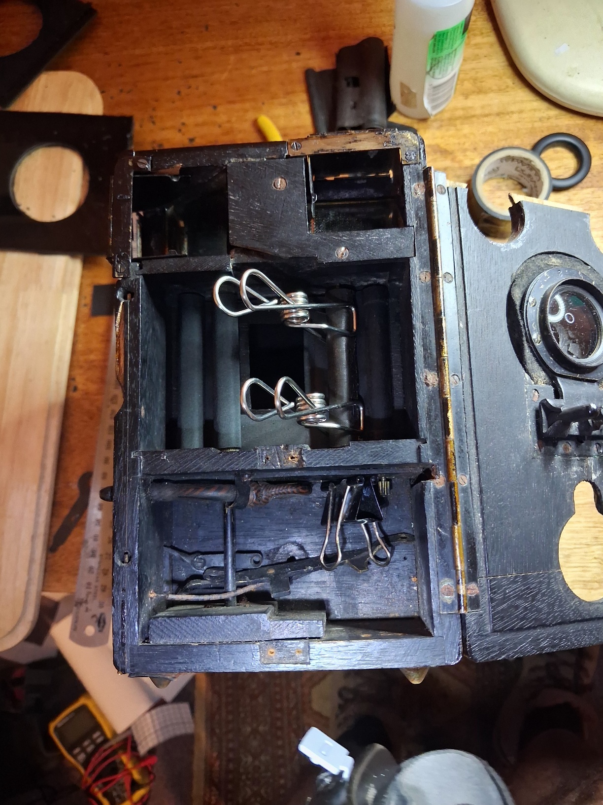

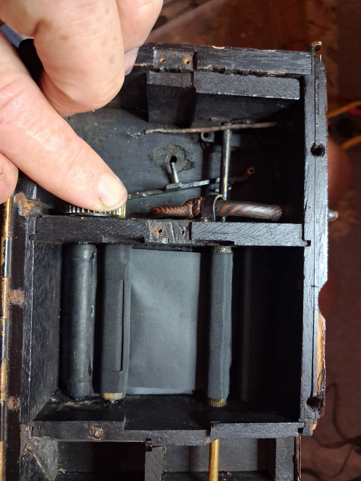

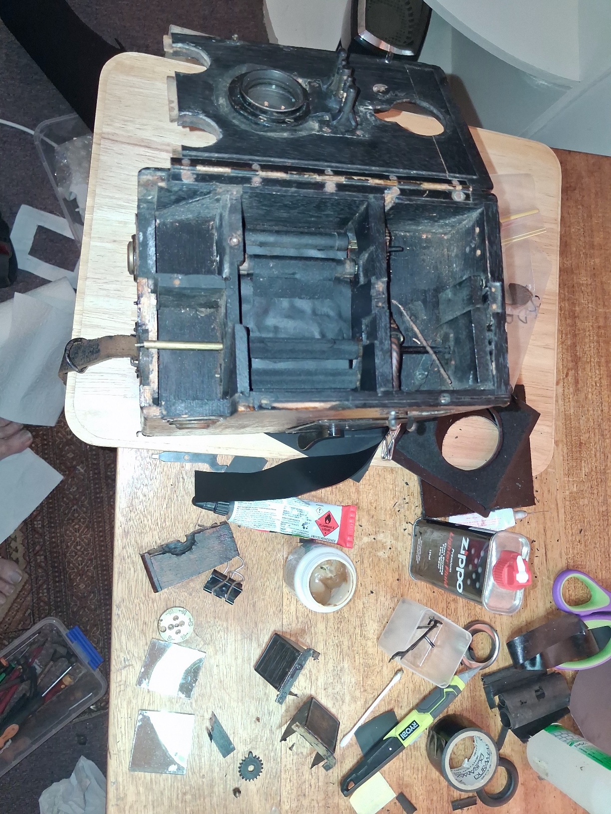

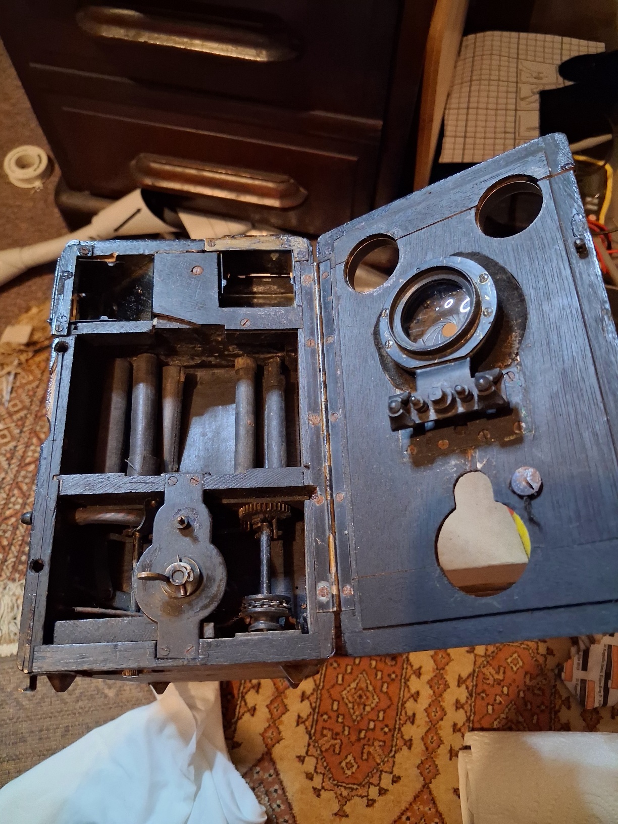

Picked up a sad looking old box camera the other day. The original leatherette had been removed, but apart from that most of it seems intact. Nothing worked of cause and the curtains had disintegrated.

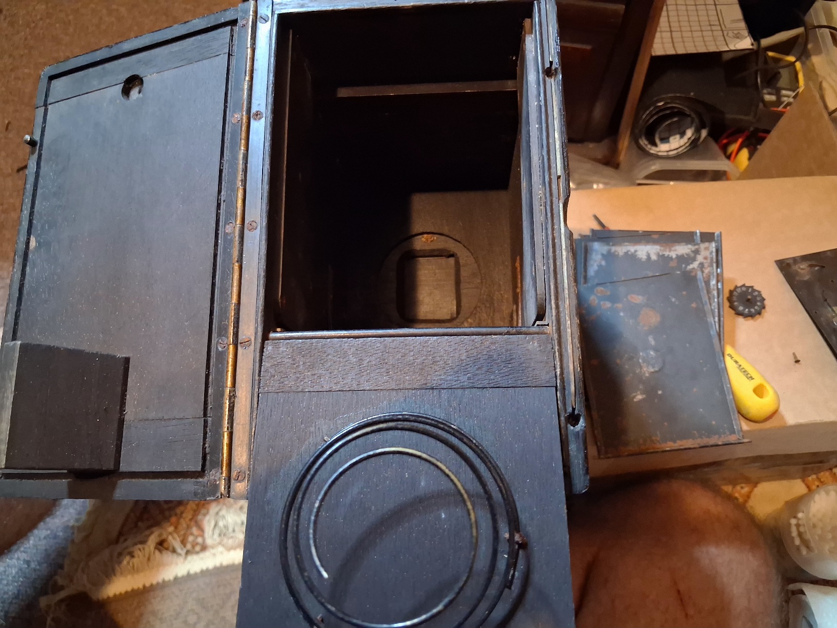

Managed to get the folding plate mechanism working, even had 5 plates.
Nice lens, zone focus f8 to f64.

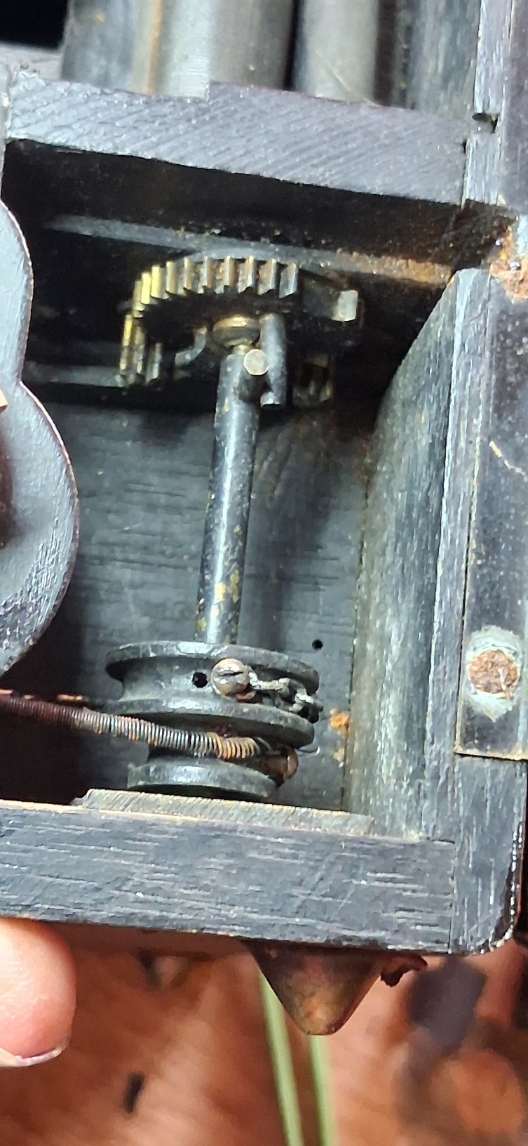

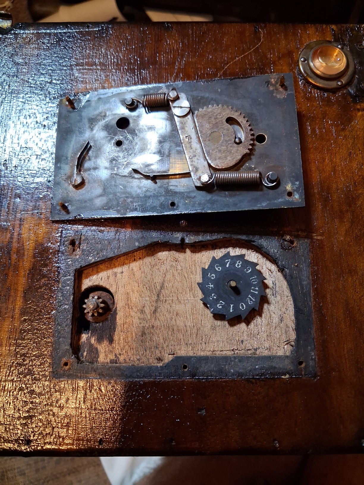

Interesting shutter, twin curtains, winding mechanism that looks like something out of a medieval torture chamber and a little bulb for the buld.

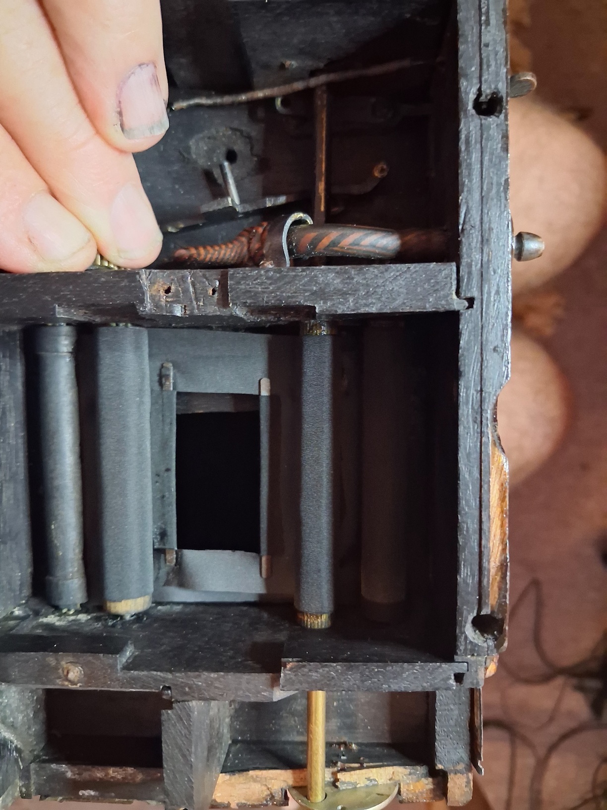

I'm still sorting out the curtains as I don't know the size of the window it's a bit of trial and error.
Up to ordering some tiny screws as all of the originals are beyond reusing.
Anyway can't find any information on the internet, there's no maker markings except for a French patent mark on the shutter mechanism. Anyone seen one like it? Knowing the curtain size would be a great help.

It's a beauty and a worthwhile project.
John Wiegerink
May 29, 2009
4,201
Lake Station, MI
That should keep you out of trouble for a loooooooong time. I have a couple Cyclone 4X5 falling-plate cameras I restored to working condition and love to use them, but they are far less complicated than the project you have on your table for sure.
Don_ih
Jan 24, 2021
8,713
Ontario
It's like a mechanical puzzle. Good luck! Gives you something to do.
Tel
May 9, 2011
1,046
New Jersey
Looks like most or all of the parts are there and remarkably free of rust and corrosion. I'll bet you get it working and have a lot of fun doing it!
