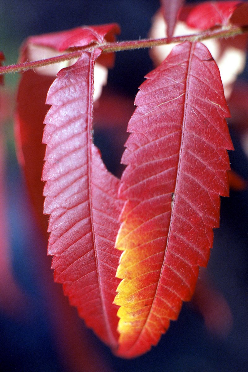

I just wanted to follow up on this. I've gotten two rolls of Ektar back now, and I'm smitten.
I'm not sure if I'm going to buy slide film again after this. Ektar is cheaper, scans easily (my V600 can't resolve the grain), the prints are amazingly vibrant, and I don't need a viewer/projector to enjoy the final product. Nicer colour than the Rollei 200 slides I shot in the spring too. Definitely too strong for some things, but thats what I buy porta for. The only downside: blue shadows are pretty pronounced in a lot of my shots.
I'm pleased with this scan, but it looks even better in print. I'll probably get this blown up to 8x12 on metallic paper. For reference, this was shot with an OM40, Zuiko 50mm 1.4 and a 25mm macro tube.
