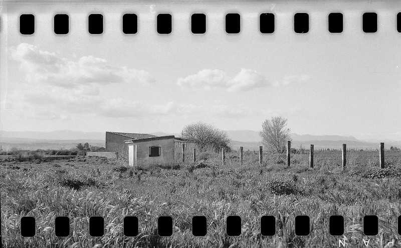

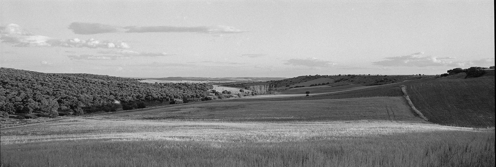

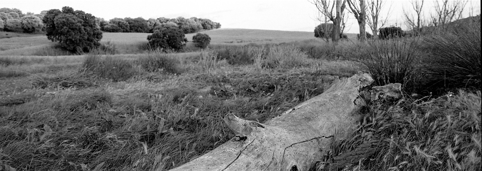

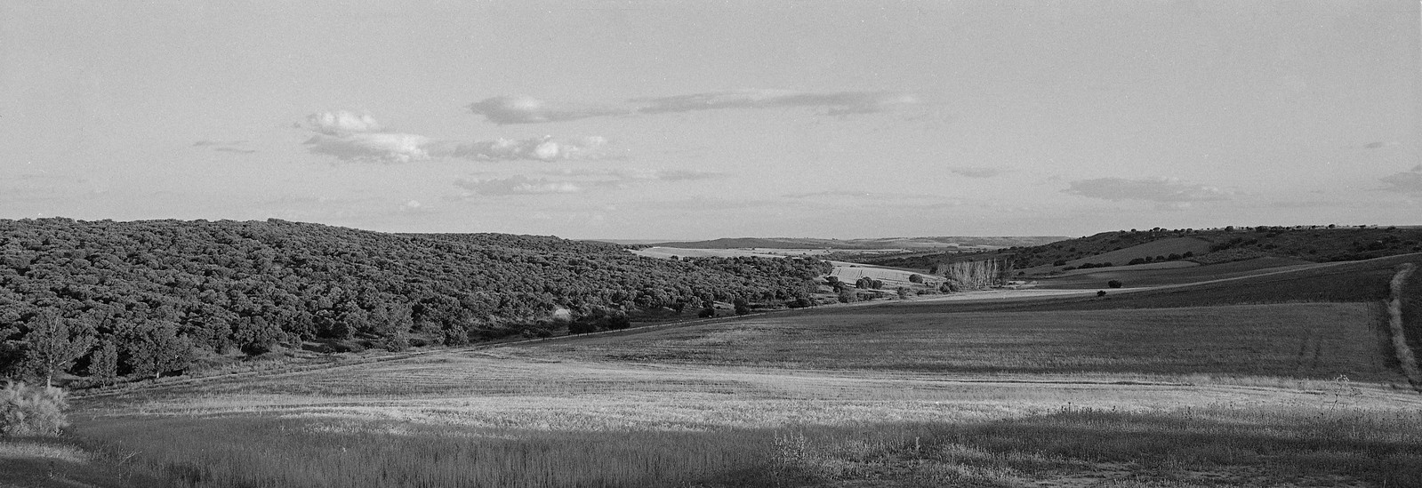

and I'd like to share my experience with FAK 135 adapter.
I've used it before but I lost it ... yes, fortunately I've found it in one of the drawers of the kitchen !!! Hahahaha
I've test it again with Pentax 6x7 MLU and the SMC 67 45/4 lens. A kind of xpan wannabe.
I'm very happy with the results. Of course they could be much better. I need some mask to frame the view according to the format (24x70cm). I also need to find out why I've got scratches in some pics. I remember that this happened me the first time I used a couple of years ago (or more)But I was able to solve it... I don't remember how ;-)
For these pics a used the waist-level viewfinder. It's spectacular.
Pentax 6x7 : SMC Pentax 67 45mm f/4 -- FAK 135 to 120 adapter
HP5 : ID 76 1+1

What do you think?
Any experiences (since January)?
