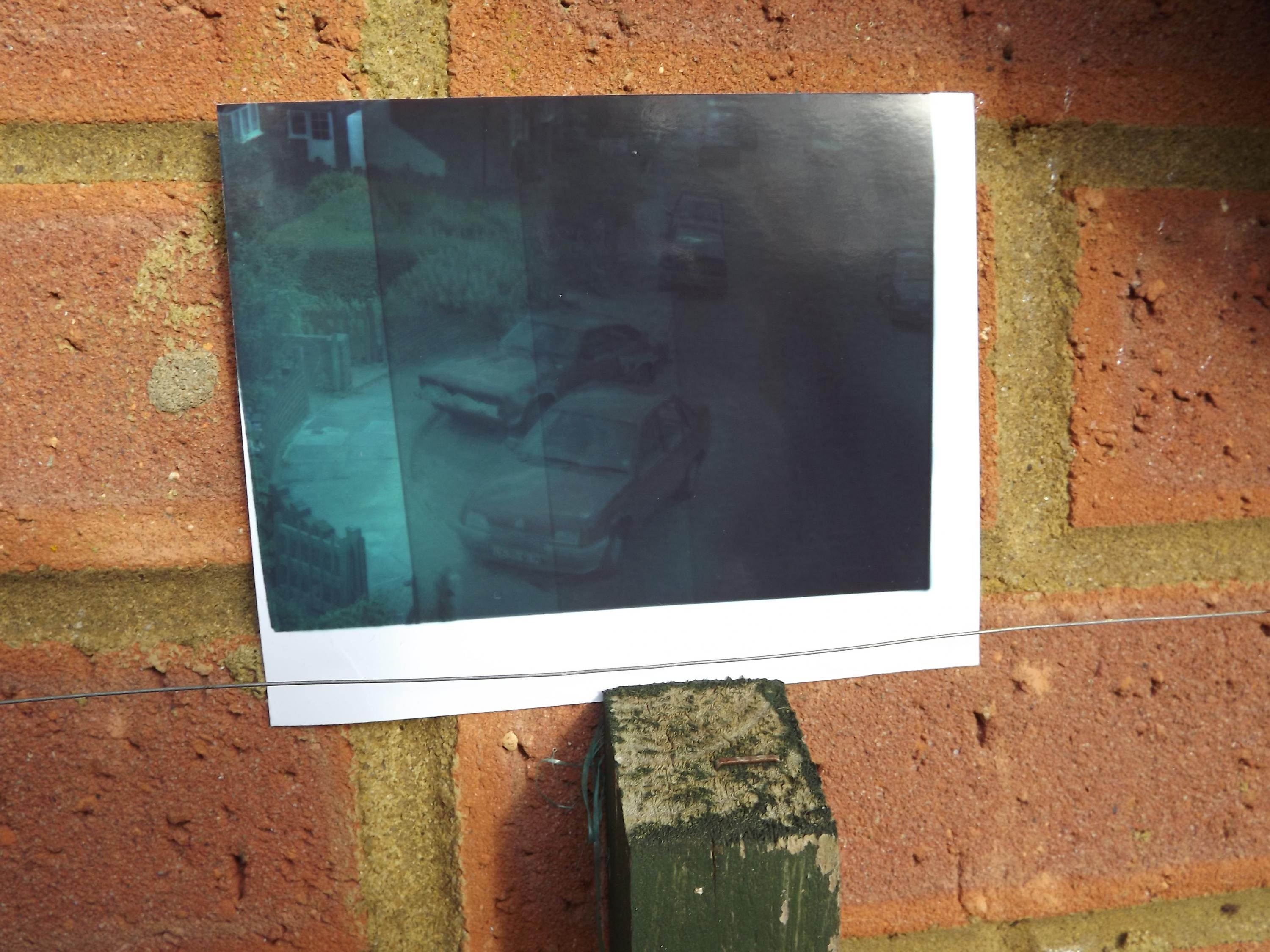

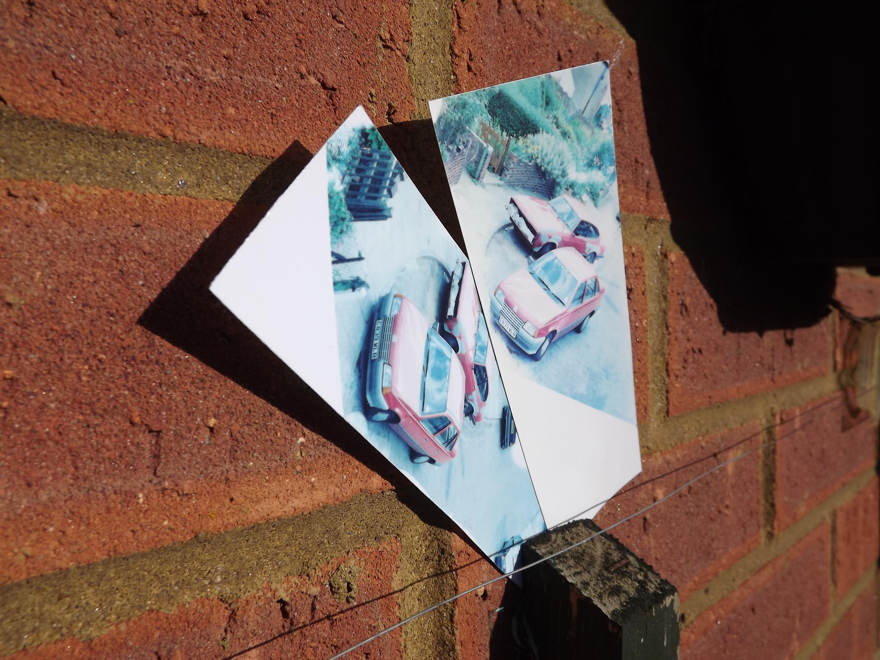

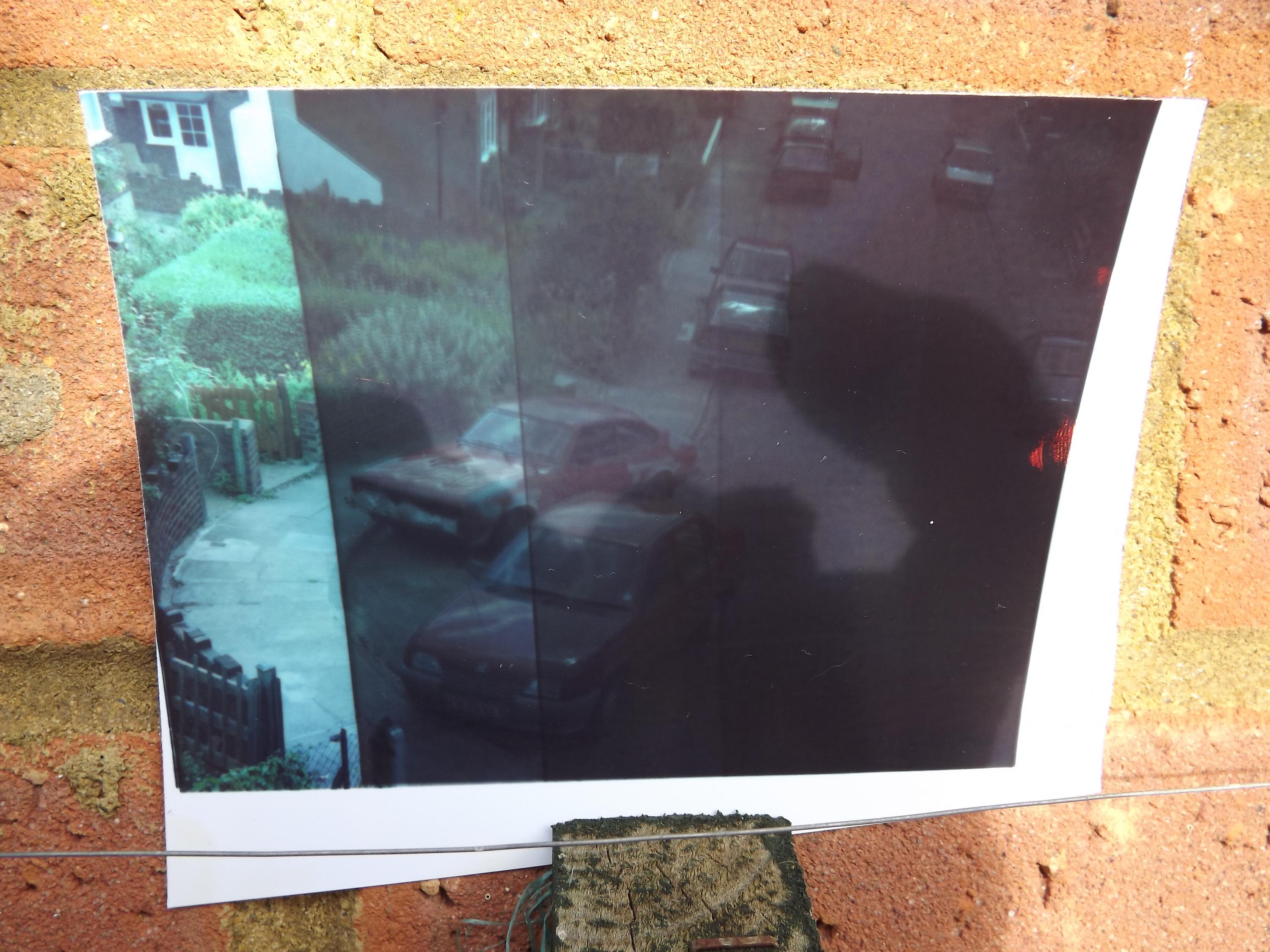

Hi Everyone,
This test strip is done at fstop 8 with 2 sec intervals. I think I have the density better but the colour is ver Blueish. What do I ad or minus to get rid of the blue?.

Between the 1st use and the 2nd are you maintaining the temperature. It will be surprising how quickly small quantities of developer cool down. RA4 developer will be quick acting, thats the nature of the beast. if the exposure is correct, an image will appear around 10-15 seconds and be fully complete at 45 seconds. The last 10 seconds will be very slow.
You do not have to worry too much about the stop bath and blix, they can be shortened if the temp is over 35 degrees or extended if it is below without to much problem. They are not critical.

STOP! The 2 sec strips looks okayish, but you are still processing for 30 sec? Then you are still overexposing and pulling development (see my post above)! It makes no sense to play around with filtration before you have established the correct exposure time and especially when you are pulling development.
Try 2 sec at f8, f16 and another one with 2 sec at f22 (if you are enlarger lens allows) AND give full development (45 sec at 35C) and see the results. As soon as you have determined correct exposure we will look at the color balance.

If you can get a hold of a set of Kodak colour printing filters they will help. These are not for use with the enlarger but a guide to what any filtration alteration is needed. It gives advice how you change, shall we say by adding or subtracting the other filters in proportion. There are also multiplication factors to add or subtract times when changing the filtration. As you are using FUJI paper as opposed to Kodak they will not be accurate but they are a good guide. I don't think they are available new, but as you are in UK get in touch with 'Second Hand Darkroom Supplies' and I know they have them used but generally in good condition for about £5-£10. Their 'phone number is 01993 878323. What to ask for is:- A Kodak Colour print viewing filter set.
It is also essential before assessing any filtration changes when looking at a print, that you must do so when the print is completely dry. When a print is wet there will be a blue cast, especially in the shadows which can give a false reading. My method is to wipe the test print to remove all surface water, then dry it with a hair dryer.

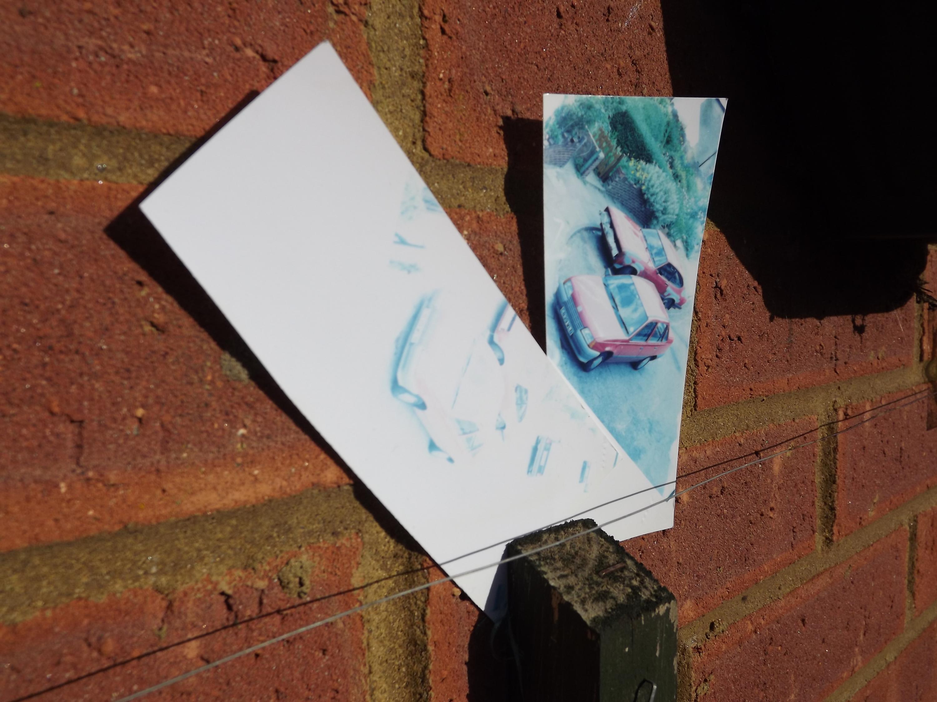

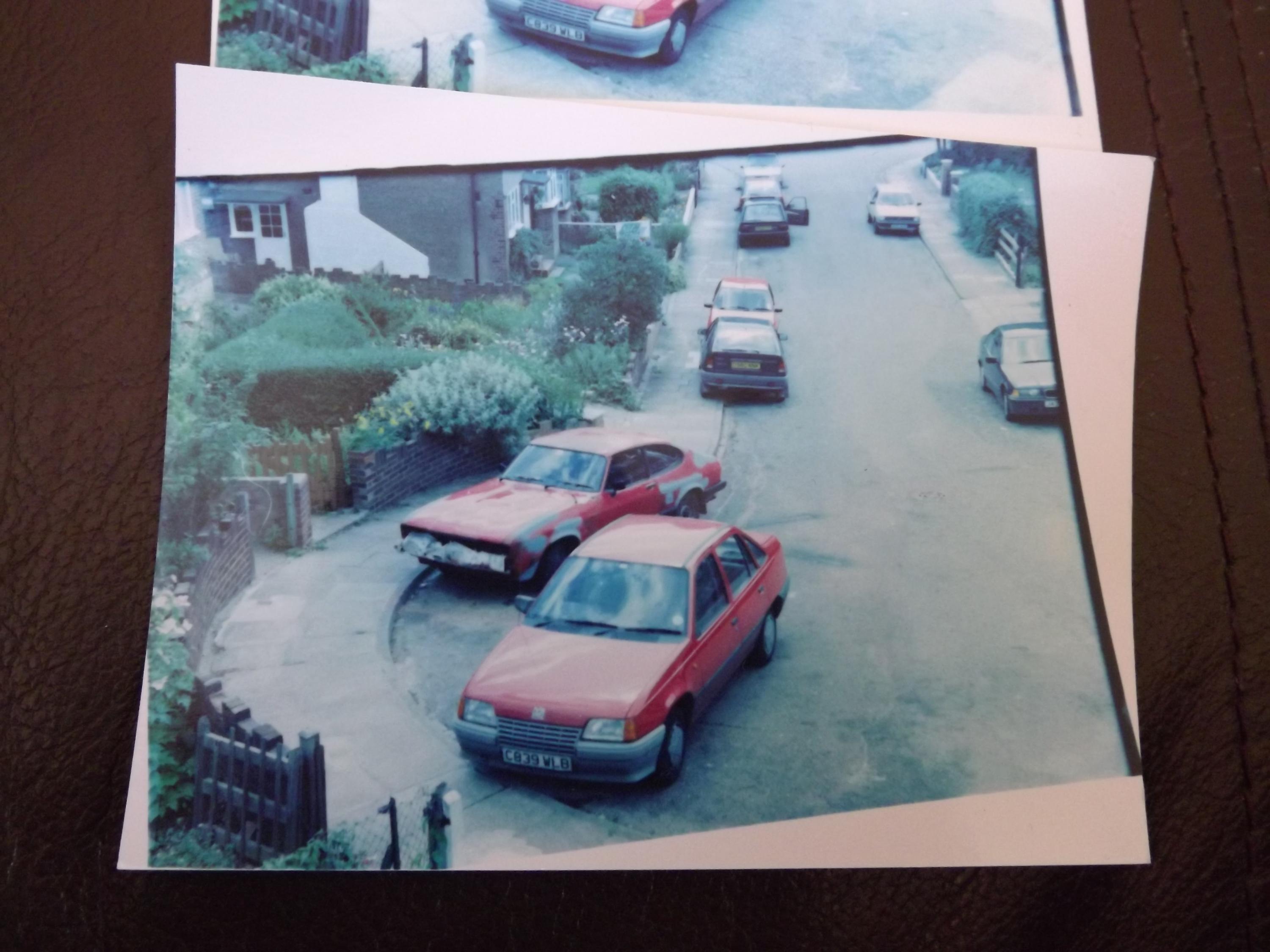

The trays I was using are gravel trays from the garden, I think most likely that my daughter had used them for her B+W photography and not cleaned them properly. I should have washed them before use. I'll try giving them a clean with washing up liquid. I will invest in some proper trays when funds allow.
I managed to do a few prints at 35c. First print was at f16 for 2 secs with 45 secs developing, came out faint so I did exact same with f11 setting. I did a few more prints on the same settings. I need to make sure I wash the orbiter lid properly. I take it the splodges are from cross contamination.

It is still difficult to say what you need to do to get to a really decent print. Showing small strips against a large brick wall doesn't help. Can you show just a thumbnail of each print instead or better still the test strips at each print exposure. It will be easier to see which one looks correctly exposed.
As things stand it looks still looks under-exposed assuming that dev time and temp are correct and I'd try PE suggestion on filtration as well. There is what looks to be a cyanish cast still here.

The chemicals and paper are fine, I didn't think they would be stale as you were out of stock when I ordered and awaiting new stock. But next time I will go for the Kodak RA4 kit as its better value I think in the long run. But it would help if there were manufactured dates on the bottles. A bit like no dates on rubber tyres! I found the problem was contamination from the trays I was using.
