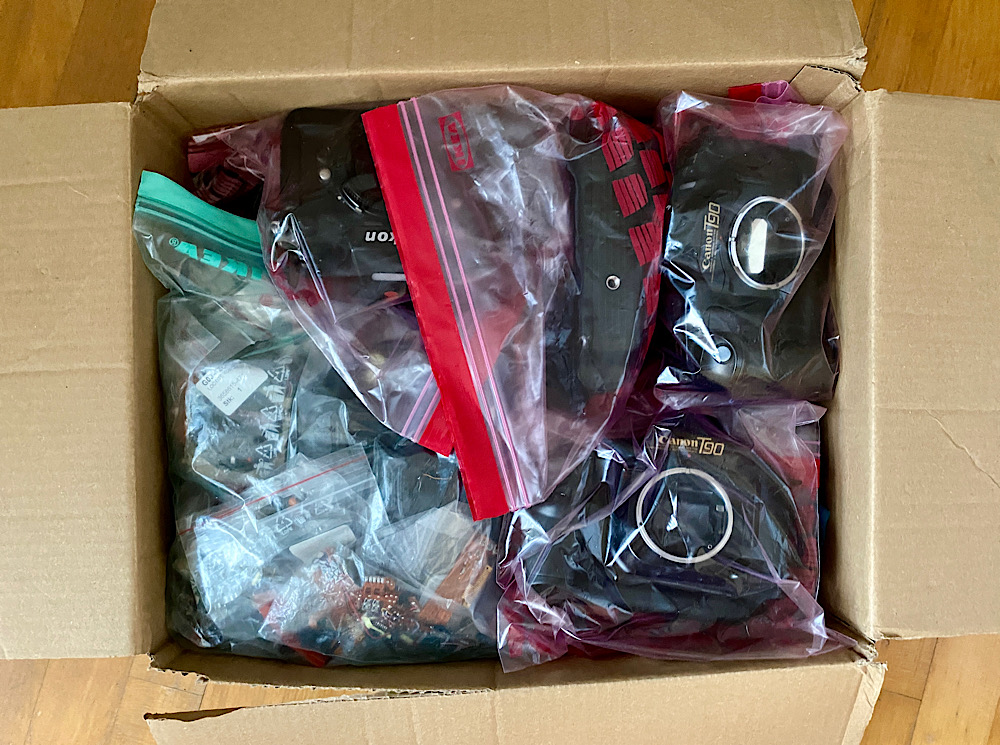

That's right, because when I open it …
… there are lenses and cameras in there that I couldn't repair.
So it is a final resting place for spare parts donors.
The question now is why the repairs were not successful. Was it a lack of ability, overconfidence, mistake, sloppiness or just bad luck? Here you should be honest with yourself so that you don't have to buy a second box because the first one is already full.
To be more precise, I have to be honest with myself here, because it's my box 😇
Let's take a look at what, among other things, failed repair projects are in the box. And I will answer honestly what were the reasons for the failure. At least as best as I can.

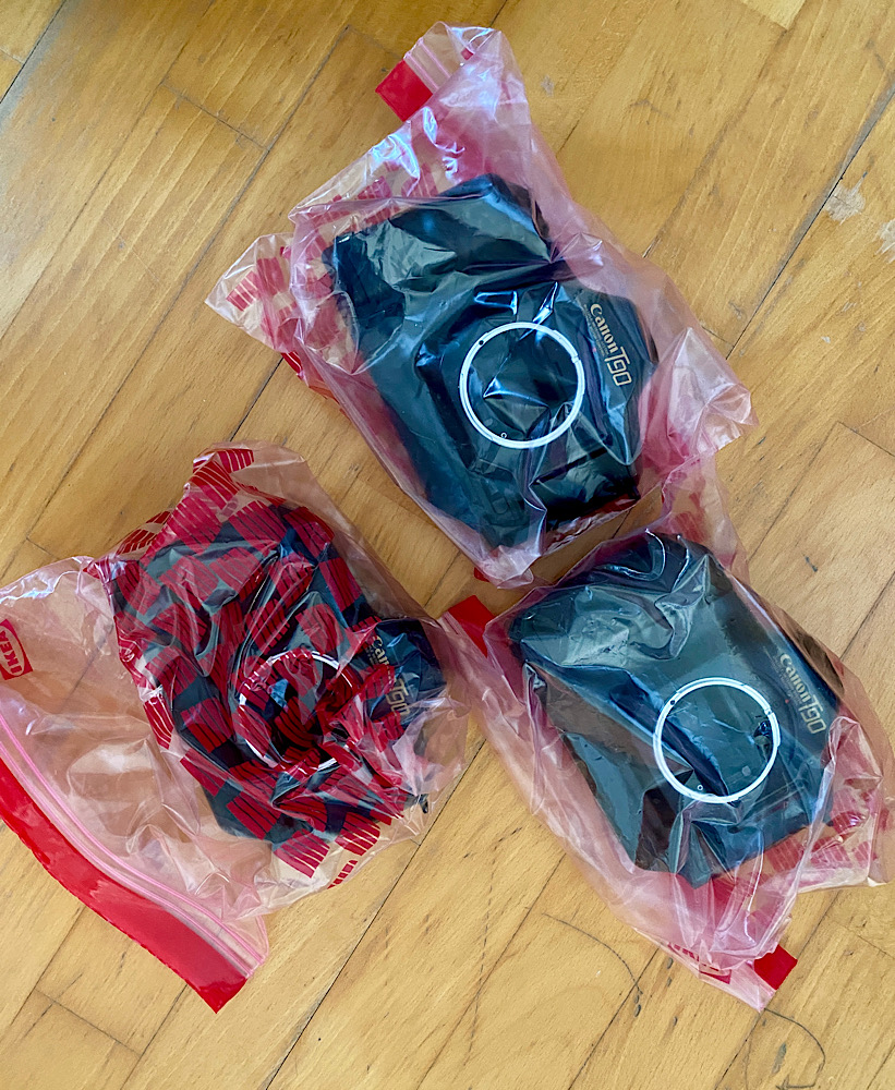

3 x Canon T90
All three show EEE on the display and HELP in the viewfinder. I suspect problems with the two locking magnets that I can't get to. I could try it, but it's too much work for me because I would have to massively disassemble the camera and then reassemble it. The risk of success is therefore high.
And what do I do with the magnets once I have uncovered them? And what if it's not the magnets?
Lack of courage? Or reason?

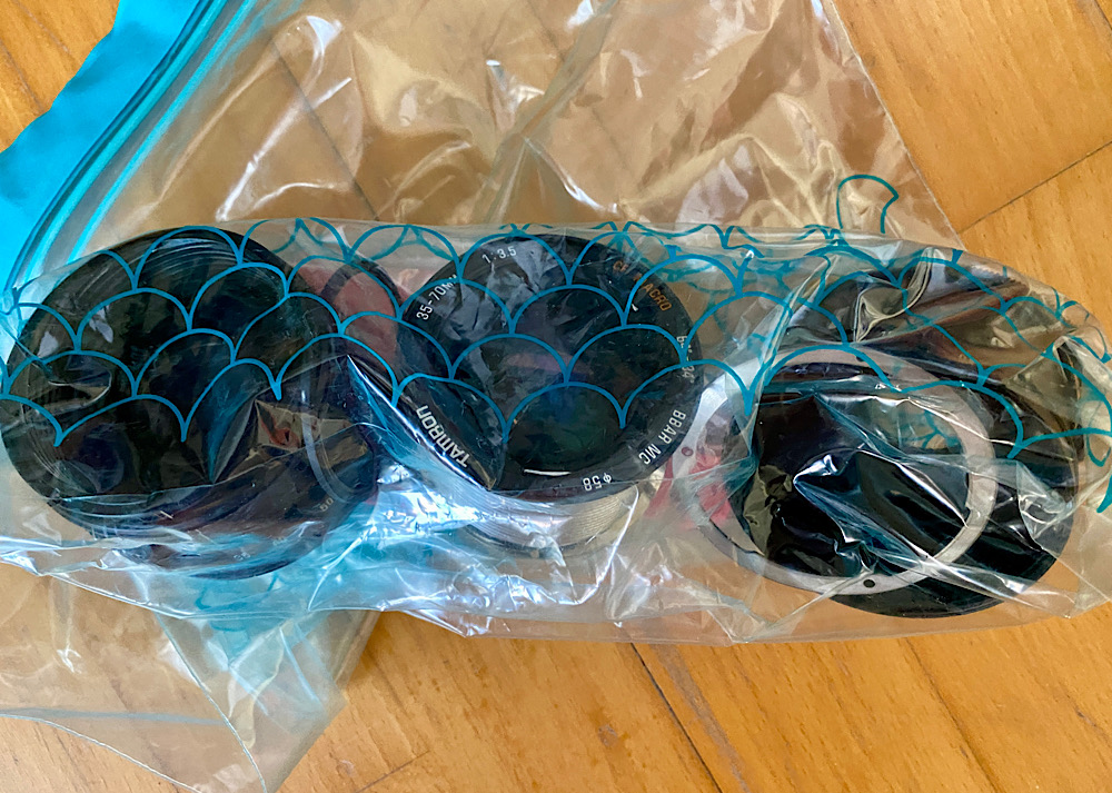

Tamron 35-70/3.5, Adaptall-2
One of Tamron's best non-SP lenses.
I was able to clean the optics, but then failed because of broken plain bearings and screws inside that I couldn't loosen.
For the plain bearings in the zoom mechanism, I could have found replacements from other lenses or asked other repairers about them. The screws would certainly have been tamed if I had better mechanical knowledge and skills.
Convenience? Incompetence?

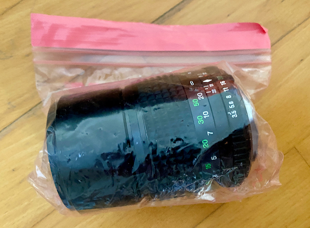

Tokina RMC Tele-Auto 135/2.8
The aperture blades only ran in slow motion. So I opened the beautiful lens and ended up with a swarm of loose and small ball bearing balls that I couldn't fit anymore.
Bad luck? Carelessness?

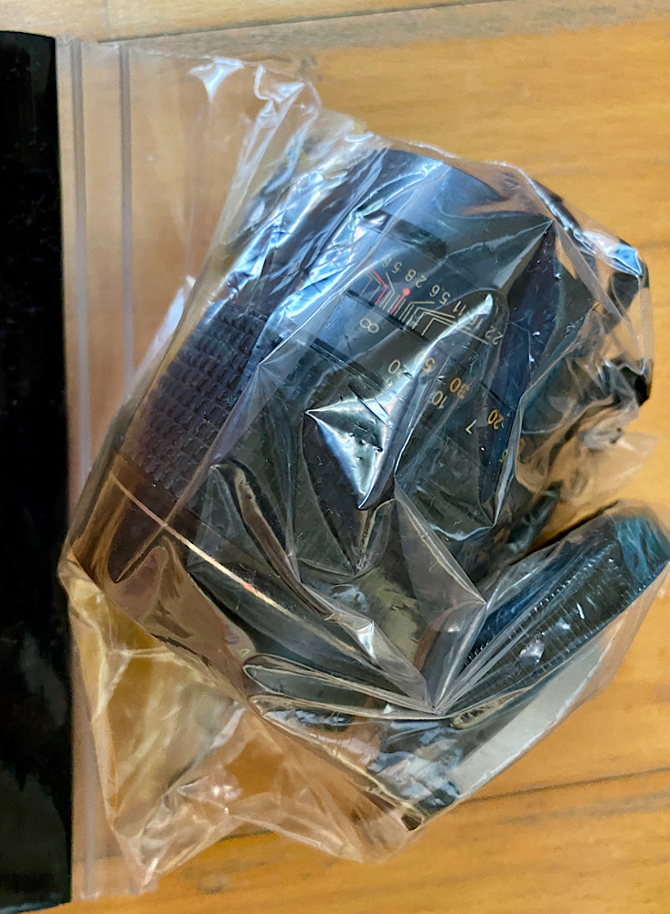

Minolta MD 135/3.5 (II)
The telephoto lens had fungal growth on one of the front lenses, which I was able to remove and had not yet etched the glass. While cleaning, I scratched one of the lenses because I didn't realize that the bottom of it was soft. I haven't had that yet.
Bad luck, I would say.
Or should I have informed myself better beforehand?

Just fixed my T90 with flashing cursor error. Not too difficult at all. Did a YT to add to the many already on there. Mine is VERY clear and features my Siamese cat!
Niglyn
Feb 26, 2022
469
Surrey, UK
Analog
I would love a scrap T90. Want to dig down to this pesky release magnet, to see exactly what it is and if it can be repaired.
There are bodgy repairs, where a magnetised screwdriver is poked down to the magnet & then they work for a while.
Maybe the core just needs re-magnetising, or what it mates to needs de-magnetising. Both easy.
Alas, even scrap T90 still sell for expensive prices, so I have not been able to obtain one.
