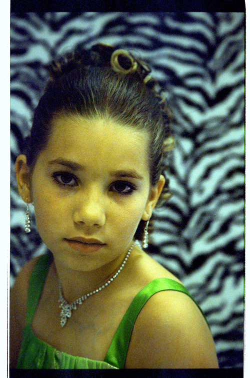

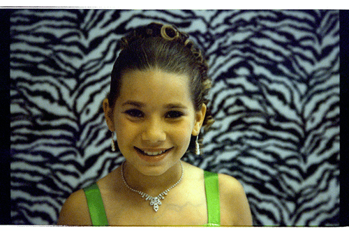

Now, I've pushed Portra 400 before, never with push processing though. So I shot a roll at 1600, no ev adjustment, just Aperture priority. Then processed for 3:45 (pushed one stop) and now the results, grainy, very horrible.
I have another roll ready to process done on the same day. Should I try to push it more or less, kinda of at a loss as to why this is not working for me.

The grain ain't too bad. I'd be more worried about the green skin.
What were the results when you underexposed but didn't push-process? Maybe if they were OK go with that.

It looks like the blue layer has completely failed to expose there, or you've scanned it badly.
I see all these "Portra at 1600 is great" posts, but frankly they all look pretty bad (no dynamic range, bad colour, washed-out, tinted shadows) to me compared to Portra at 400. Sure, there's an image, but it doesn't mean the film achieved that speed or that it looks good.

Don't forget that when you "push" or process c41 for longer than recommended time that you are playing with color balance.
The separate color layers will develop to a density that it wasn't designed for.

Just to be clear pushing is a development thing, not an exposure thing.
Shooting a 400 speed film at 1600 is simply a 2-stop underexposure, nothing more. The bottom 2-stops of shadow detail that the film would normally have caught at 400 is sacrificed/given away to get 2-stops of aperture for DOF control or 2-stops of speed to avoid a blur.
Pushing increases the separation of what is caught but can't create shadow detail out of thin air. A 1-stop push might save 1/3-stop of those 2-lost stops. A 2-stop push maybe 1/2 to 2/3 of a stop.

When I print this type of photo or scan it, I give it a touch of color correction. This one needed a tad over what the normal scanning would give. On easel, I would have added a touch of red to eliminate the greenish cast.
Nothing wrong with the photo at all given what you did.

I had a go at pushing to 3200, and noticed that the shots that were exposed correctly for 3200 came out none too bad, but the ones that were already underexposed at 3200 had a very green tinge.
In that experiment, I developed the film for 1600 (2 stop push rather than 3), so seems like 2 stops off = green tinge ?

It depends a lot on color correction introduced during printing and / or during scanning. See my repost of one of the original photos.

I'm gunna try the next roll at 2 full stops pushed. I also forgot, I was shooting daylight film in a gym at a school, so my colors will definately be off.

Portra 400 rated at 1600, correctly treated is great at N+2 development, and still very nice at N development, N+1 development wouldn't be a problem here, the OP has done something wrong to get such poor results.
OP; how did you develop? Stable temp? Re-used tetenal where 3:45 doesn't become a push? The image looks heavily abused, and judging by the histogram that's full of spikes and gaps and exaggerated noise and grain looks like you had a thin ranged image with over-sharpening that's also looks like it's been improperly developed.
