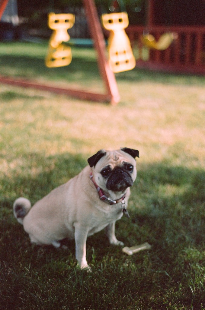

I think that my new FA is focusing too close. The focusing screen looks OK, and the back and pressure plate seem fine. The mirror also looks OK, and the focusing screen is where it should be with the spring engaging it. It seems that if this is happening, then the film is either sitting too far back (which would require the pressure plate to be loose or something), or the focusing screen is too far down, which doesn't seem to be the case either.
This is off the first roll. It's with a 50mm E-Series that never gave me problems before. It's wide open, so no focus shifts, and this lens doesn't have a reputation of doing that anyway. Several of the shots look like this, and I feel that even though I was mostly just playing around and all excited about my new toy, I can't imagine that I wasn't able to focus properly.
See how the grass at the bottom is clearer than anything else in the shot, and the dog is just a little out of focus?
I usually use the side of the dog's head to focus and then recompose.
There are a few shots like this, but many don't have stuff in the foreground to find areas of sharper focus. Unfortunately, this is grainy film, so even the ones that seem OK may still have some focus shift. It's hard to tell.
I have a few rolls of Tri-X that I haven't developed yet. I don't have my darkroom back together yet, so checking the focus on those will be a challenge without enlarging. Maybe I need to fire off a roll of color film shot at test patterns and take it to Walgreens or something with quick turnaround.
This just seems like a weird problem to have on a quality manual focus camera. Maybe it's just me. Any thoughts?

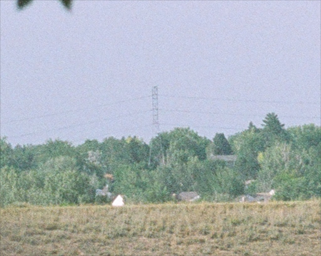

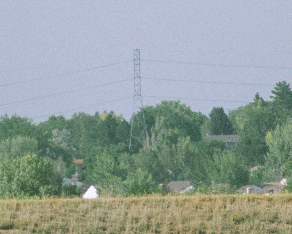

Infinity is fine:
Here is a crop from a larger image. Power lines are sharp. When I back off the focus a little to make the split image line up, it's slightly less focused.

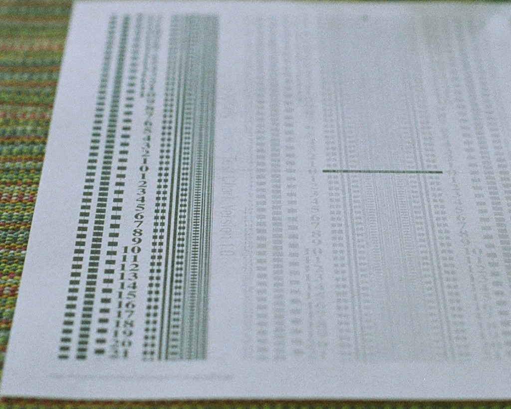

Focusing with the ground glass area seems fine. This is from a zoom lens without using the split prism:

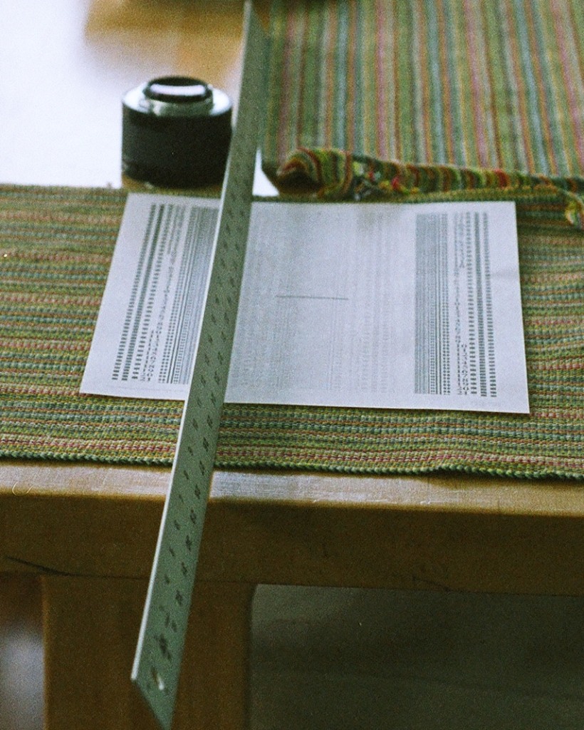

Reproducing a similar distance for the first image I showed gives significant front focus. This is also a crop from a bigger image, but focus is actually off the paper right about at the close edge of the placemat:
Here's a shot using a TC-201 with the 50mm Series E, also cropped, focused with the split prism on the black bar, focus is about on the near 6:
